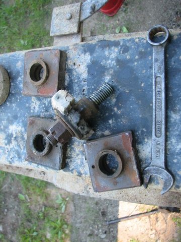

My lower square rubberized washers are ok but the top rubber is dried up and falling apart, I would've thought they would be needed as other rubber parts on a restore but I can't seem to locate any, a part number would be greatly appreciated.
Thanks in advance.

The round ones are B9TT-6039-A. Dennis Carpenter lists it as a front motor mount but same thing I believe.
https://www.dennis-carpenter.com/en/...nt-motor-mount

4) B9TT-6039-A .. T/C Rubber Insulator & 144/170/223/262 Front Engine Mount Rubber Insulator / Obsolete
T/C: 1959/65 F100 4WD; 1959/77 F250 4WD (High Boys) // Engine: 1957/64 F100/600 & P100/500.
CARPENTER NOS OBSOLETE PARTS in Concord NC has 227 = 800-476-9653 (these are probably repro's).
See 6039 in pic:
