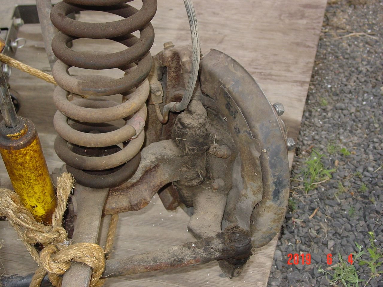

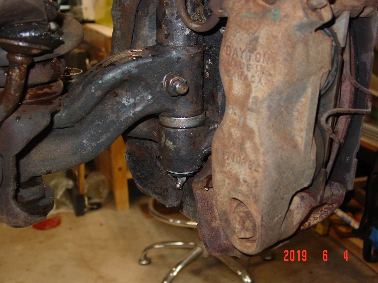

I've finally got moving on replacing the drum brakes on the front of my 69 F250 CS.I power washed the new set-up(which can from a 79 F250).
I have Everything (except the wheels) still in one piece.
Shouldn't be rusty under there. D.S. before washing.
Pass side before washing.
D.S. After wash.
P.S. after wash.
Touchable tie rods
Up close you can see some grime is still there. Wire wheel will take care of this next.

I have new hoses and piston repair kits coming. I'll do the wheel bearings after I get this installed. I started cleaning the suspension that is in the 69, but it got too dark to see what I was doing this evening. Plus I needed to have something to work on tomorrow.

I recommend at least checking the king pins for slop before you put it together. Particularly if the donor had power steering.

Thanks for the tip/reminder! I did check the front end for any movement while it was still on the original 79, and everything felt very tight. But that might have been all the old grease and rust-LOL. It did have PS. But yes, I'll check it all over again when I get it on the 69 frame.

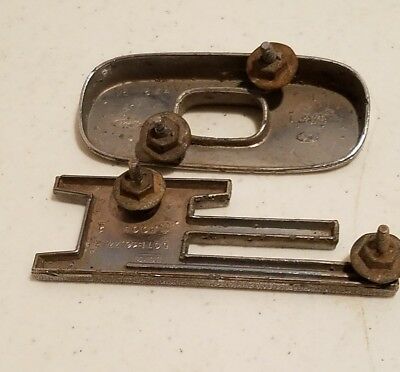

What is the best way to remove the "F" "O" "R" "D" letters from the hood? I don't see any nuts or keepers of any type on the studs. Were they some sort of rivit? I did a search about removing the letters and I found a post from 2003, where someone needed to re-install his letters. They mentioned about the rods and their holders? Any ideas?

the letters had a trim nut that went on from the back. They were stamped steel, and had about a 3/8 nut and a long shank that came out with a thread that cut into the post on the letters.

Wow, Ok I guess that I lost all my nuts off of the letters. But they aren't loose at all. Maybe the PO used some J.B. Weld to keep them in place. I'll try a heat gun, and see what happens. Thanks "Jigs n Fixtures" for the picture.

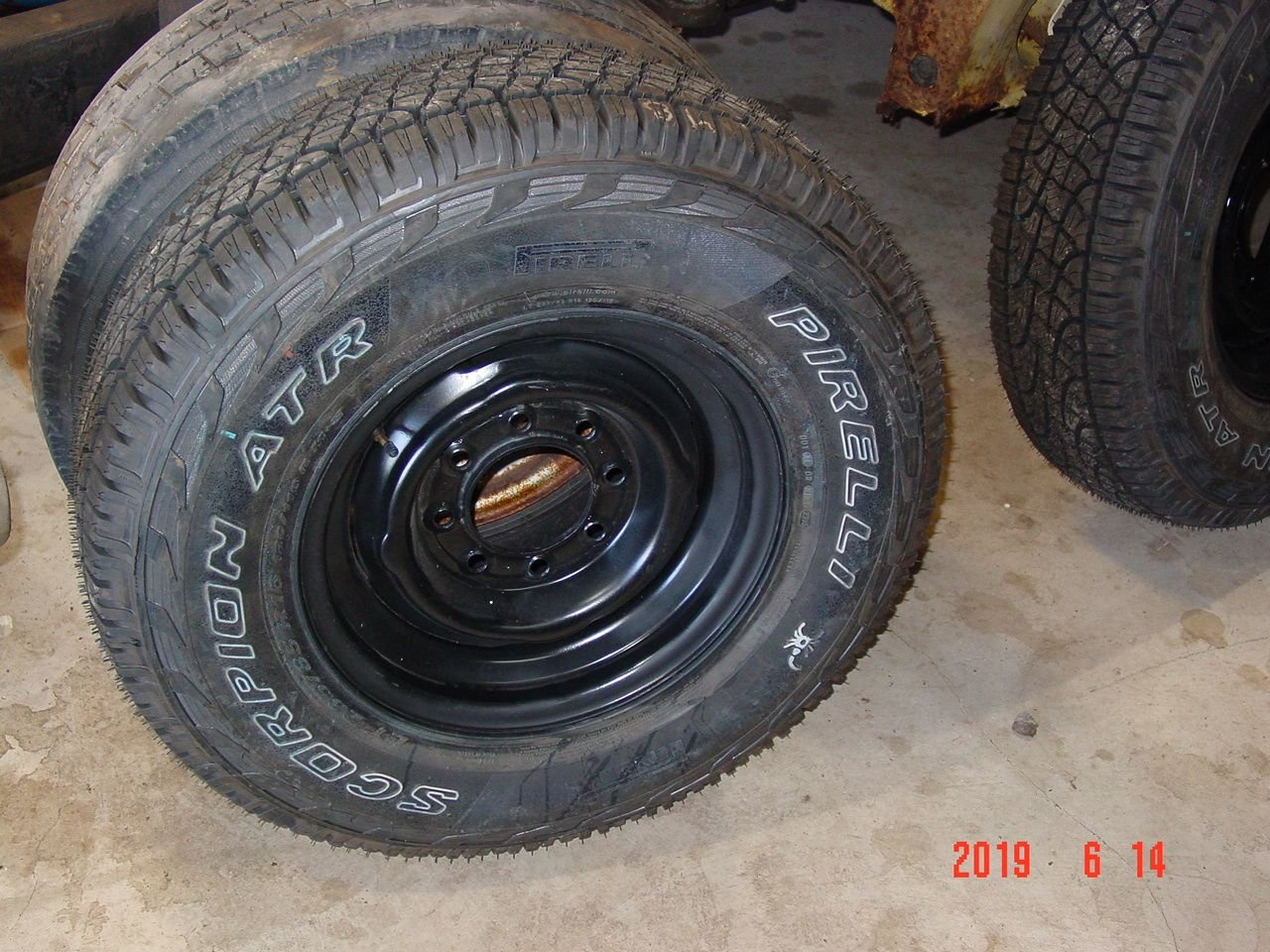

My "Bucket Of Rust" has new shoes! Since I had 2 (steel) rims laying around, I had the new tires mounted, and balanced (I think). I noticed that either of the rims didn't have ANY weights on them when I was taking these pictures. Now I have seen, (and owned) some tires that were built so well that they didn't need any balance weights, but they are rather rare. And two at the same time- seems hard to believe. Any way, I thought it would be a little easier to roll the new suspension under the truck. I plan on installing the new bushings,and rubber brake hoses next.
New shoes at last!
Should make a difference in cornering.
No weights on either side ???
