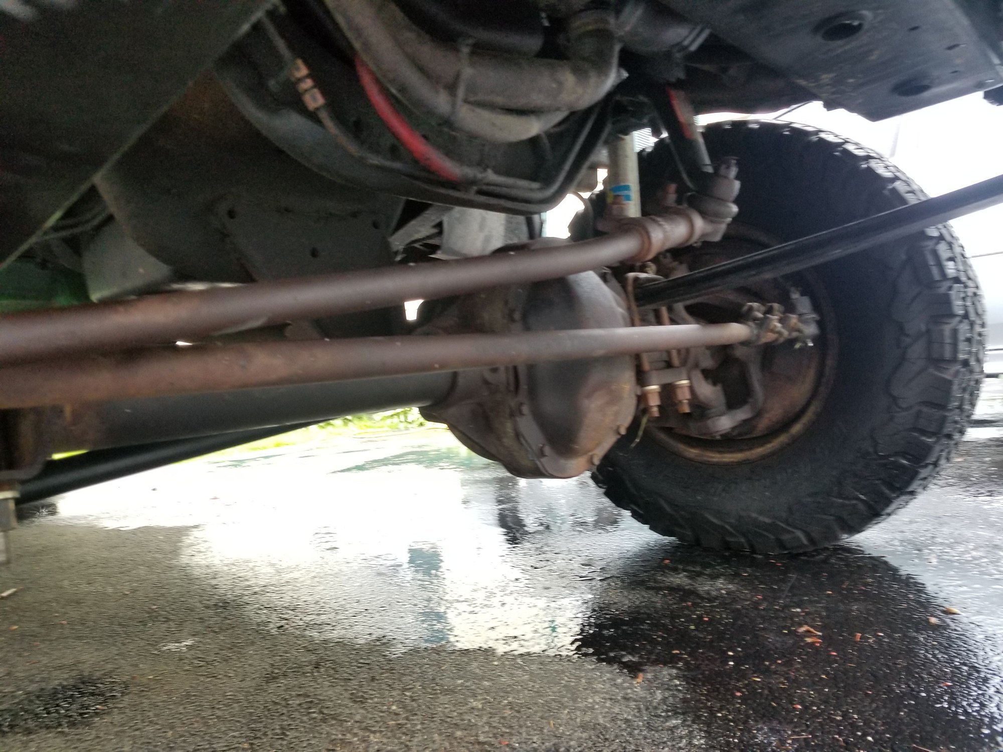

Thanks for the feedback! I will take some pics in a minute, there is deffiantly a dropped Pittman arm from rough country. I have a spare stock style pitman arm, looks like it have 4 evenly spaced key ways, so maybe it possibly to put it on wrong. The truck did have 4 inch lift springs in the front, but I recently did a pmf rsk 2.5inch with super duty springs.

Wheels are fairly straight in the picture, you can see that I am out of adjustment.
Definitely the pitman arm is to far to the left.

With the pitman arm aimed to the right(with tires straight), I'm guessing that is the reason it won't steer right very well. I'm thinking you need drop the drag link, center your steering box and then remove the pitman arm and install it straight ahead. Then adjust the draglink to fit.
Hopefully 1tonbasecamp is correct on the lack of keying on aftermarket pitman arms.

Yes hopefully I'll be able to put the Pitman arm straight. I should probably go back to a stock pitman arm ? I'll have to get a puller also
