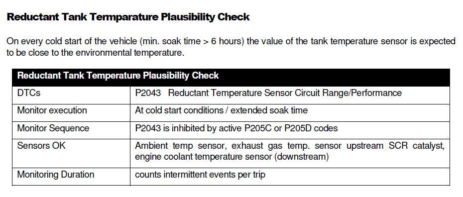

Been able to drive truck without issue over last week or so. Found out that the remote start will not work with the CEL on, so cleared the code but comes back after a drive cycle.
I'm assuming that after I replace the sensor, the fault code will only go away after a number of passed self tests. I believe the test for P2043 is done only after truck is cooled down and not restarted for 6 hours.
I have found some info on reprogramming/re-calibration as a method to fix this fault, but the affected date range is 11/7/2013 through 12/10/2014 and my truck was build before that in 09/2013.
https://ford.oemdtc.com/465/malfunct...d-f-super-duty
Link to VIN lookup tool
Recall Notices| Ford, Lincoln & Mercury Owners | Official Ford Owner Site
Is is possible to monitor this temp sensor's PID with torque? That way I can see how far off the value really is compared to real ambient temp and sensor in the grill.

It's not the heater, but the temperature sensor that is part of the same assembly as the heater.
I have not fixed mine yet. Sometimes CEL comes back on, sometimes not. Perhaps due to really hot weather here since the code is set due to difference between 2 temp sensors and each has it's own temperature related error (gain/offset).
