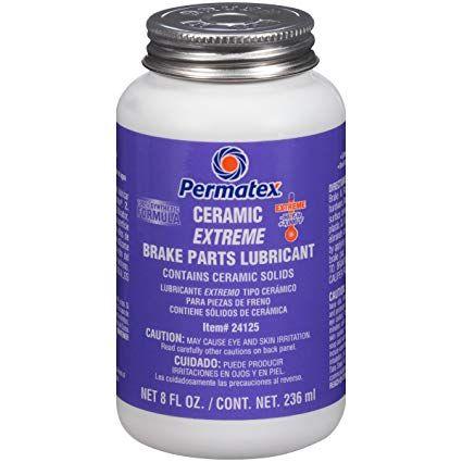

This is all I use. Works really well.
DITTO !!!!

Originally Posted by Tim Hodgson
DITTO !!!!
DITTO DITTO!
Using the Permatex, I haven't had a stuck slide pin on any of about 12 vehicles between me, my wife, and my kids vehicles in the past 13 years.

Originally Posted by F250_
DITTO DITTO!
TRIPLE DITTO!
Wear gloves when applying this stuff though. Only time or a sandblaster (I'm exaggerating of course) gets it off your fingers.

X3 on the Permatex.
The key question is... How does the lubricant handle high temperatures, without becoming a solid.

Solid lubricants are designed to operate as solids... think powdered molybdenum, graphite, teflon, etc. The Permatex, in this case, uses ceramic solids.
