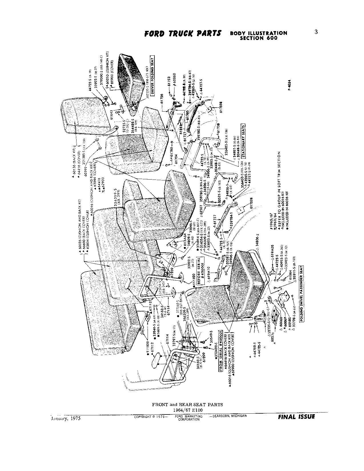

Yeah it seems these go very fast. Thank you for the reply and ill try big m! Also that schematic is a huge help as well. Thanks again.

You need a narrow seat with a short bottom. Many sports car seats, like Fiero, Miata seats work. Measure the width from passenger door to dog house for your seat max width. That side is narrower than the driver side.
for the original Econoline seats, the 1961-1964 seats and brackets are different from the 1965-1967 seats. If you have both seat and bracket, it should work in any year. The 1965-1967 seats sat lower because they rotated the steering column to bring the steering wheel a little lower.
