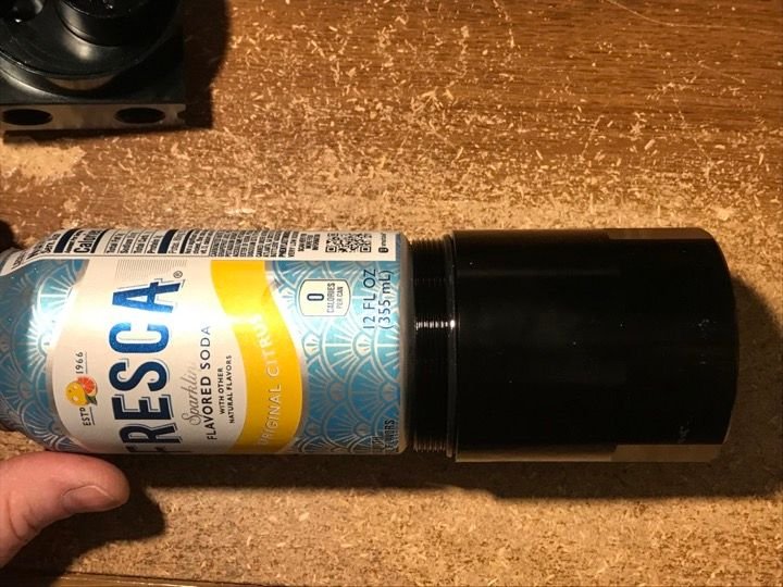

So who is ready to laugh there @ off?
It got here today and if you dod the Amazon and use the free two day shipping they
also signed you up for prime and will be charging you for it after the free trial expires.
Anyway the reason for laughing your @ off is the size of this catch can thing.
That grill is on the inlet side of the top and the out is open to the port. I think to get the capacity you would need two or three of them .
EDIT : I forgot to say is not a bad assembly. Just need more than one for the 6.0L

Everything’s smaller in China...

Nice to see China is into recycling. Very good use of a Busch can.
