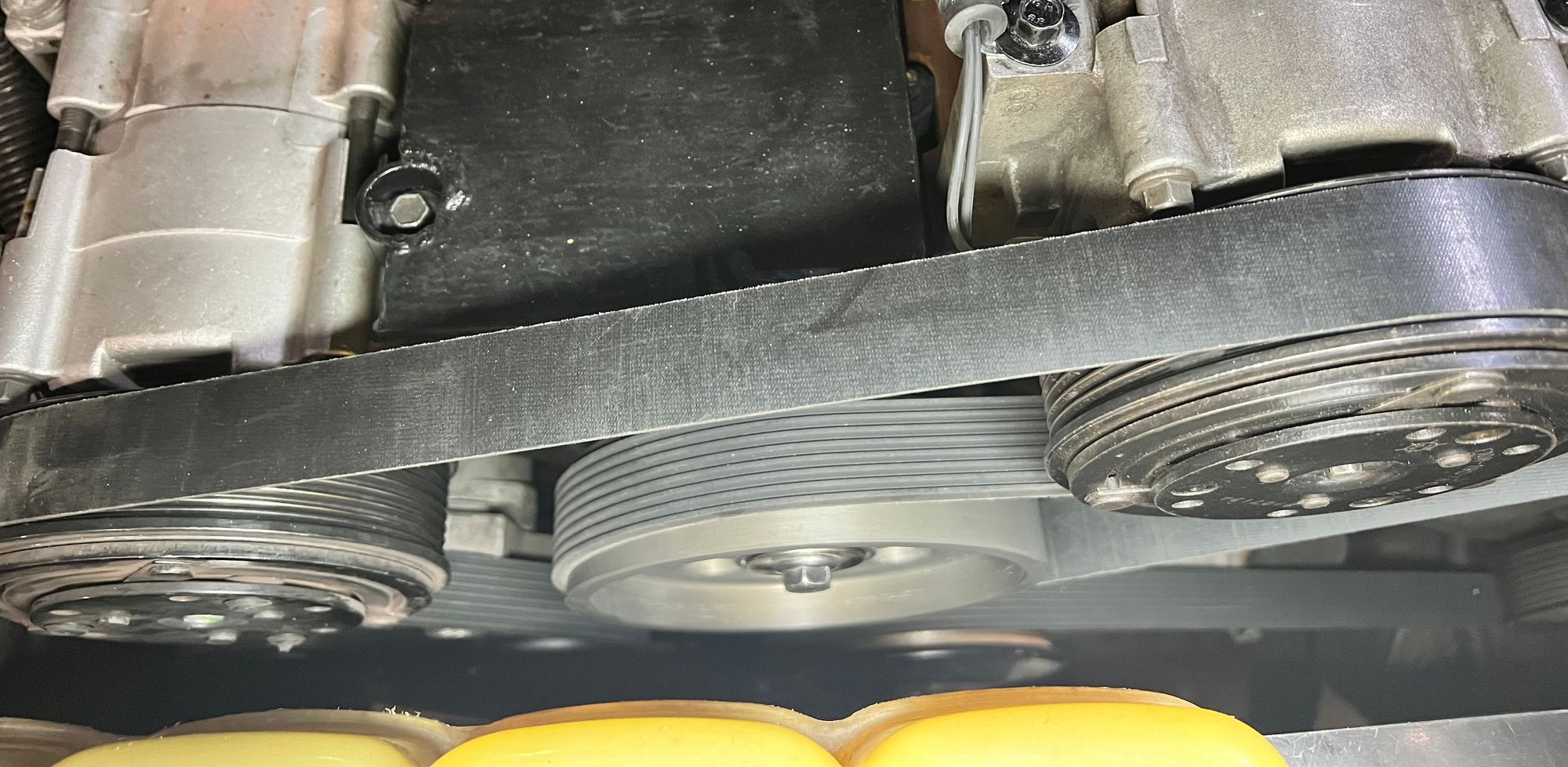

The bearing has been installed in the pulley. Retaining compound was not used on Dan's advice. Pulley was baked at 200ºF and the bearing was frozen for an hour.

That is a piece of art in my opinion.
@Dan V , your skills are top notch sir!

I get lucky now and again.

Closeup of the bearing installed in the custom idler pulley.
Belt tension with the longer belt and custom idler pulley is perfect.
The system works.
