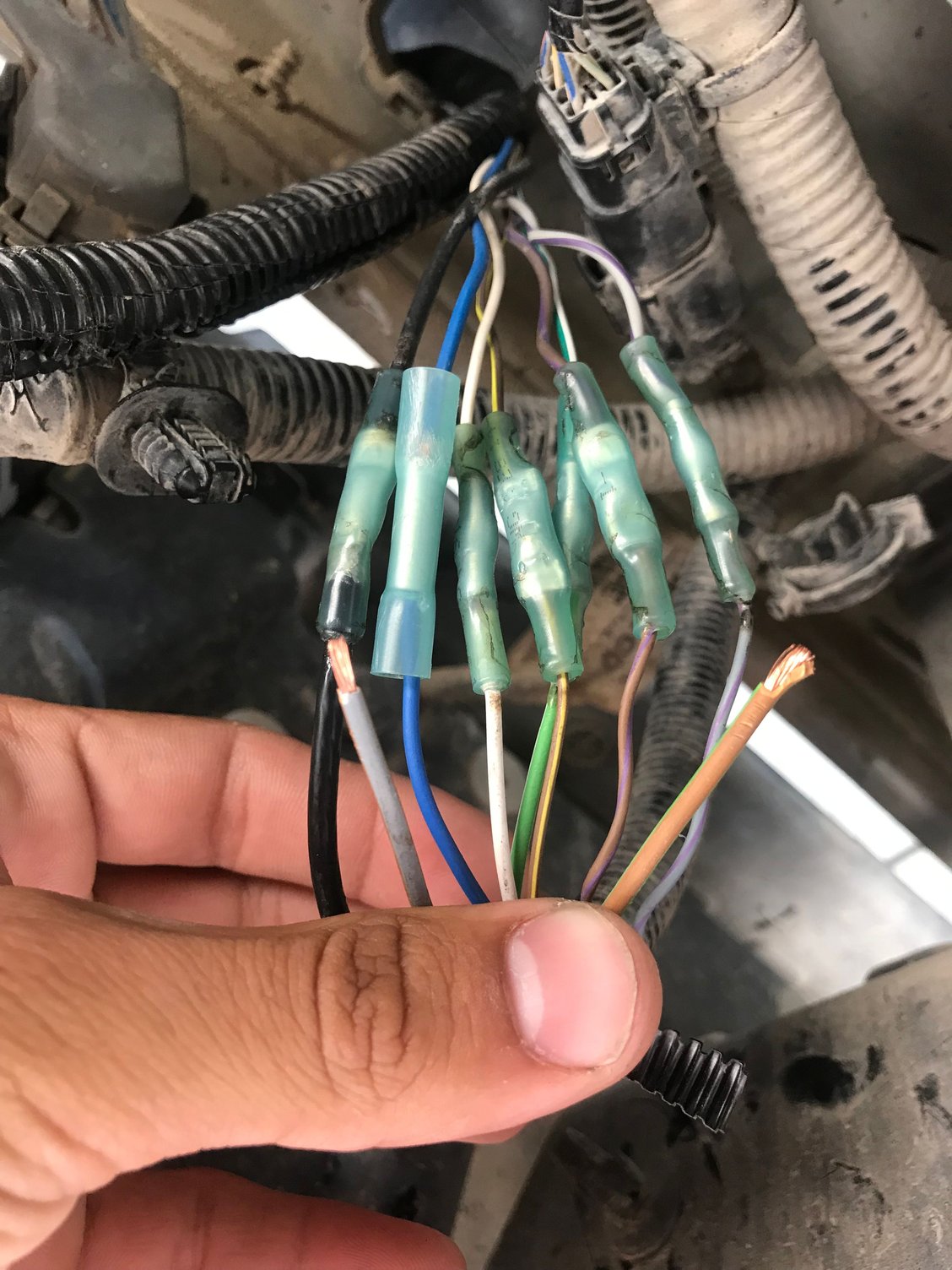

guys the cable 1000 dollar cable does not have to be replaces. i just need to connect two wires that i don't know know connect too. just need somebody with the 360 camera system to check and let me know.

it is the
brown / green stripe
And
Gray / brown stripe
check the tail gate hardness by the spare tire.
360 camera trucks

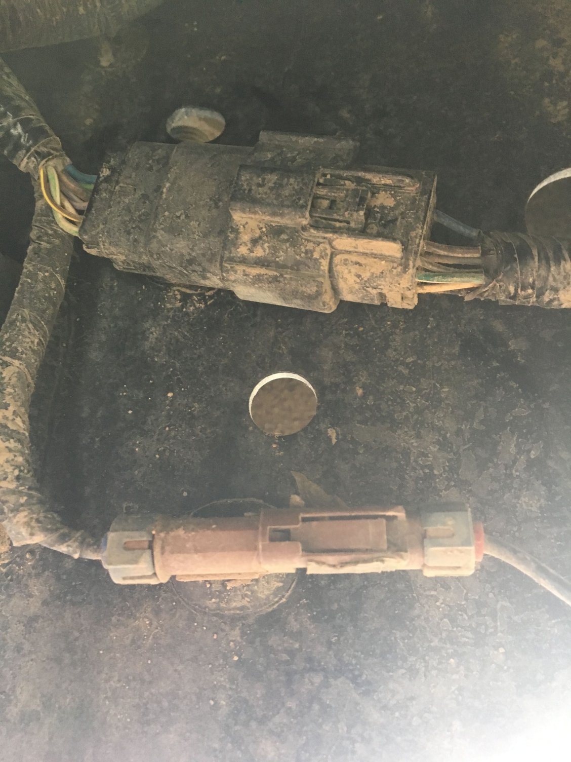

7 cables coming from the tail gate . 9 cables on the other half look at pictures

these are the two wire harnesses that go to the tailgate. Wires heading left on the picture go to the tailgate and wires heading right go into the frame. Left side of the picture would be the rear of the truck.
The bottom wire is the one for the camera and Ys in with all the other cables going into the frame (right side) and Ys into the all the other wires going to the tailgate.
There are more cable cable going to the tailgate from the harness than are coming into the harness from the frame routing.
It it looks like the thief’s cut out the 2 wire harnesses. Hope this helps. Not sure where the extra wires go but there’s a bypass obviously in that harness.

Looks more like Vandalism than a theft attempt, they cut out the connector in a way that may not have left them much wire to connect to. Or someone is updating the tailgate to one that has a camera and need the connector for some reason. Your probably going to need to buy the harnesses due to the cut coax connection. And the twisted pair is, I believe, A network cable.

At $993,00, maybe all the thief was after was the wire harness connector?
A Ford wiring diagram and service manual will likely offer the most authoritative information.

thanks for the photo im going to take another harder look at it.

2 wires left tail gate opens closes. led works. no back up camera
