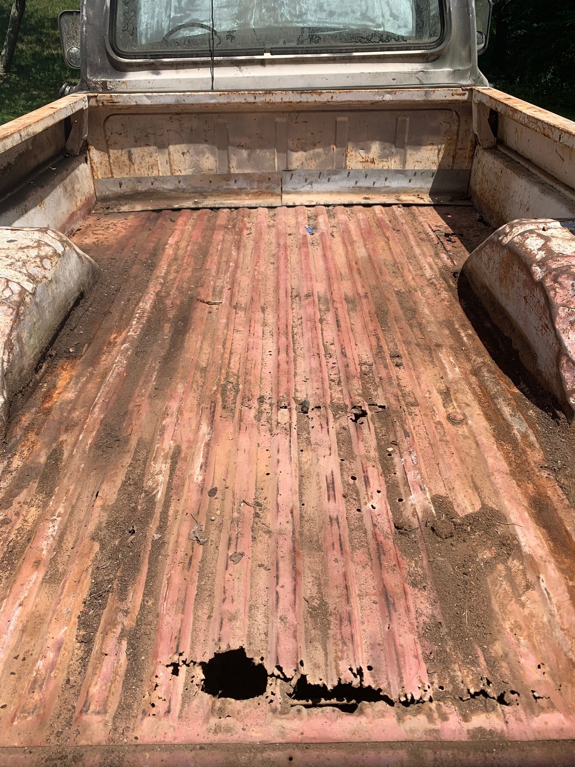

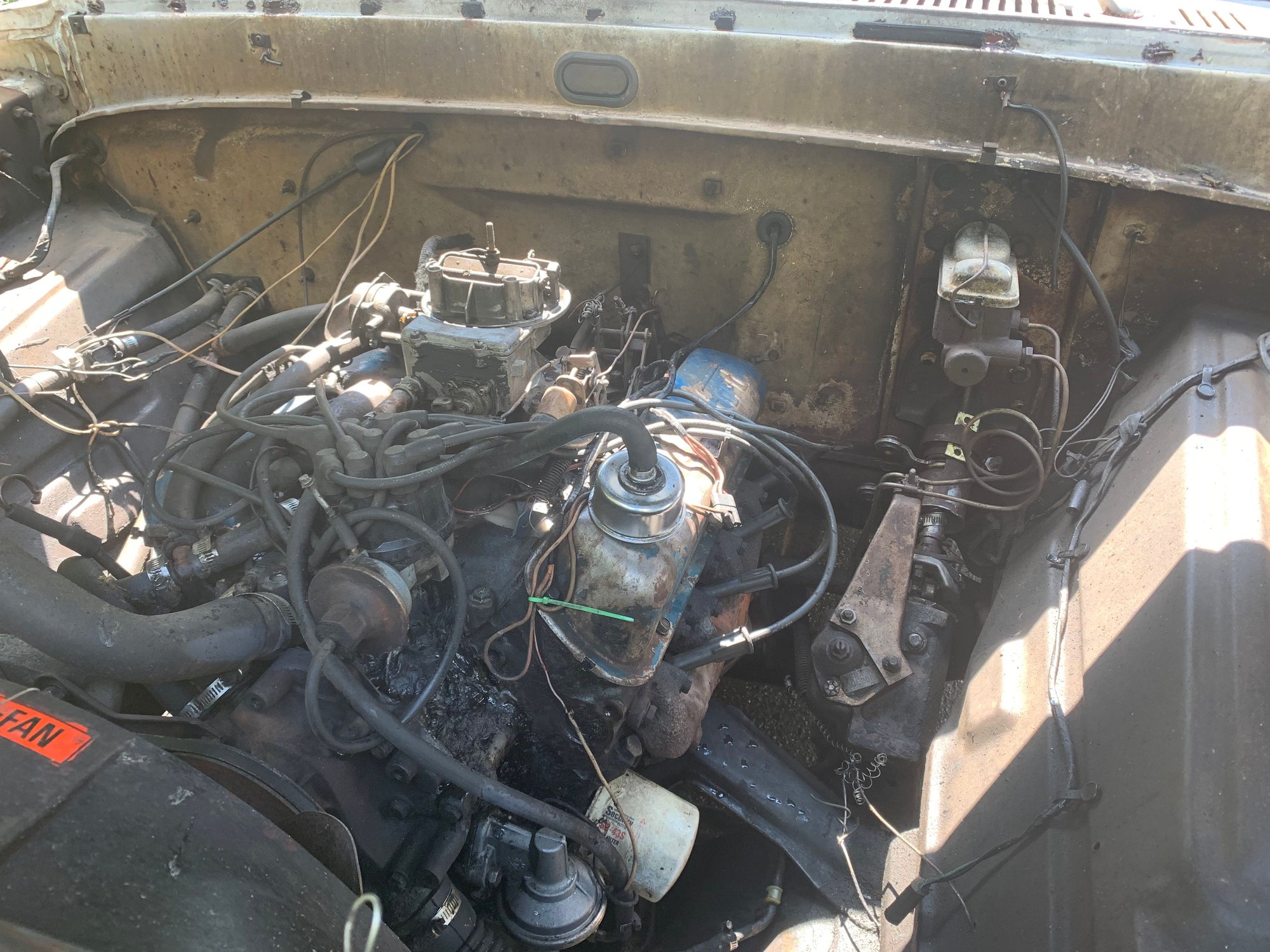

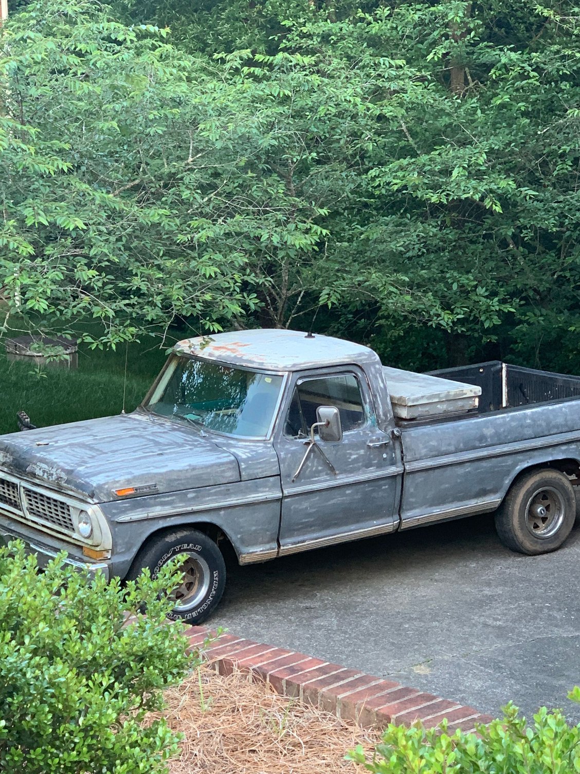

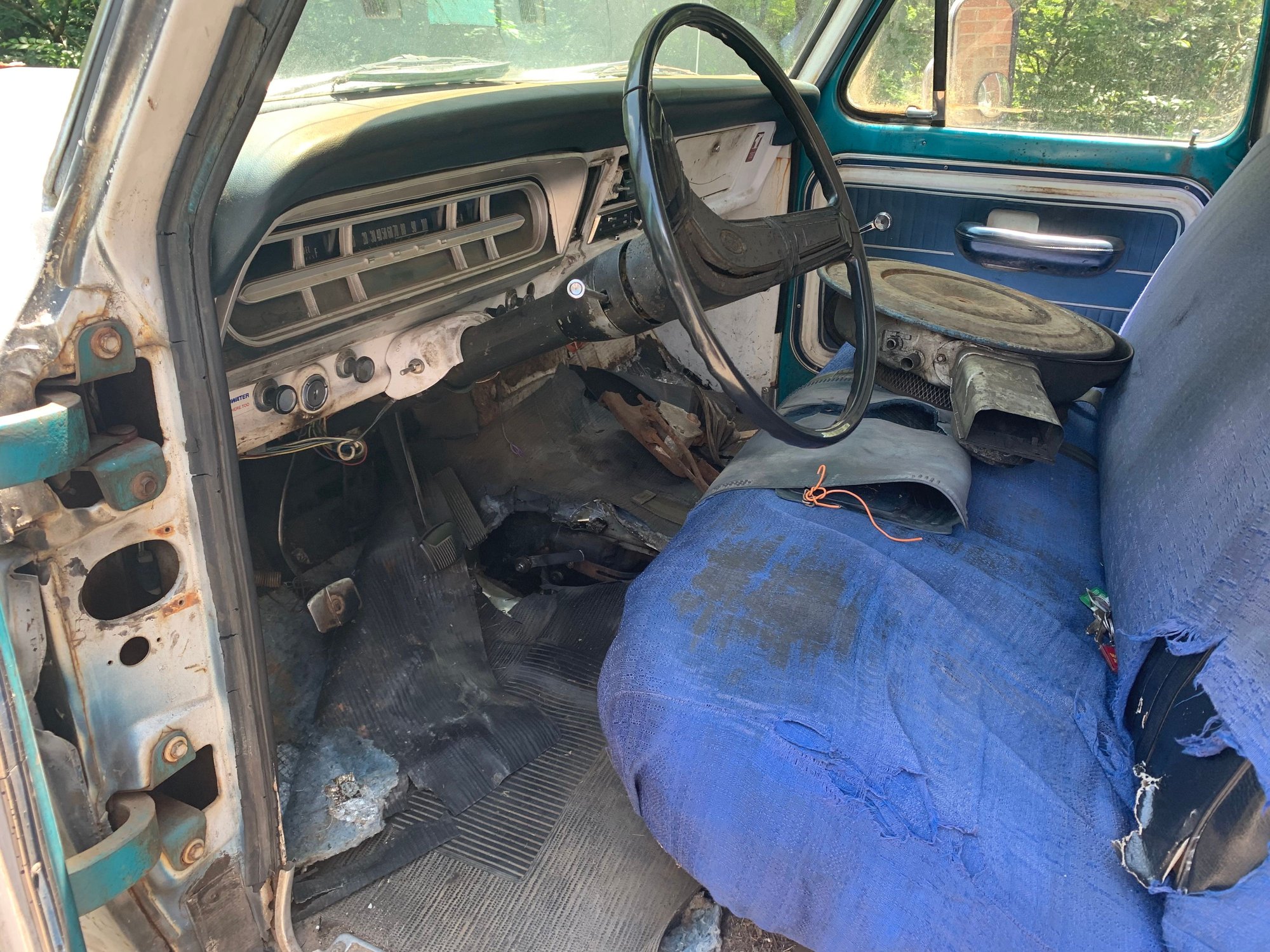

This is is my ‘70 F100. 302, (no clue what the trans is, someone cut a hole through the floor pan and did something weird). I’d saying for being almost 50 years old, it’s not in terrible shape. At least it runs and drives. I want to do a frame off resto at my house. I’ve seen the forums, the YouTube videos etc. Honestly I’m just not sure where to start. Any suggestions, tips, info would be appreciated.
Came me from Norfolk VA, ordered to Charlotte, NC. I picked it up in South Carolina for a thousand dollars. It is a style side, long wheel base, has a clutch (assuming it had an original three speed). Cab mounts are gone, bed rails are shot and sitting on wood. Frames in great condition. Original seats in it. Grille is shot. At least the wiper motor still works. Can provide more pics. Thanks everyone.

I think you have a very good platform to start with for a restoration project. It appears to be straight and at least from the photos, I don't see the usual rot on the cab corner.
On my 70' I did find one bit of frame rot on the cross member under the engine that is in need of a patch weld but I suppose that isn't so bad. The rest of it was fairly rot free just a bunch of dents on the fenders and hood. Yours is definitely in better condition than mine. I'll be watching for your updates and I hope you have a trouble-free project.

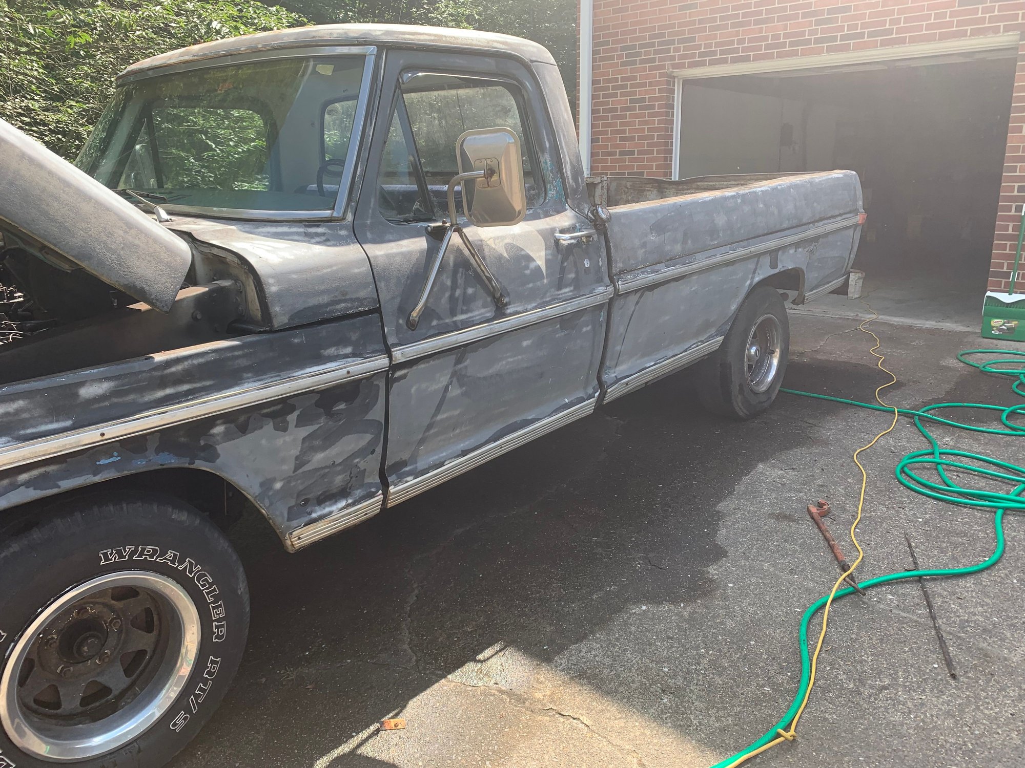

Thanks allot. Fortunately for me the engine and trans leaked so much it put a protective coating all over the frame! Duracoat!!!

Gave her a bath
