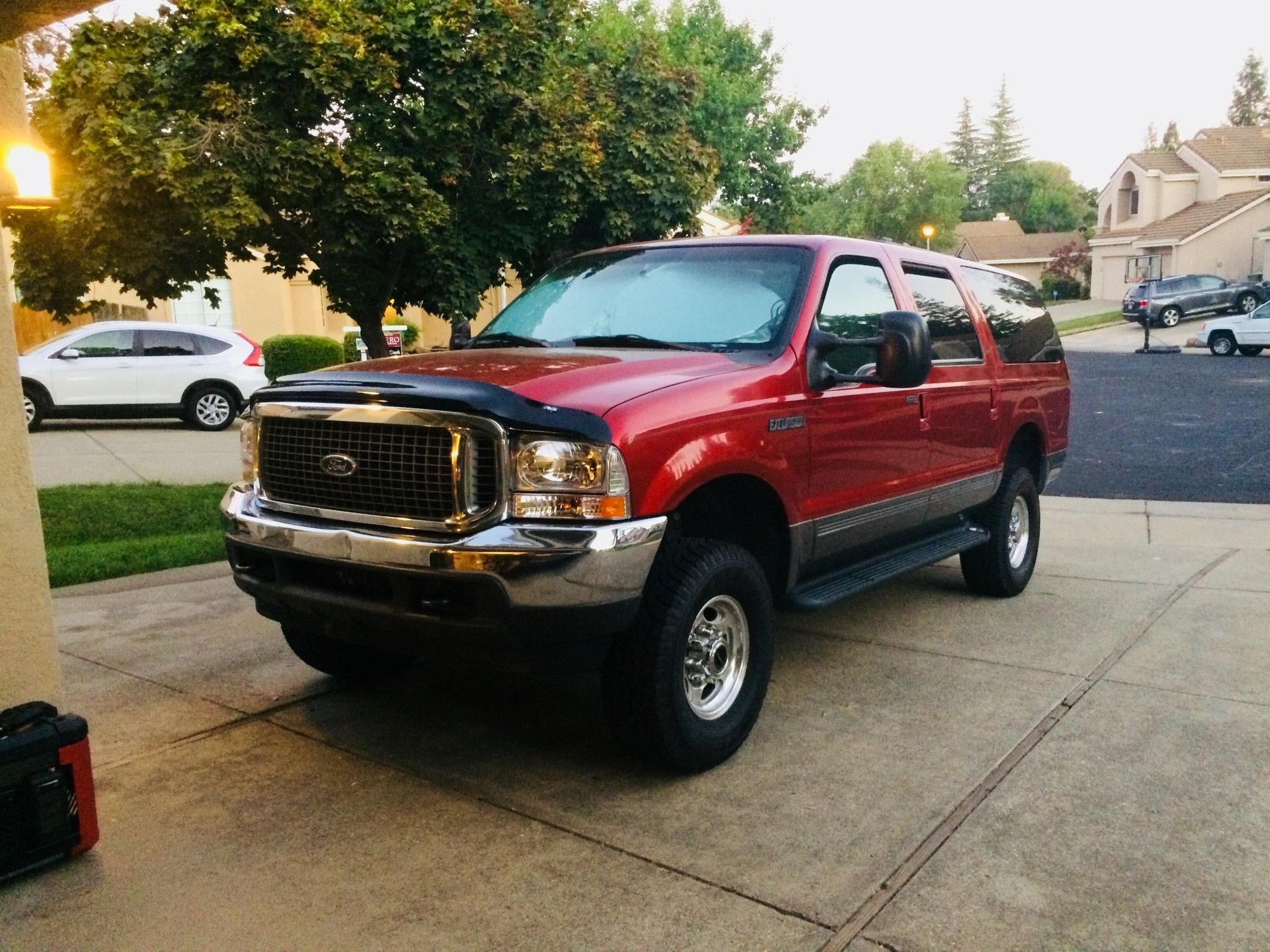

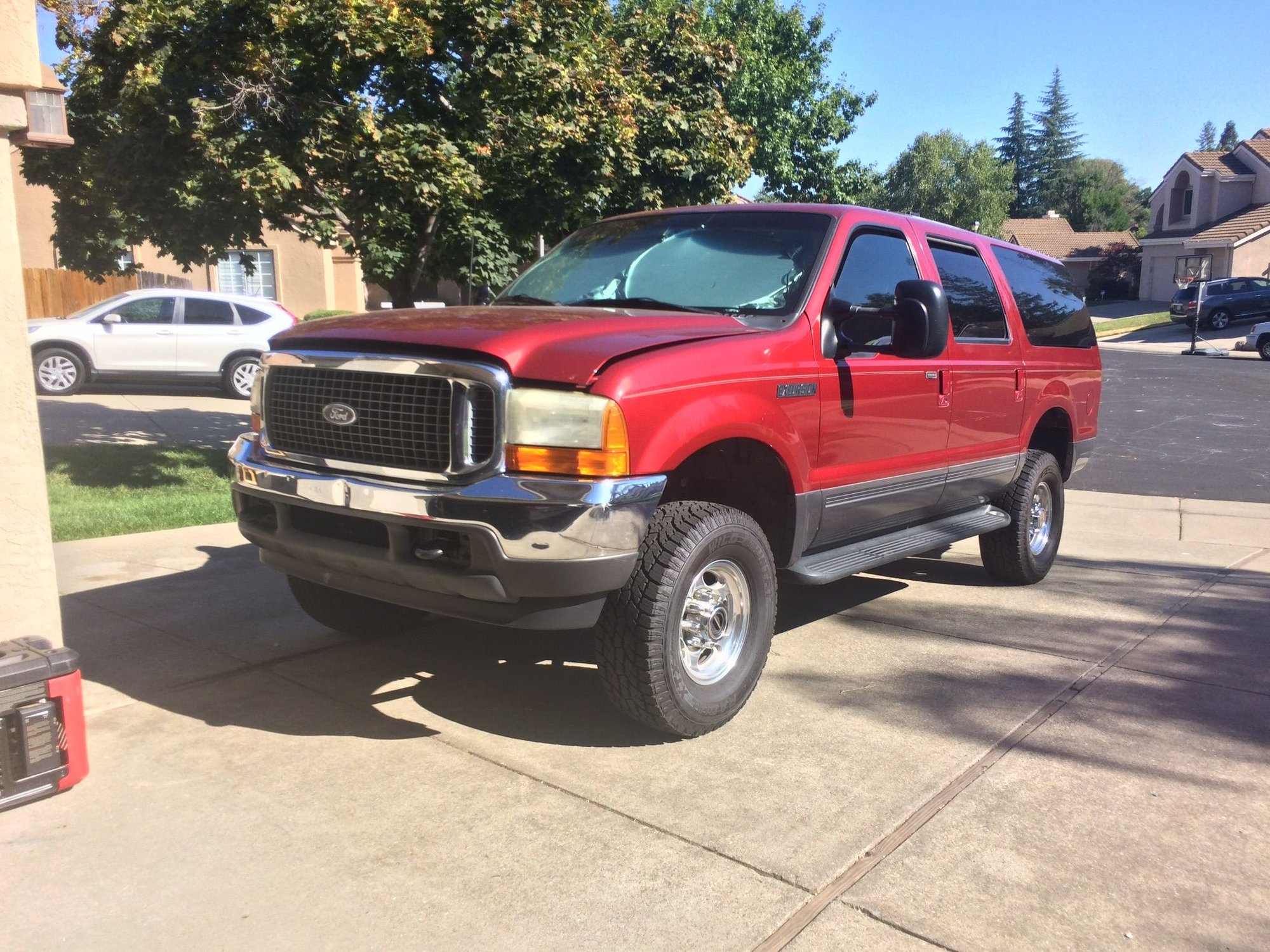

The OEMs on my 2003 started to haze and I didn't really care for the projection styles I found for the EX, so I chose the original OEM with 6 LED daytime running lights. I also upgrade the blub to the HYB 9007 Ultra High-Performance Halogen 6000K 80watt. Bumper lights were changed out in 2003 and are just starting to haze.
Pic during install
