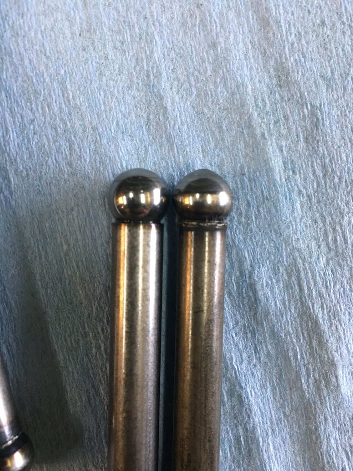

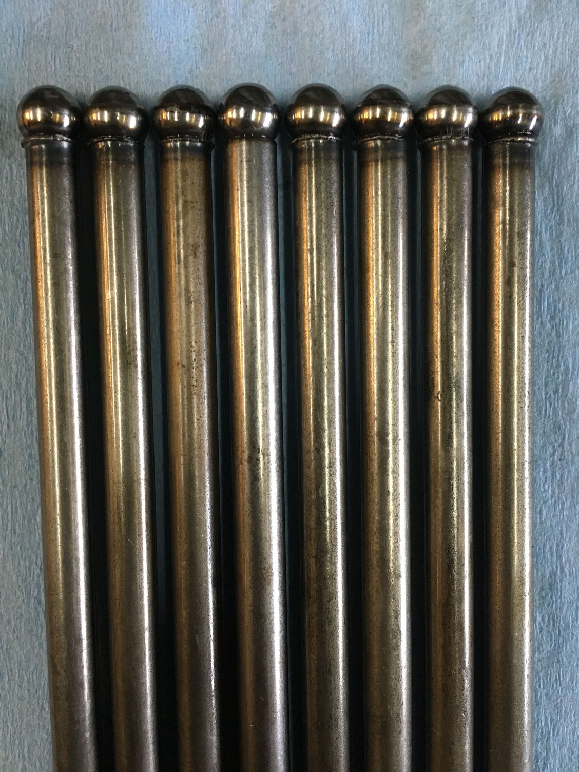

I’m working on the truck again tonight. Here is what I’ve found so far. I double checked that the rocker rocker shaft bolts were all in the right place and I double checked that the rocker shafts are clear of sludge. Both of those were fine. But I did find a few possible problems. The pushrod tubes apear to be mushroomed out where the ends are pressed in and some of the ends themselves seem worn almost pointed like an egg. The rockers also seem to have quite a bit of wear on the tips and a little bit of play on the shaft.
I pulled one of the lifters to check it out and it seems fine but the internal plunger has a bit of side to side play(normal?). While running the engine with the valve covers off I noticed the noise seems to be coming from down by the lifters themselves. I’m stumped as to where the noise is coming from and what is causing it.
The wear on the rocker tips
“Egg shaped” pushrod end vs a round one
Most of the tubes apear mushroomed or flares where the ends are pressed in. Is this normal?

Some wear for sure, probably made worse by oil starvation.
there really is no proper push rod length predetermined for any used or rebuilt engine. you have to measure for proper preload and check the geometry . wear, decking, head shaving , stem height ,cam base all make a difference.
If you don't want to spend the money for adjustable rockers a set of custom pushrods is the next option. but honestly until you get your oil pressure up and replace your worn valve train parts that would pretty much be throwing money away.
