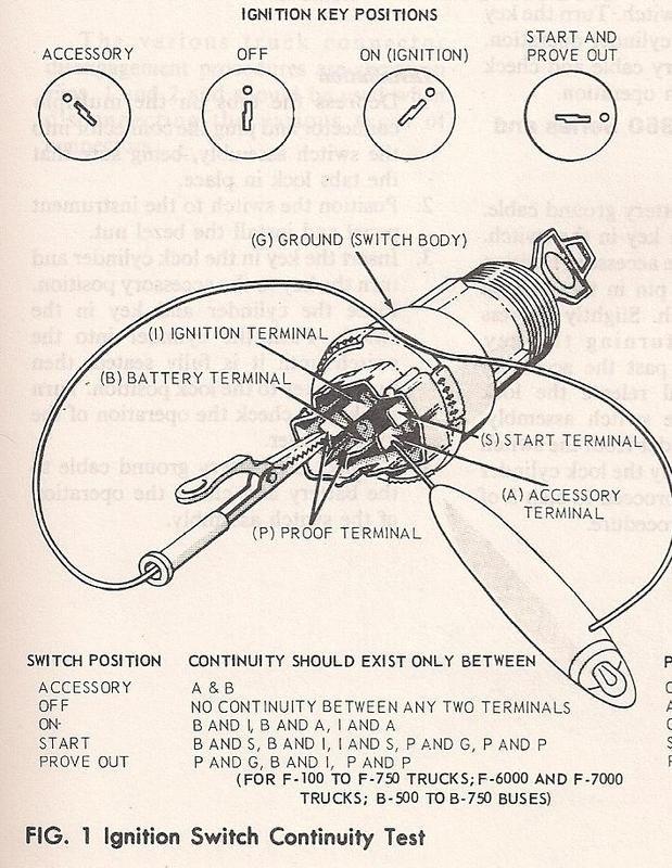

Another question. I need the diagram for my ignition switch wires so I can install a switch panel. I forgot who asked me why it was sitting. Um the old owner said it had 3 owners. First owner died after 3 days of selling it. Second owner(her dad) die 4 months after she bought it. She lost the keys to her Miata which also had the truck's key and has been setting seen 2017. So in other words I'm going to die after I sell it (which I'm not. I'm going to the military and taking my truck with me).

Why not just get a new set of ignition tumblers and a key and put it back to normal? Getting that key cut to match the door locks is not that hard. Or just go to a JY and get a ignition/key and matching door locks? You might even get a locking glove box lock.

Well if you are that impatient, I feel that I need to tell you the Army is really going to wear on you ALOT then. You have to be very patient with that way of life, it is very hurry up and wait. And wait and wait. How do I know that, because I did it every day for 20 years and 29 days. The diagram I sent you should get you up and running in no time.
