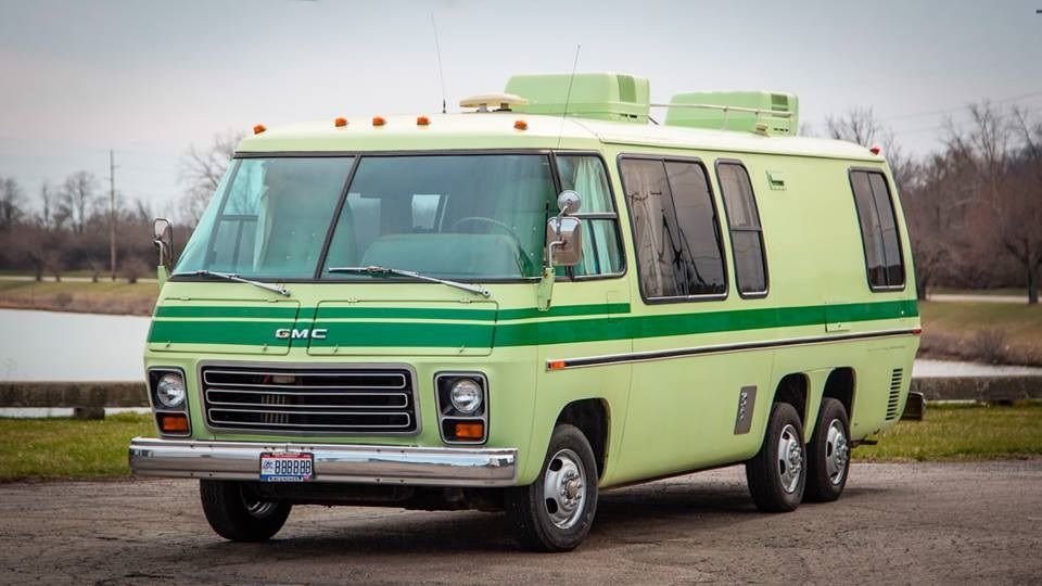

I agree: Front differential doesn't need extra cooling unless you're doing something really strenuous and weird, and then you take a chance of anything that comes along cracking it open (instead of just denting the OE cover). The only vehicle I've ever seen that is a good candidate for front-differential cooling is the GMC Motorhome:
