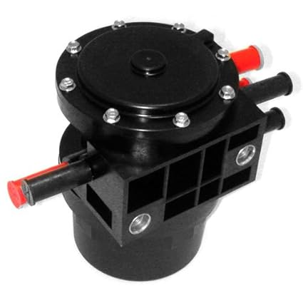

One thing you didn't change was the fuel switching valve. Pressure from the fuel pump pushes the spool in the valve so the engine is running on the selected tank, and the fuel returns to the selected tank. Some of them also have a large fuel filter in the bottom of them. They look like this and are called a "Ford fuel reservoir"

All right, I took the fuel reservoir off and took it apart, cleaned it out and re-installed. I now have 37 lb of pressure at the rail thanks to your help. I had someone that knew what they were doing set the timing and straighten out some crossed wires that the guy I bought it from had arranged in the order that he thought best, ( I would still be trying to figure that out) so, she now runs but I need to replace the injectors. So many on the internet. Can you guys give me a suggestion on injectors.
