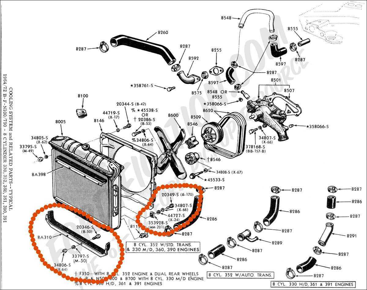

From the drawing are any of the parts shown in the red circles rubber/vibration isolators? If so, where to buy?
Still have the fan shroud & 4 clips the radiator bolts onto but nothing else.
Original radiator is gone. Replacing with a 3 core Champion aluminum.
Dan

None of the circled parts are rubber except 8A310...that is not available.
20349-S78 is a 3/8" -24 x 3/4" long bolt // 34807-S8 is a 3/8" lock washer // 44727-S8 is a 3/8" flat washer.
8A310 is not listed in the truck parts catalog for 1967/72 F100/350.
