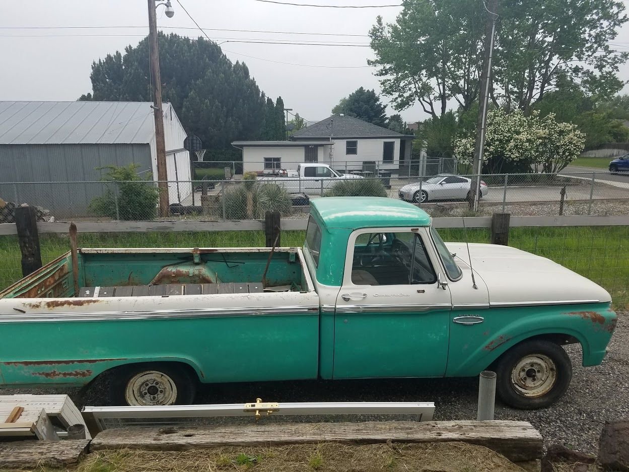

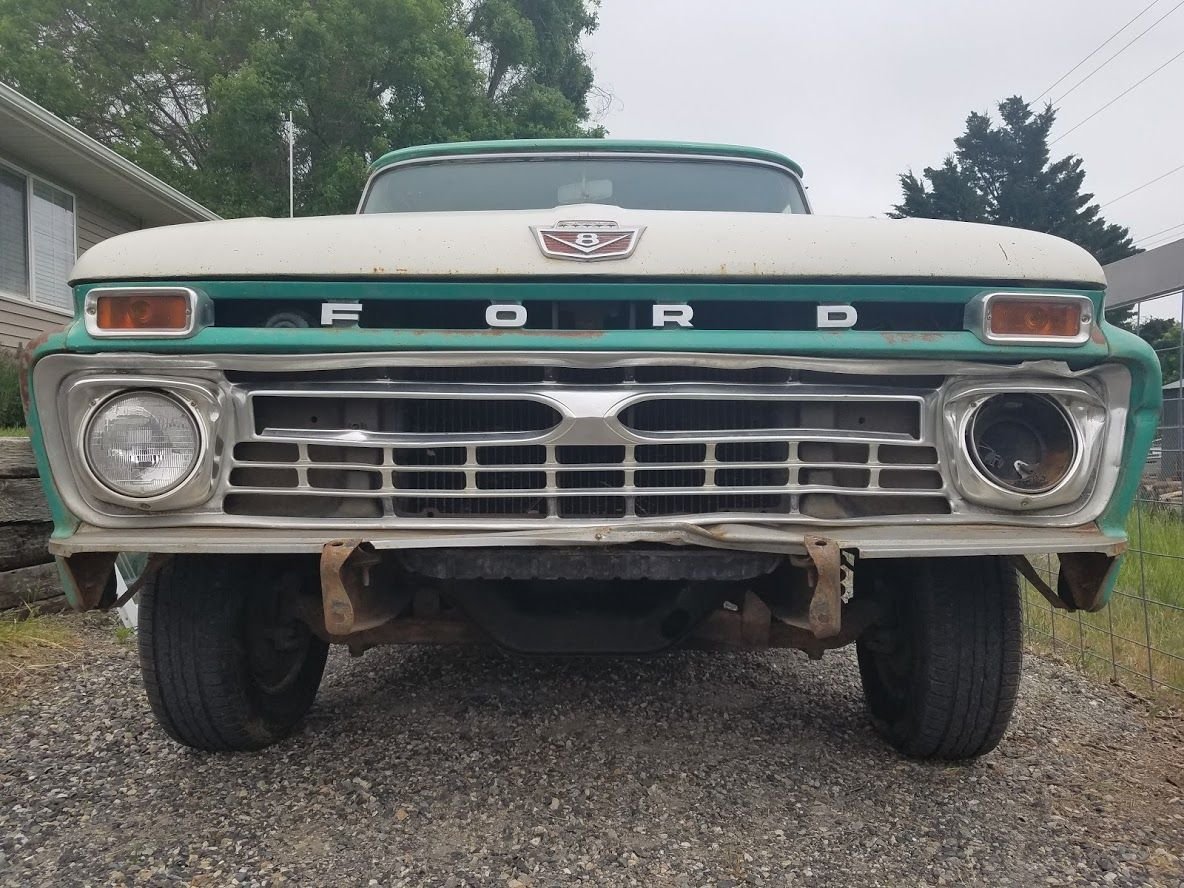

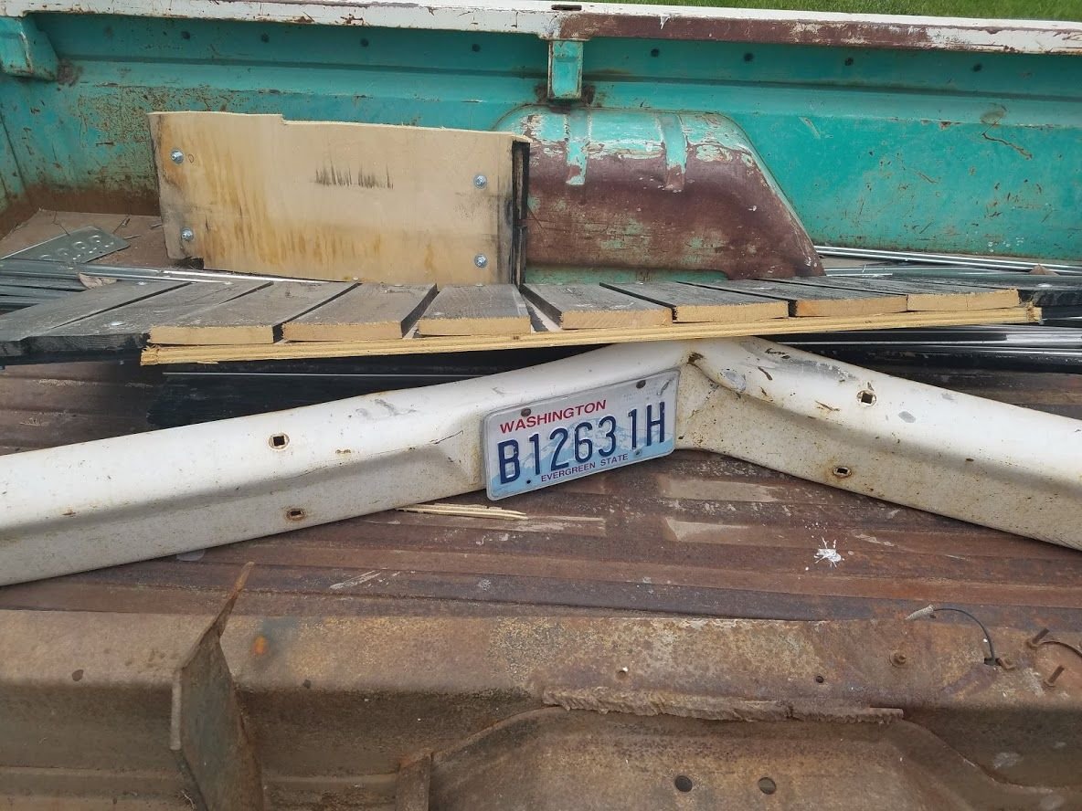

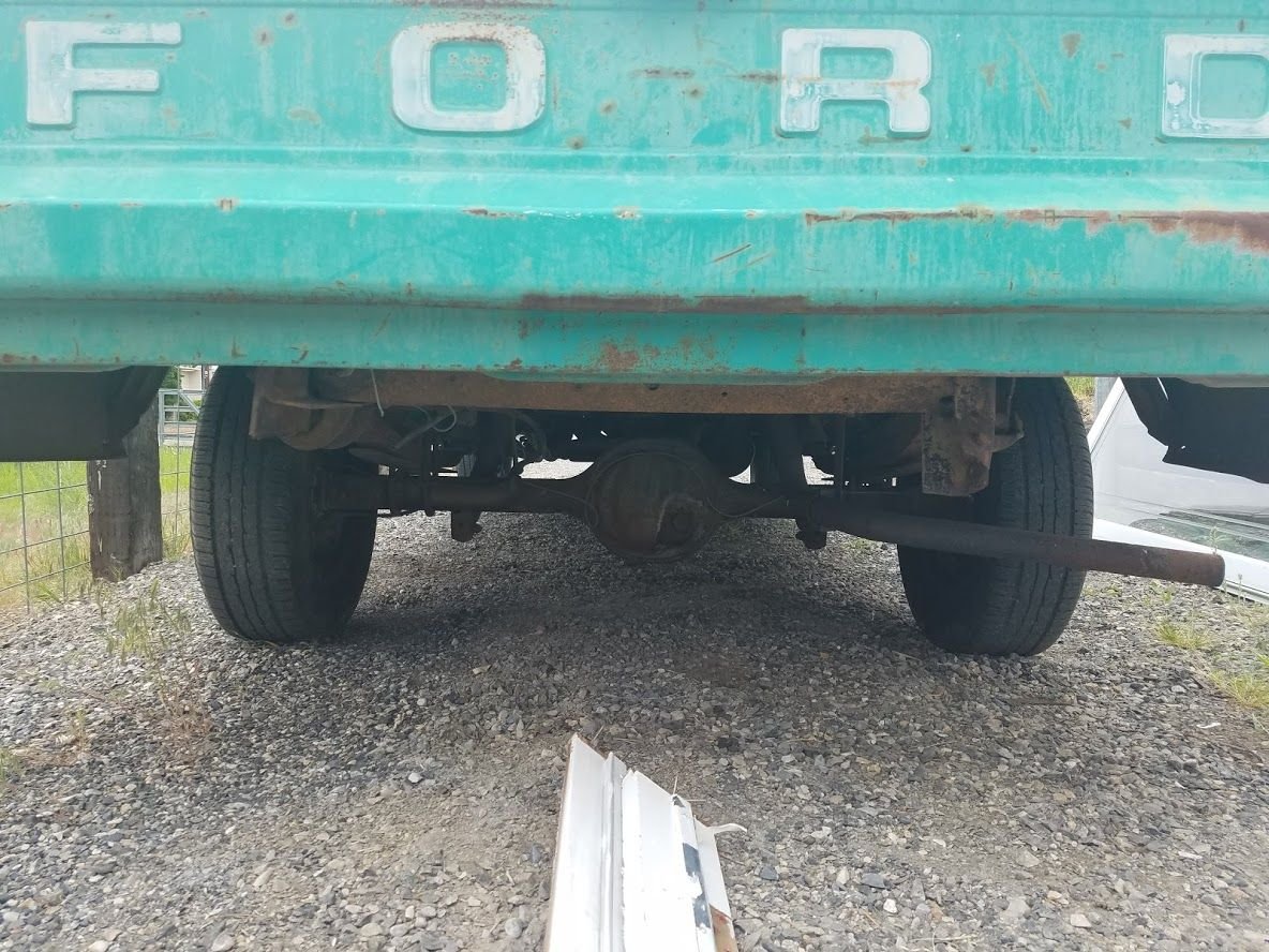

Runs and drives but needs the front end fixed. Grill, bumper etc. Not sure why they cut the rear bumper off like that.

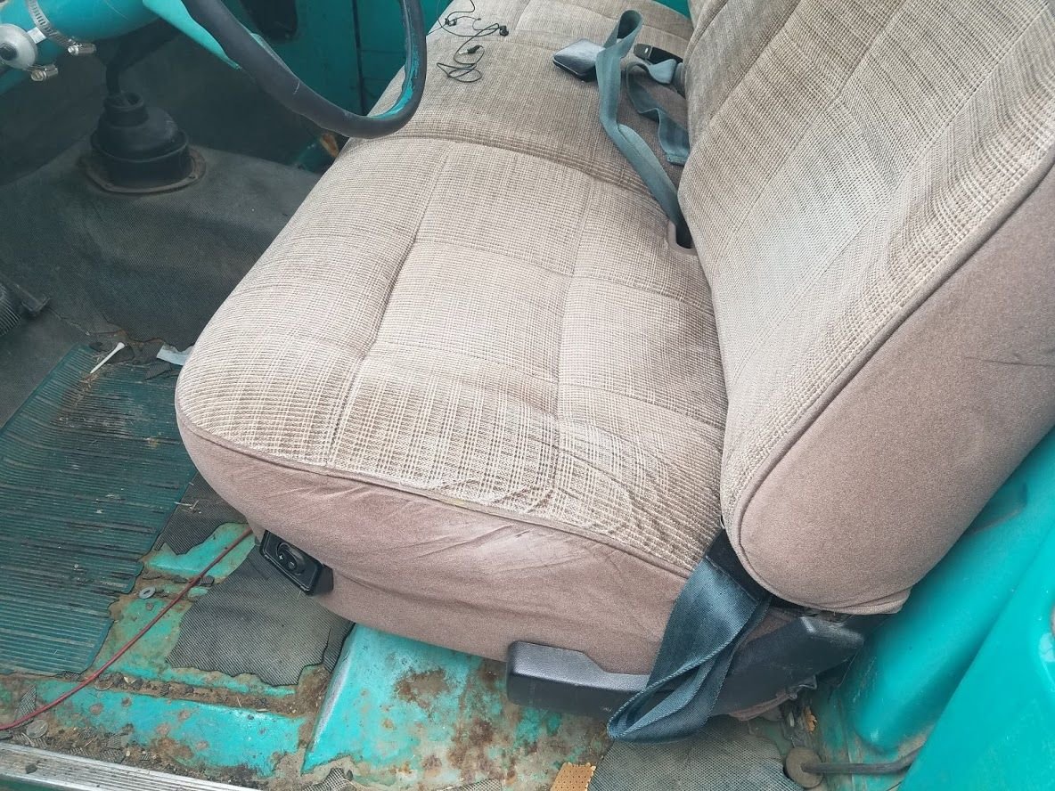

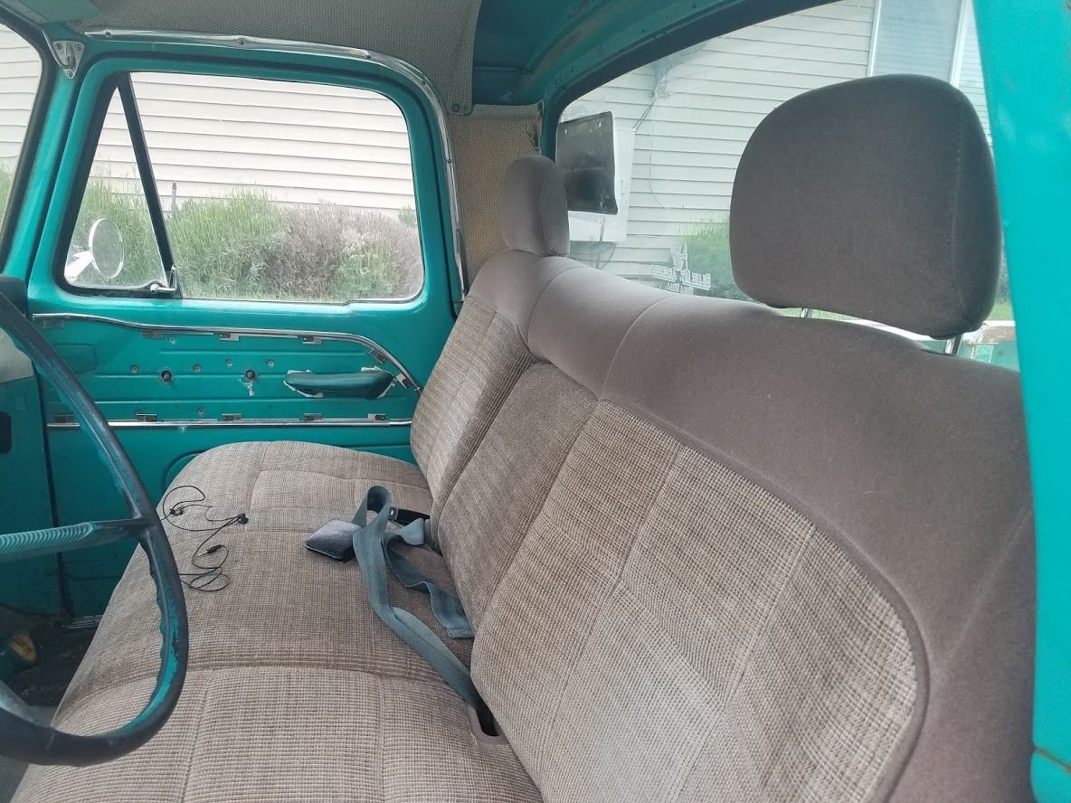

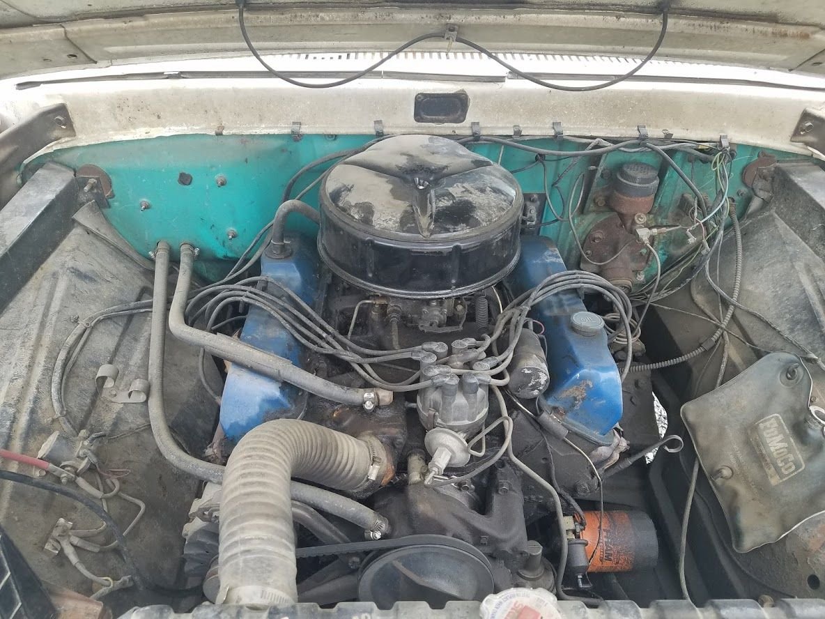

This one looks like a keeper.
Except for the seat and antenna, looks fairly original too.

Thanks. I agree on both - seat and antenna.
I'd also love to fix that front end and those bumpers.
Not sure if it's doable. It was hit pretty good.

That's a very nice looking truck... of course it looks a lot like mine! I think you'll enjoy this one a lot more than your old '63.

I was thinking it looks a lot like mine.
All looks repairable from the photos. Hardest part being the left bumper mount. Unless there's something we can't see.

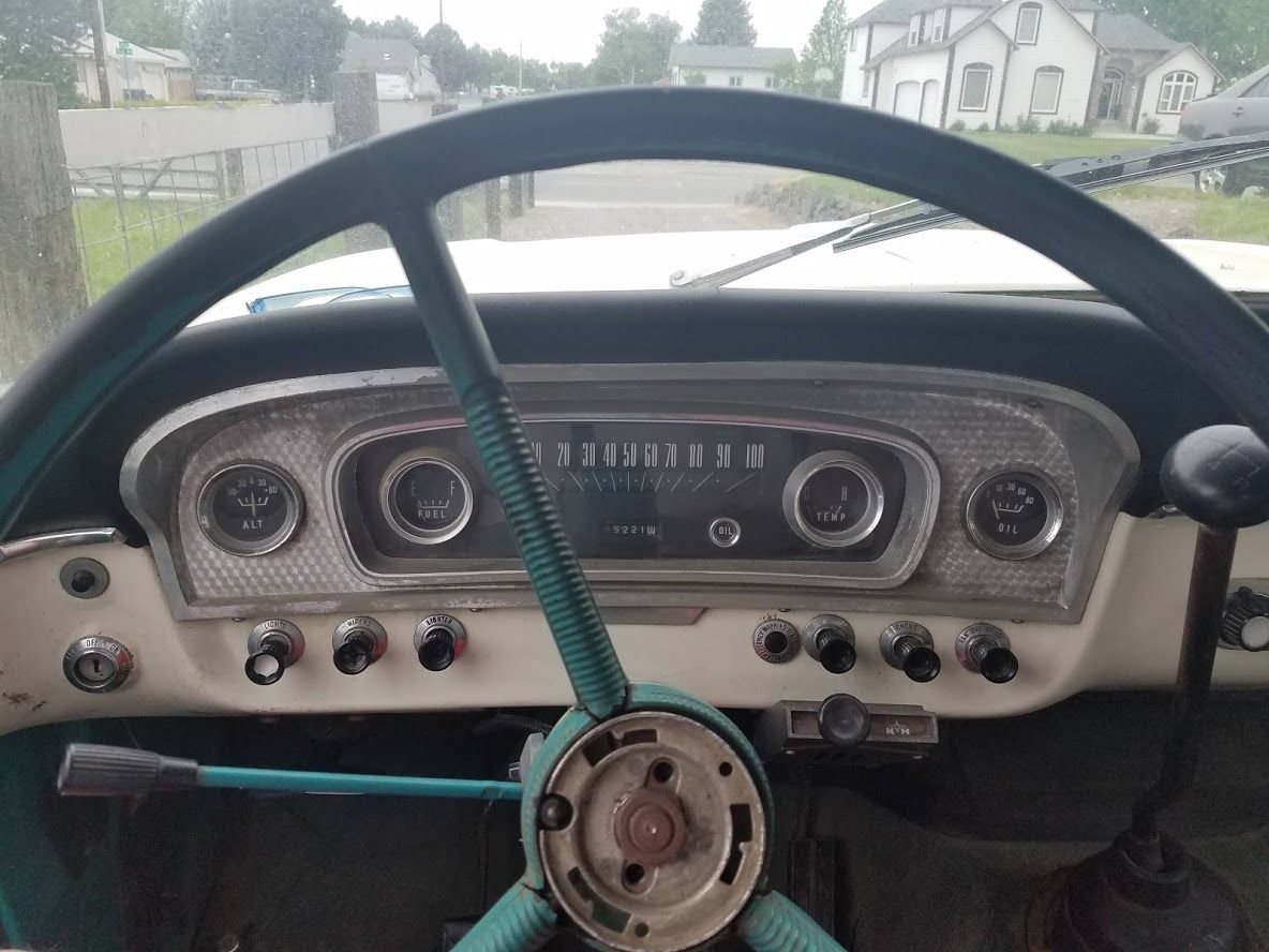

Any thoughts on what the "KH" thing is under the choke?
Old May 14, 2019 | 05:40 PM
66v8baby's Avatar
66v8baby
Joined: Sep 2016
Posts: 1,459
Likes: 70
From: Southern Maryland
It's an old style Kelsey Hayes trailer brake control.

I know where there is a good 66 grill. I picked up a set of stainless 3/4 ton wheel covers yesterday. Same guy has the grill. He is in San Anselmo, Ca. .

C4TZ-17906-A Painted & C4TZ-17906-B Chrome .. Styleside Contour Rear Bumpers / Reproduced
1964/66 F100/250 2WD / 1966 F100 4WD / 1967/72 F100/250 2WD/4WD & F350 / 1973/77 F250 4WD (High Boys) / 1973/79 F350 Regular Cabs on the 140" wheelbase.
1964/72 contour bumper brackets are different than 1973/79 contour bumper brackets.
C4TZ-17787-A Right Inner / C4TZ-17788-A Left Inner / C4TZ-17795-A Right Outer / C4TZ-17796-A Left Outer .. Contour Bumper Brackets / Reproduced
1964/66 F100/250 2WD / 1966 F100 4WD / 1967/72 F100/250 2WD/4WD & F350.
