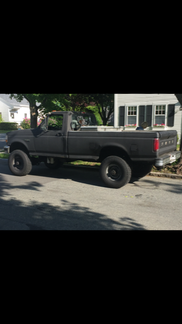

there she is...

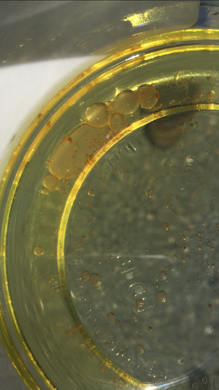

After draining my water separator...i took a sample of fuel and it looks like this.
Not sure if those bubbles are oil of water or a mix?

Oil would mix in the fuel, not make those "bubbles", so to me it is water.
Old May 13, 2019 | 08:25 AM
DIYMechanic's Avatar
DIYMechanic
Joined: Dec 2010
Posts: 10,121
From: Orrville, Ohio
Definitely water, and not enough that I think it would cause the issues you're seeing. It's normal for the water to separate in the fuel filter housing (thus the "Water in Fuel" sensor and the drain on the filter bowl). I think you have injector issues, The issues you're describing are consistent with those of a cracked fouled nozzle.
