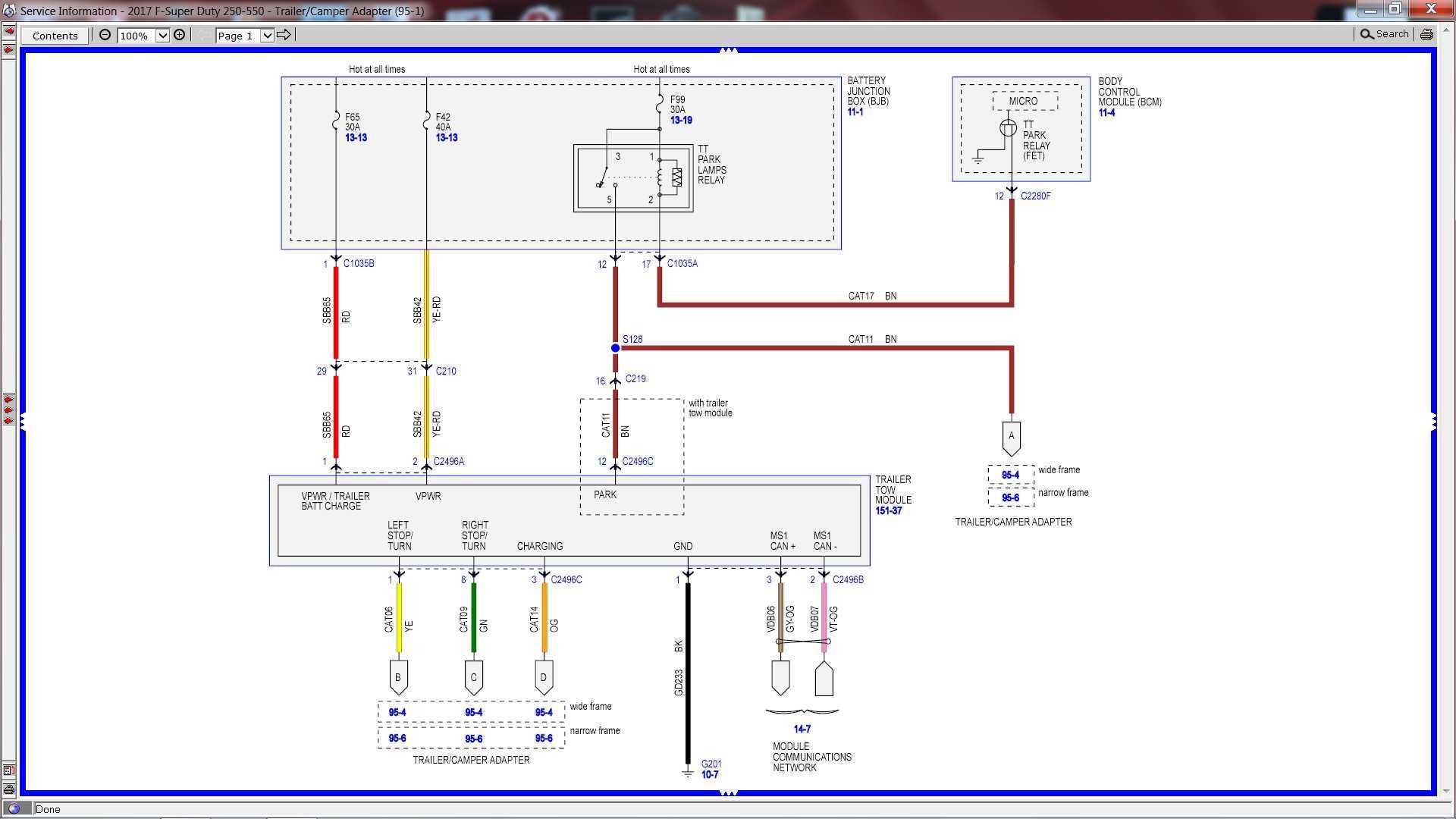

See F65 in this diagram
Old May 10, 2019 | 05:01 PM
whmayhew's Avatar
whmayhew
Joined: Feb 2009
Posts: 106
The 65 fuse is good.
