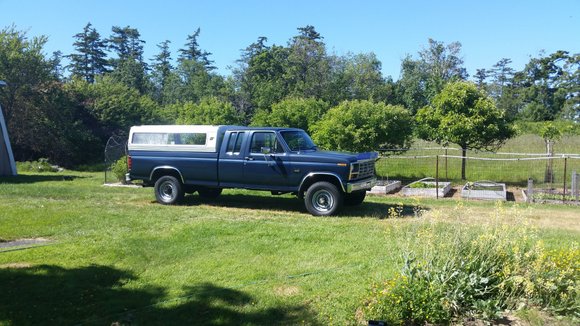

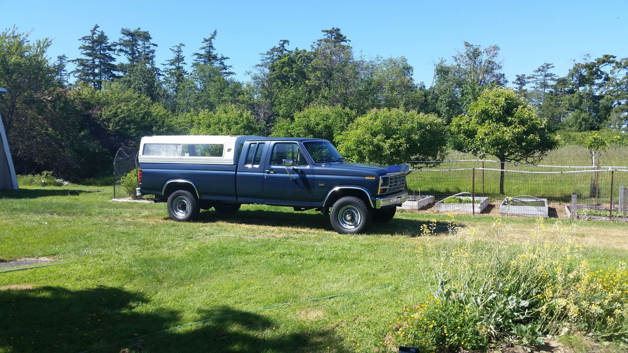

You want to apply it on a sunny warm day. Put it on as thin as you can. Bake it in the sun if you can...it continues to migrate and thin. Less is more on the paint...stretch it. When it's applied thin like that dust is not much of a problem but I don't live in a real dusty area either. For washing I don't use hot water or soap. Cold water rinse with a hose takes off dust and dirt. Then I use paper towels on any bad spots and let it dry...then dry wash it with a dry wash mop. Very low maintenance for me. Sometimes I use no water only the dry wash mop for dusting.
I applied the fluid film for the first time a couple years ago. Then a light touch up as needed on problem areas to keep it maintained. As long as you don't use soap you won't need to re-apply it much at all. On the oxidized roof and hood I did do a couple applications. The oxidized paint absorbs more than the areas of good paint.
A gallon of it is pretty cheap and it's so useful in other areas of your truck. I'd hate to run out to tell you the truth. go to https://www.fluid-film.com/ and check out all the uses.

If you get that nice thin film on it and can sun bake it in a bit I think it won't be too bad for you. Because it dissolves rust and protects against further rust I'd try it first on only the oxidized parts or any rusty spots and see how it does with your level of dust. Since it protects like a wax the water beads up like crazy and the beading up tends to lift off the dust and wash it away. I'd give it a try if you are on a budget and looking for a cheap way to protect and give a shine at the same time.
