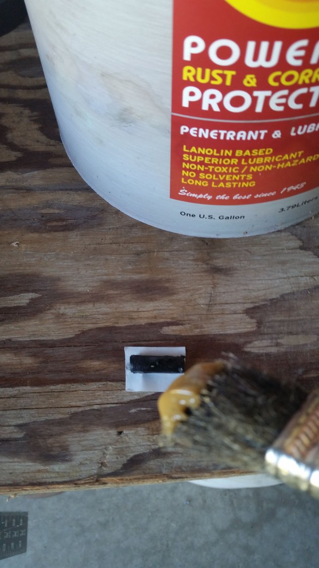

Ok...let's find out what happens when FF is applied to butyl window sealer
Here's a piece of 1/4" window sealer and some FF
Let's slather it on like a drunken sailor...
OK the test bed is set. We'll come back later and report on any reactions.

I think other compounds are used for windshields too, like urethane rubber. And yeah this butyl sealer I have was made for windows and is sticky tarry like. Not like Butyl rubber.
I put enough FF on that sample which could have done most of a front fender. About 1000 times what might get to touch the edge of the sealer compressed in the window fit when FF is properly applied to the painted body.
About how long will it take for Fluid Film to dissolve the butyl windshield sealer? Hours, days, weeks, months or years?

Ford used the butyl window sealer for the original windshield installations but if you have had your windshield replaced anytime in the last 20 years it was likely installed with urethane adhesive rubber. These compounds are oil and gas resistant. Besides Fluid Film is not oil, contains no solvents...says so right on the can...formulated from lanolin...and after one day in contact with butyl sealer has done nothing to it but sit on top.
Your criticism of Fluid Film appears to be totally unfounded.
