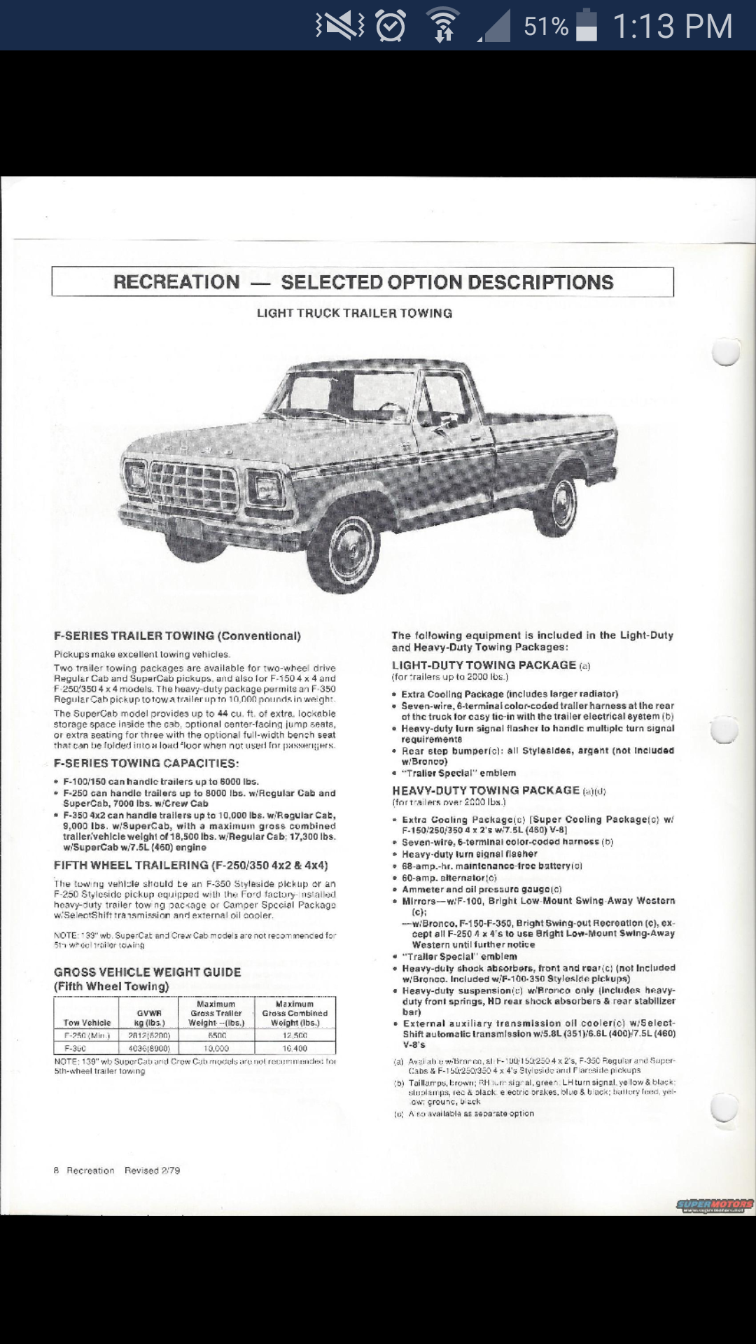

F150 trailer specials do not come with any of the above. I would know, as I own one. At best its got a couple extra leafs, bigger shocks, a bigger alternator (for '77 standards) a 460 and a C6 with a cooler. See the photo above for exact specs. HD trailer specials included more options, but then again they still make no mention pertaining to brakes. Pretty much everything else is standard issue. Single piston calipers, regular front coil springs, no sway bars, etc.
