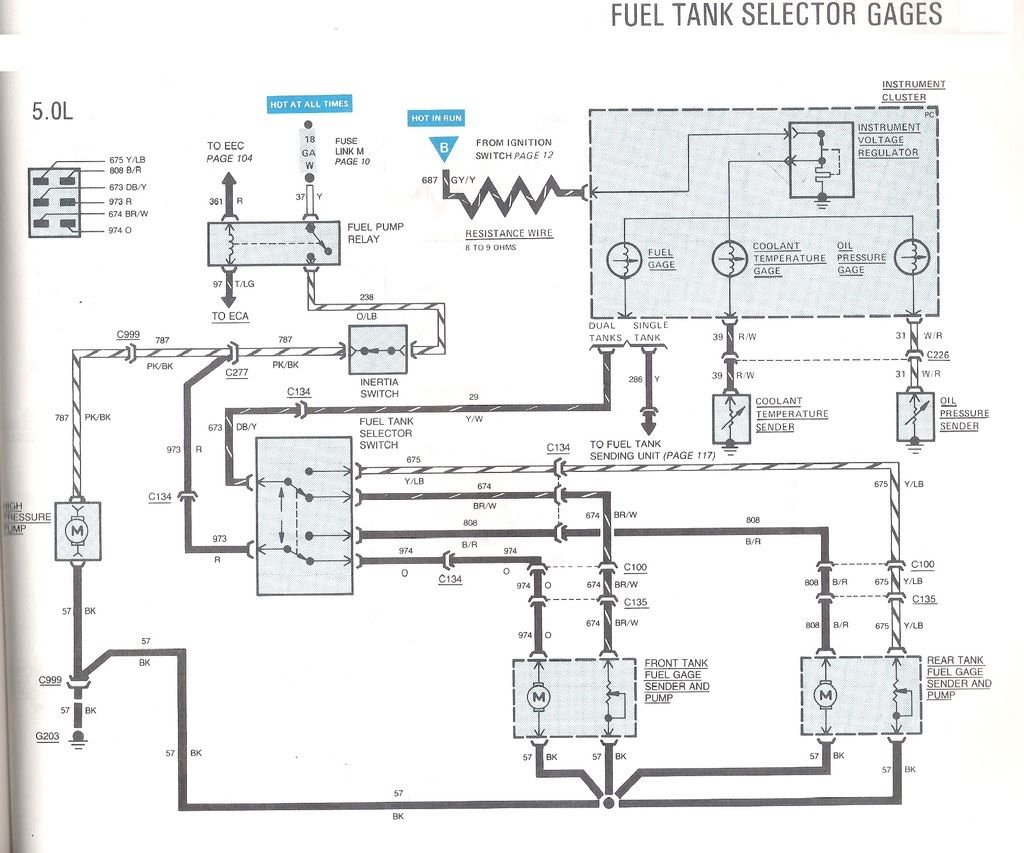

Other probably irrelevant data... Since I had the van, both the fuel gauge and temp gauges have not worked. Today the fuel tank worked for about 4 minutes and the temp guage moved slightly, but never in the middle.

The oil, tempature, and fuel gauge all work through a IVR (instrument voltage regulator) that is located behind the instrument panel. If it goes bad you will get erratic readings on those 3 gauges. The voltage meter is not connected through the IVR. It could also be separate issues in the wiring with each gauge. Do you have single or duel fuel tanks?
Often people use teflon tape on the temperature sending unit. The sending unit has to ground through the intake manifold where it is threaded in. sometimes the teflon tape may keep it from making a good ground.

Since one tank is working then w snow the gauge is ok.
this is for my 88 but should be close to what you have.
