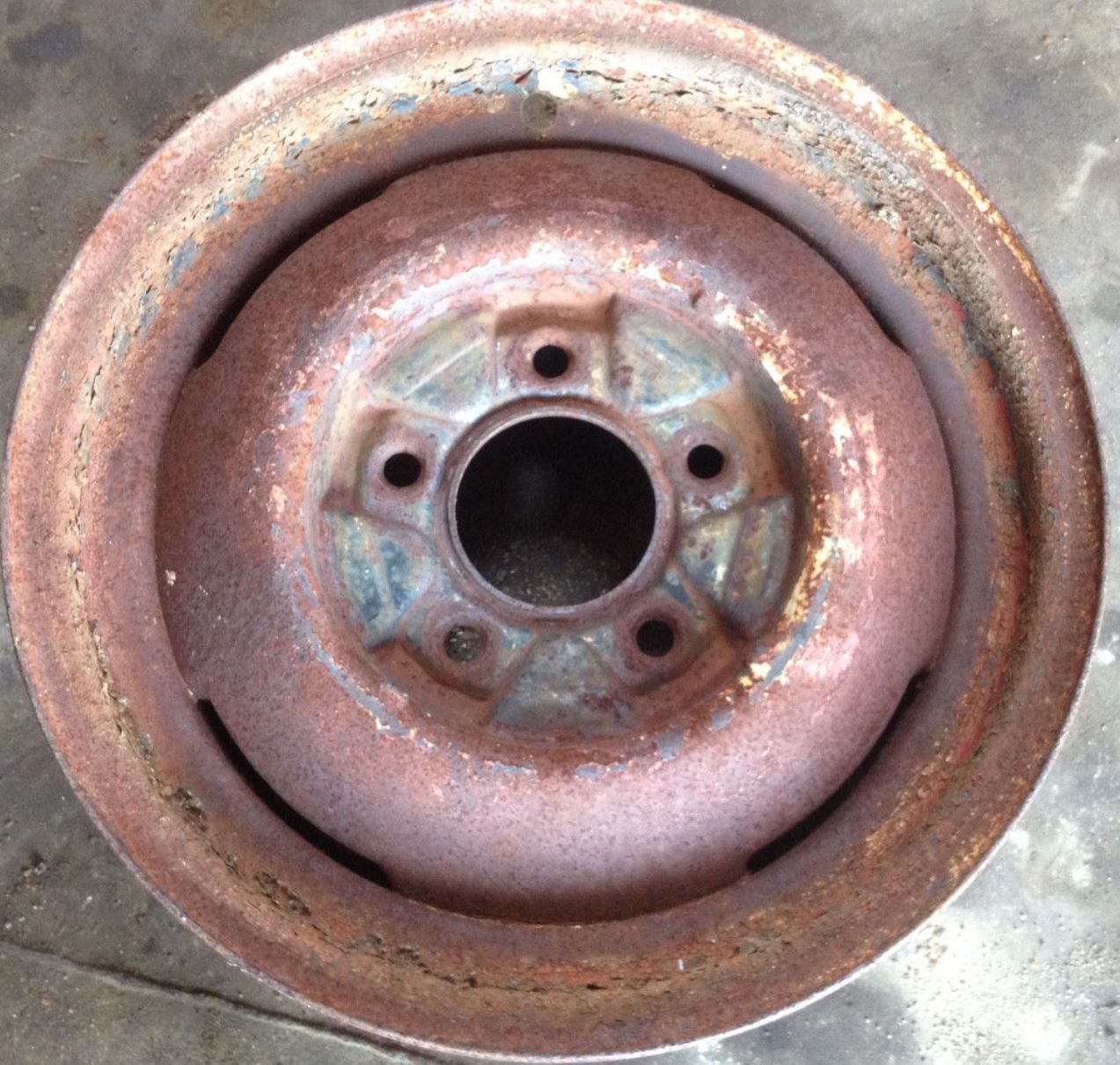

The stock wheel that you link to will work fine with your truck. Those wheels will not accept the wheel covers that came stock on your truck.
Stock rim (innie)
"Late model" rim (outie)
