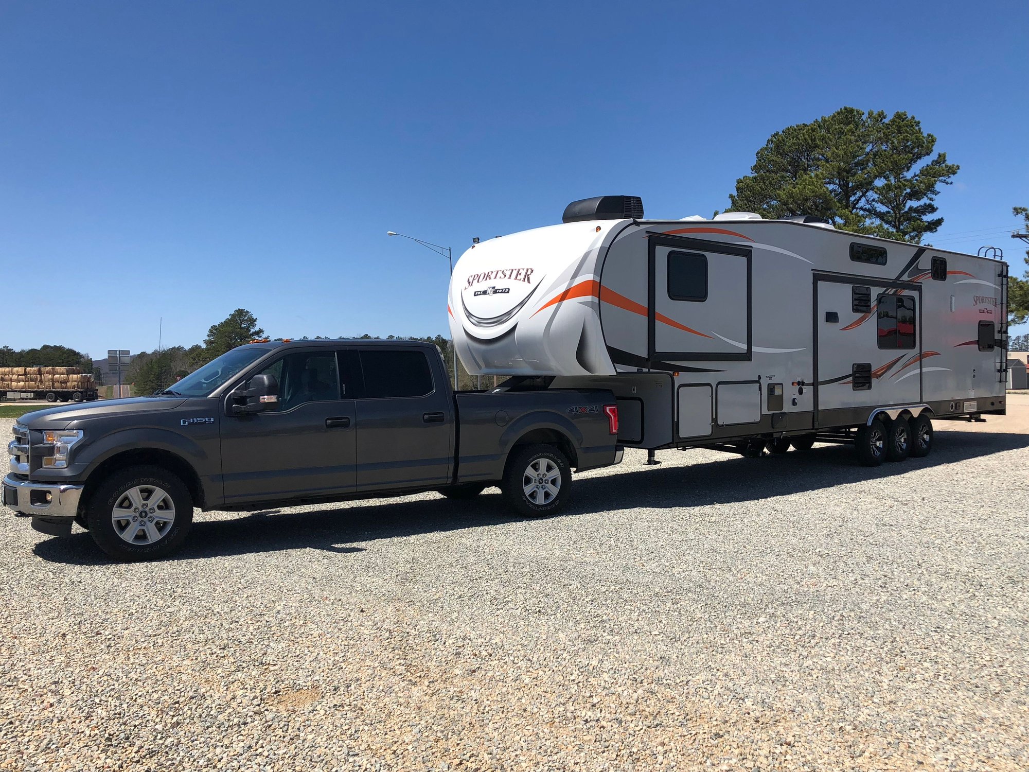

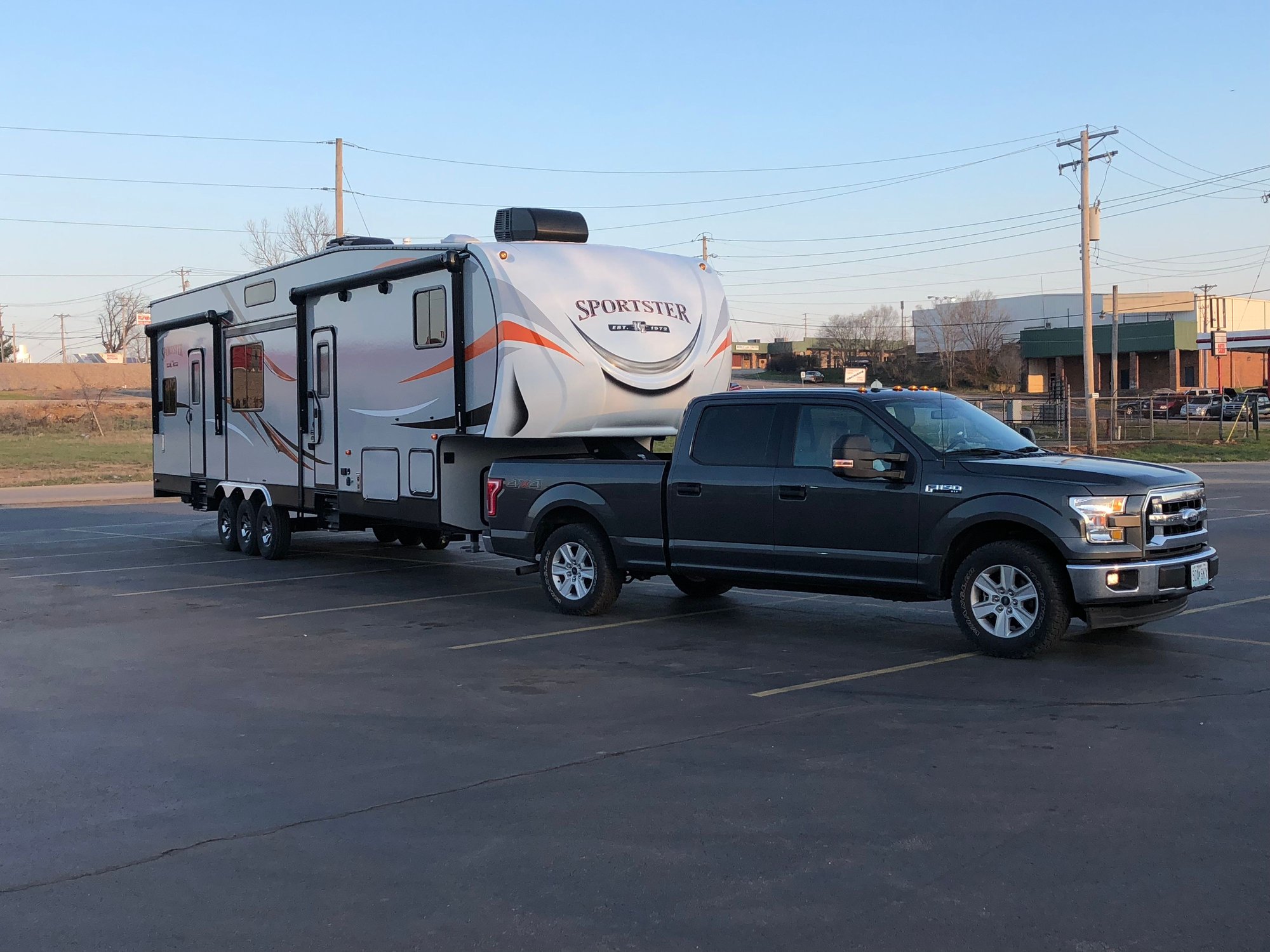

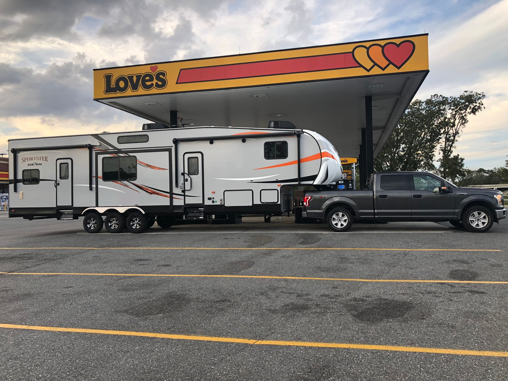

Originally Posted by StonedGrey
It happened.
Not for long, but that is a different conversation. How did you keep it level with nearly 2k on the pin?
