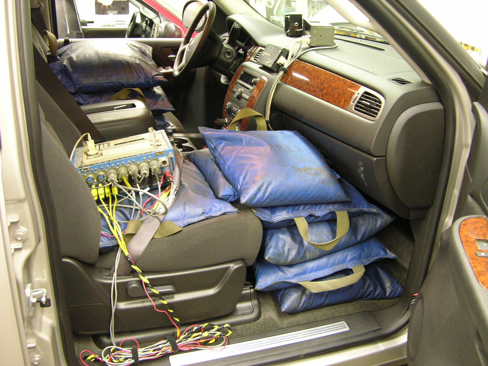

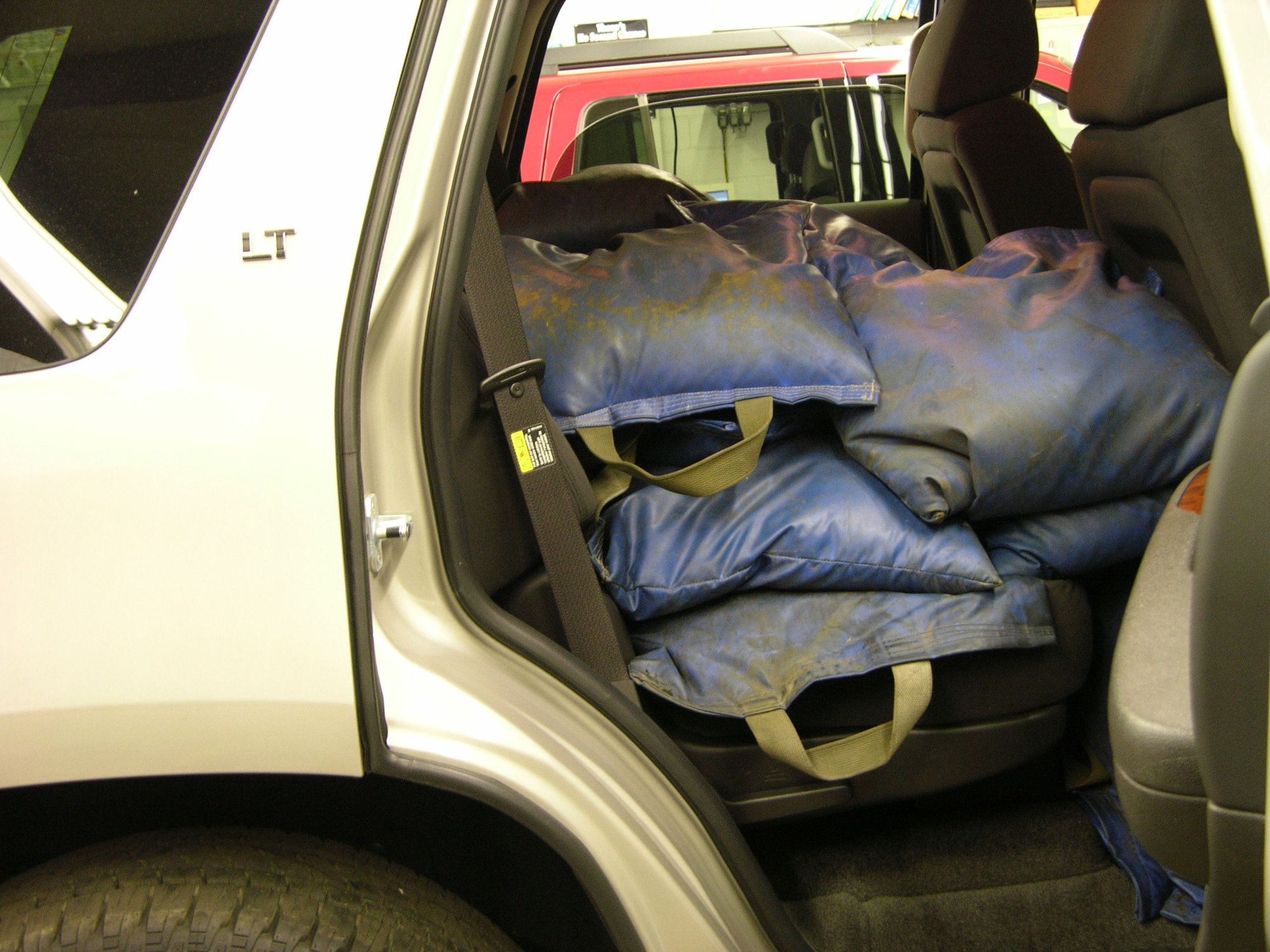

Yukon ..... hope you take better care of one than we did. Our kids were heavy, those were 50 pounders. Targeted wife was 300.

Haha. It hauls the weight too and the airride compensates for suspension but do wish the brakes were a little better. That's all I can say about that. We do love it though for the past 6 years or so. Far cry from the Escape it had replaced.

Depending on the year, I'm not sure if we were still the supplier of friction materials as we were in 2007.
If it's stock, it uses "ceramic" (Potassium Titanate fiber) friction material. At the time, it was the highest GVW that anyone could get to pass FMVSS requirements. It did so by the test requirements, but that with new condition, not age tested in service.
