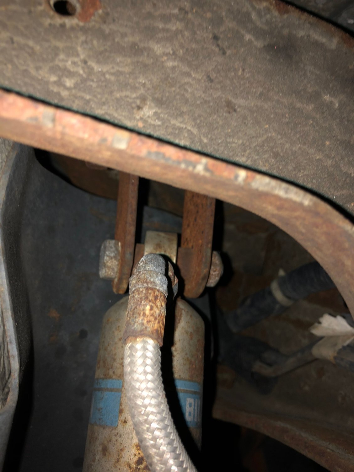

R
Rear upper shock mount.

Posts: 8,259
Likes: 346
From: Northern California
about what i figured, i will need to lnow how long those tabs are to make sure the shocks I suggested are going to work. might need to either go back to the stock T bar or get a new shorter mount. not a big deal
when you get them off snd measure them we can know for sure

Can I just go ahead and order the new upper OEM shock mount so I don’t have to pull a shock then pour back on to drive to shop?

procomp 53405 bar pin, you will need 2 of them.
the OP likely used the factory bolts and capture nuts.
if not these look like the correct ones
https://autofastenersandclips.com/pr...nt=19613932103
