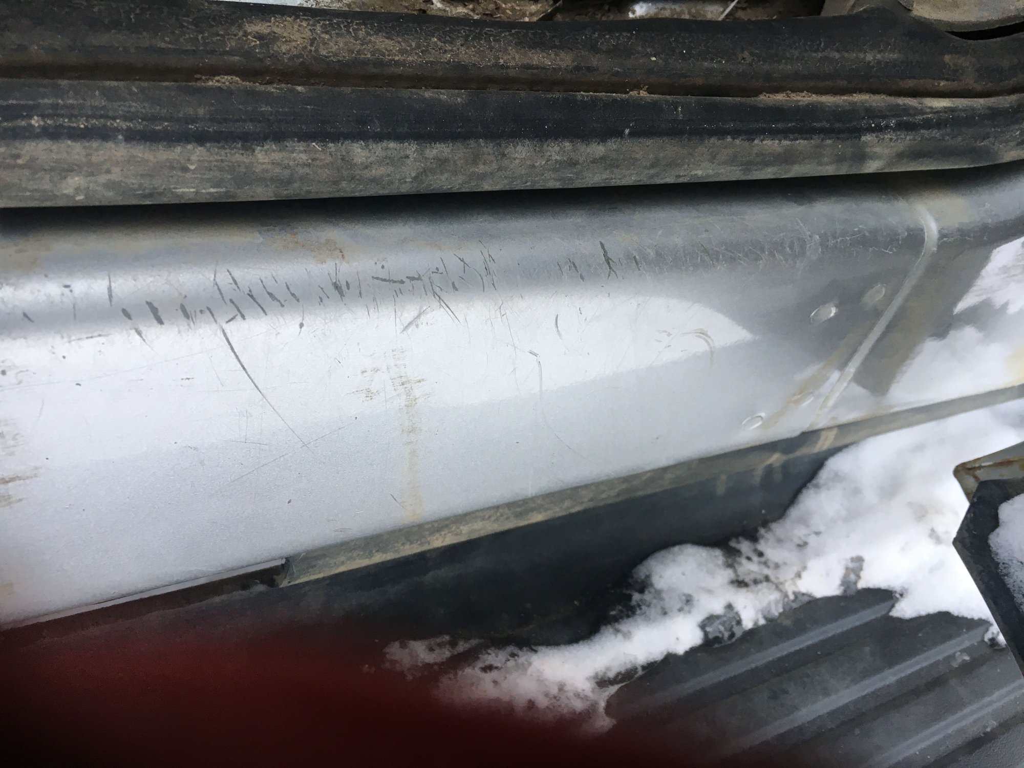

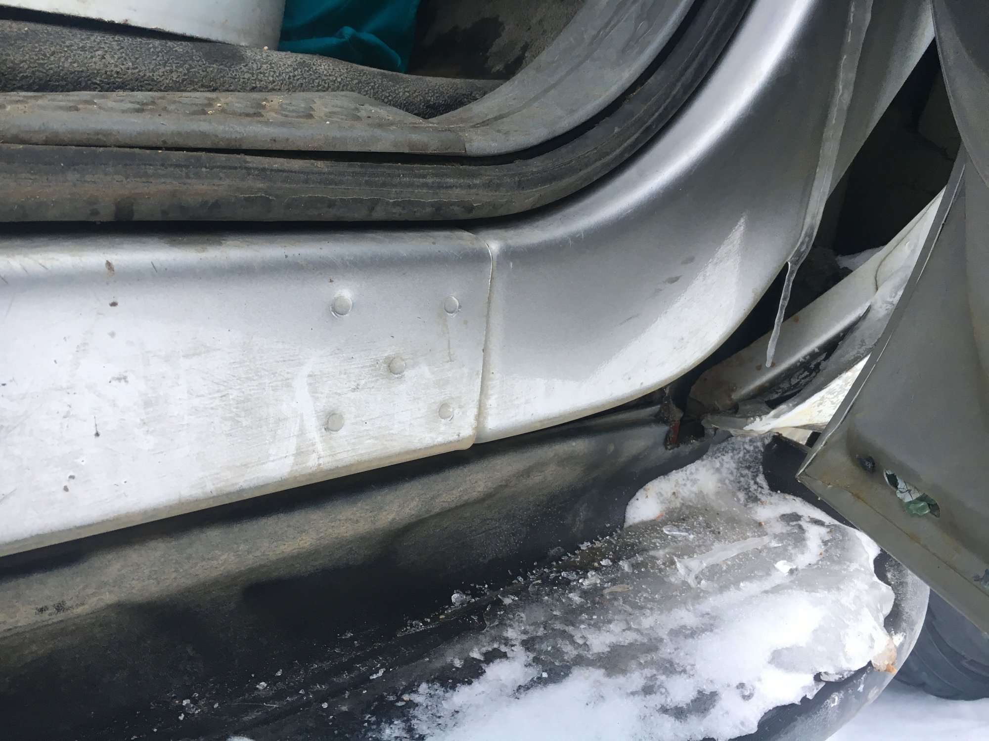

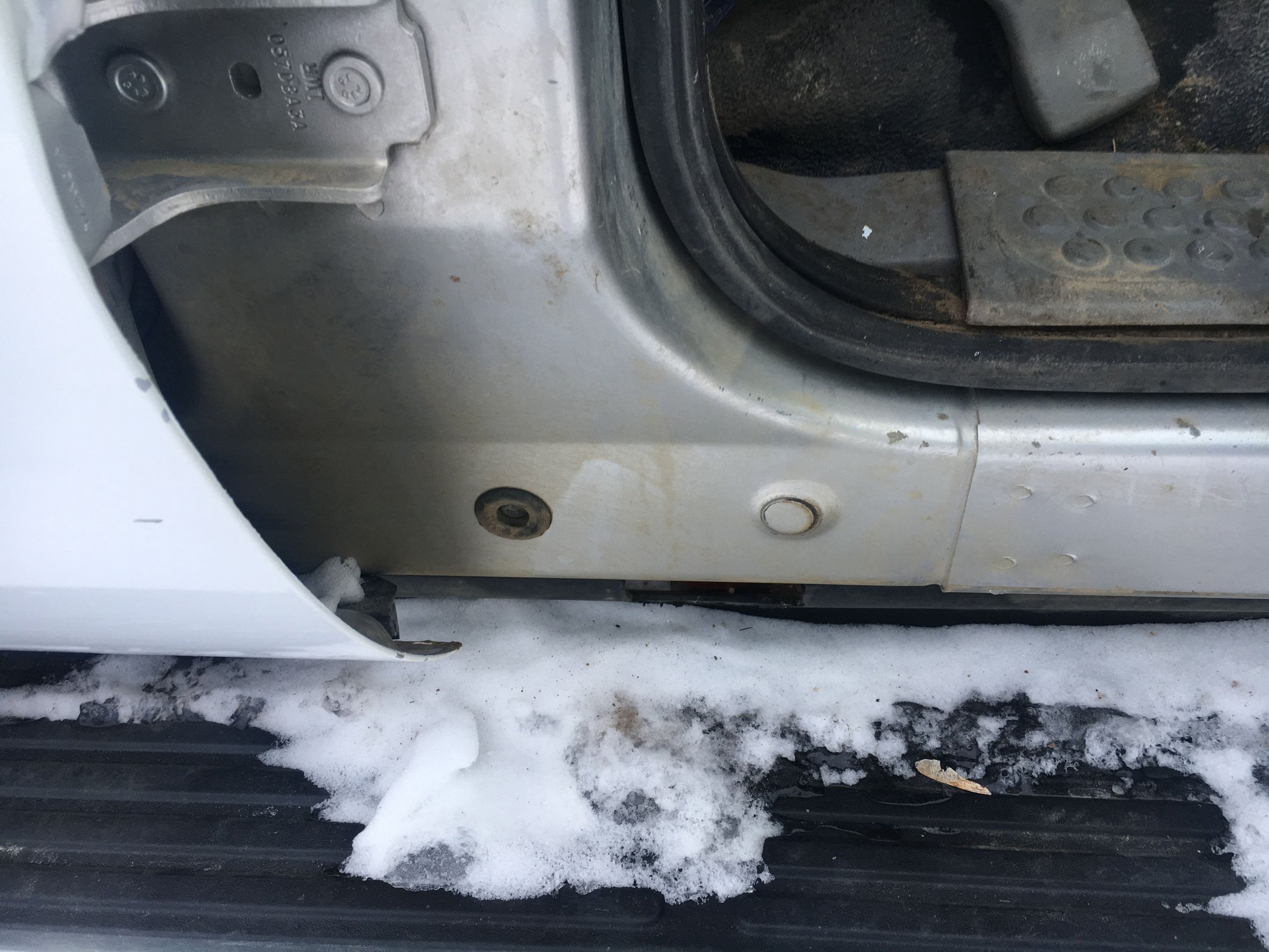

Thank you for the replies. My donor truck is a 02 F250 manual 2wd with 150k but the body is beat. I figured that the pcm will not jive with the Ex so I probably will dump that off. I am waiting on word about a gasser Ex for parts but don’t know yet if it’s an 8 or 10. Also I am right now dealing on a running driving 02 V10 XLT 4x4 with 150k with 3rd row and spare tire cover but the rockers are so-so it looks like $1200 Cdn so I pretty much have to buy that. I’m aware these 10’s like the gas but I do get 20+mpg with my diesels so if I got 15 with my Ex I could live with that. Pics below of the Ex I’m dealing on and also the rockers on my white one. Thanks again for the input and will keep you posted.
$1200 Canadian needs the back window I don’t think I’m going to try to go lower. Just take it and run
