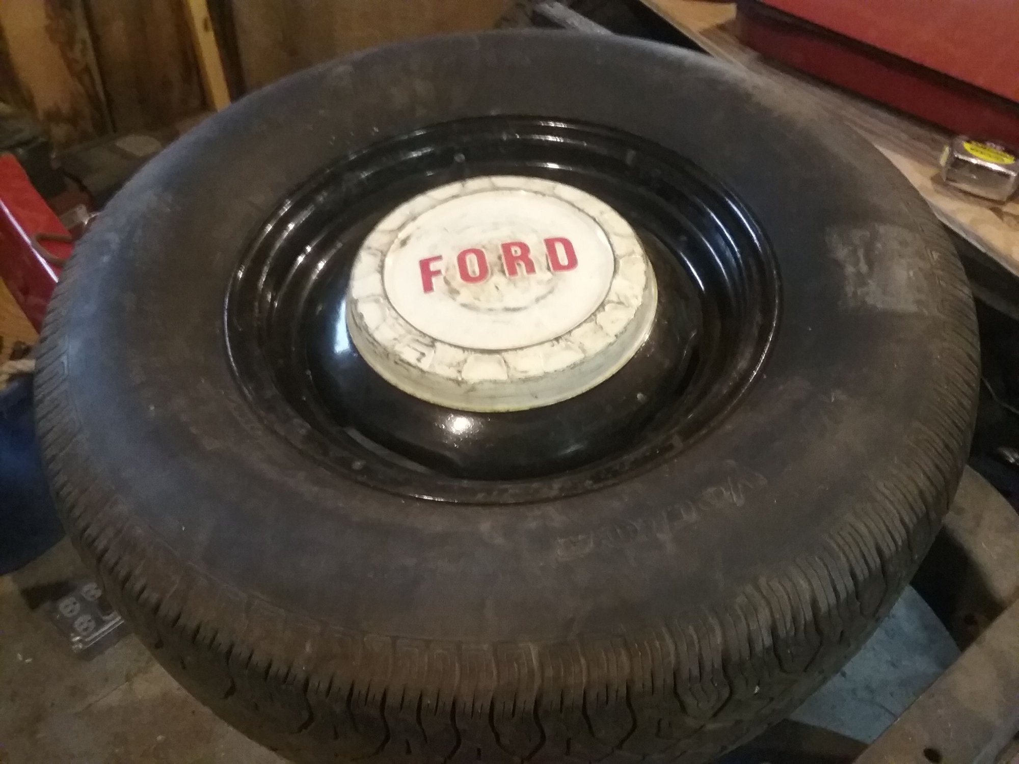

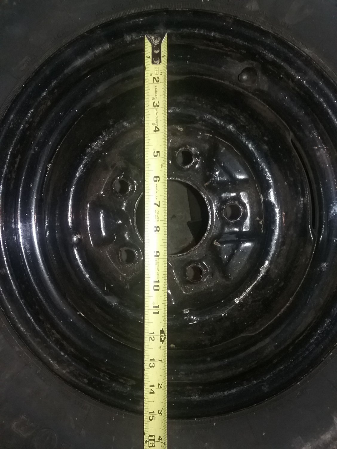

Some pictures
Here are a few photos. You can see that the spare rim is period correct and accommodates the 9.5 inch painted innie bottle cap. Next you can see repro rims that came with the truck. These rims accommodate the smaller innies that came with truck that ND identified as coming from an early 40s car. (See my first ever post). Lastly you see a closeup of the painted spare which is a riveted 15" rim with a tape measure for reference. Thanks to all who have provided vendor info. I continue to invite any comments and/or suggestions. Tim
Painted bottlecap on period correct painted spare
Reproduction rim that came with truck
Closeup of correct spare
