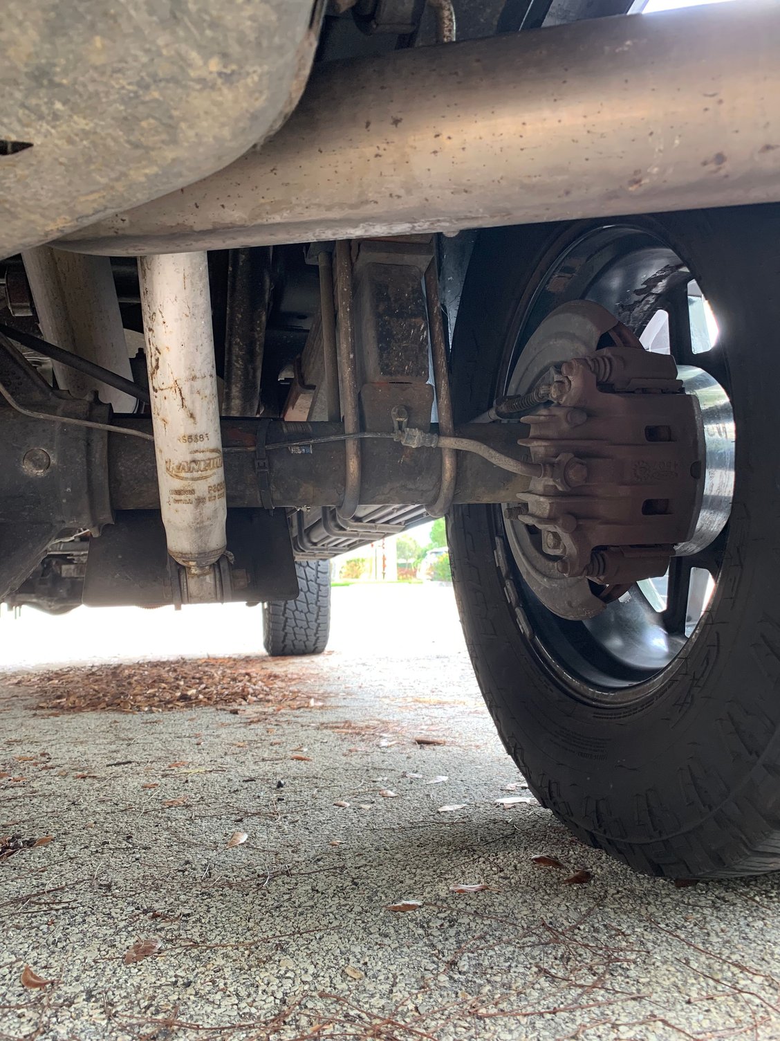

How about a hub to fender arch measurement..... looks like it has already been altered 4” to me.
snap a pic of the front and rear springs and let’s see what she’s sportin under that pretty dress.

the front is 26.5
rear is 27

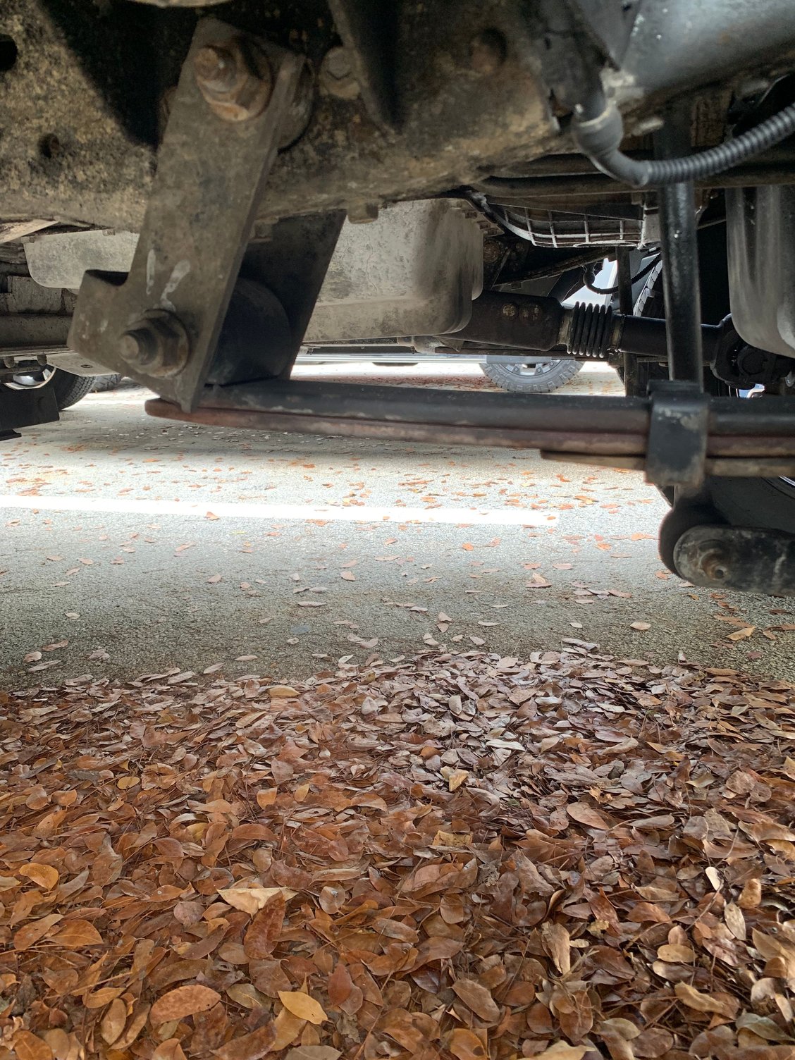

This is the front. Not sure which shackles were used to get the lift (front or back).

Back is a huge block and front looks to be stock springs and stock shackles with a couple of add a leafs.....let’s just say ......that sure is a pretty color of blue.
seriously, is the paint factory ? Did they paint the cladding to match factory paint or is The whole thing custom ?

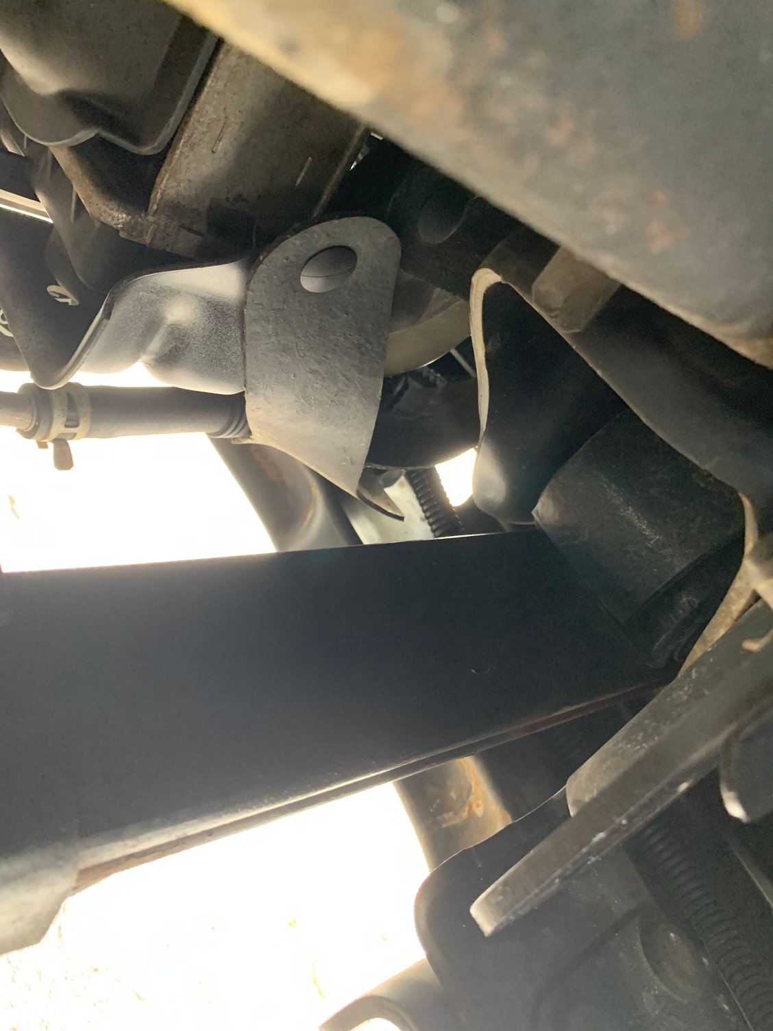

I take that back....front springs are not stock, at least not stock excursion, see the clamp around 3 leaves, Excursions only had 2 leafs so it wouldn’t have that clamp. Front are mystery springs.
it is missing a bump stop.
