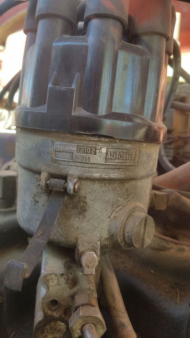

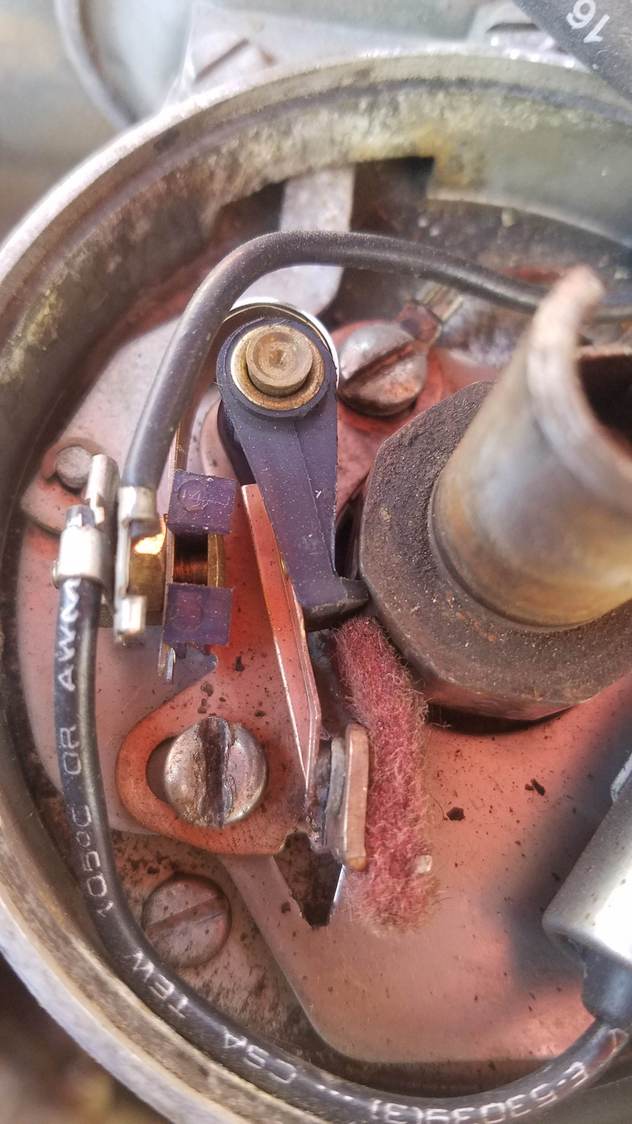

I went out to replace the points yesterday and couldn't find them in my "unique" organization and storage system... I tested the coil and got 1.5 or 1.6 ohms so that's right on spec. The voltage at the (+) terminal was 6.1 and the (-) side read 0.2. My dwell meter is probably stored right beside the new points along with my feeler gauge set. I decided to quit being a cheapo and contacted Pertronix about getting an Ignitor trigger. They said the model 1281 fits these trucks so it's ordered and should be here in a few days. Since others may be looking for this info, here's a few pics of what I'm working with.

I found my new points and condenser. The dwell meter was not with them. In the interest of being scientific about figuring out what was wrong, I decided to do one thing at a time and see what happened.
1) Adjusted the points. They were WAY too tight at about .008. Adjusted to .018. Tried starting. No luck.

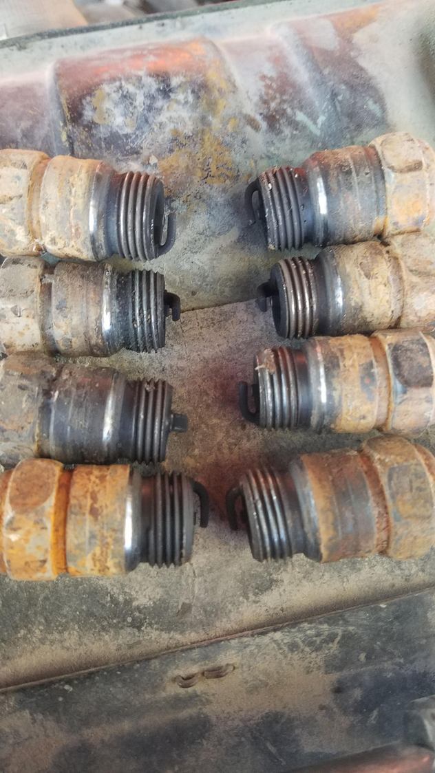

2) Replaced all the spark plugs. Tried starting. Fired right up, but didn't quite seem to be running as smooth as I hoped.
