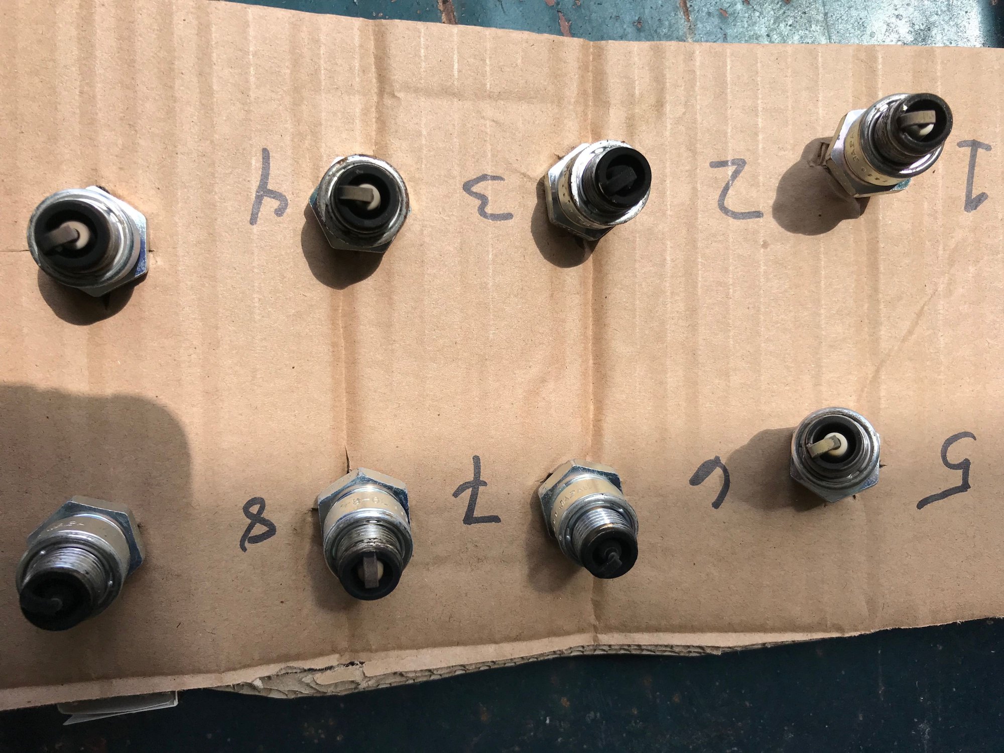

I have done a few tests to determine why my truck is running a little rough. Stockish 1950 flathead V8, Red's headers, Mallory ignition, new NGK spark plugs under 100 miles, and electric fuel pump with regulator. The temp stays at 180, no back fire, and oil pressure is good as measured by a new VDO gauge. Appears the issue(s) are worse or limited to certain cylinders, so am I looking at valve issues rather than carburetor which would affect all cylinders? Are the rings ok if the compression is roughly within 16% of each other?
Compression test:
1-100
2-110 Spark plug Carbon fouled
3-100
4-100
5-120
6-110 Spark plug Carbon fouled
7-105
8-120 Spark plug Carbon fouled

I tested for spark and used a gauge that shows spark going to the plug. This is the second set of plugs with the same carbon fouling at the same cylinders.

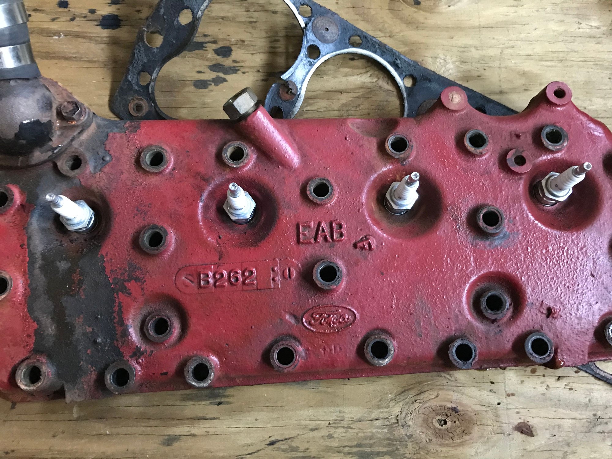

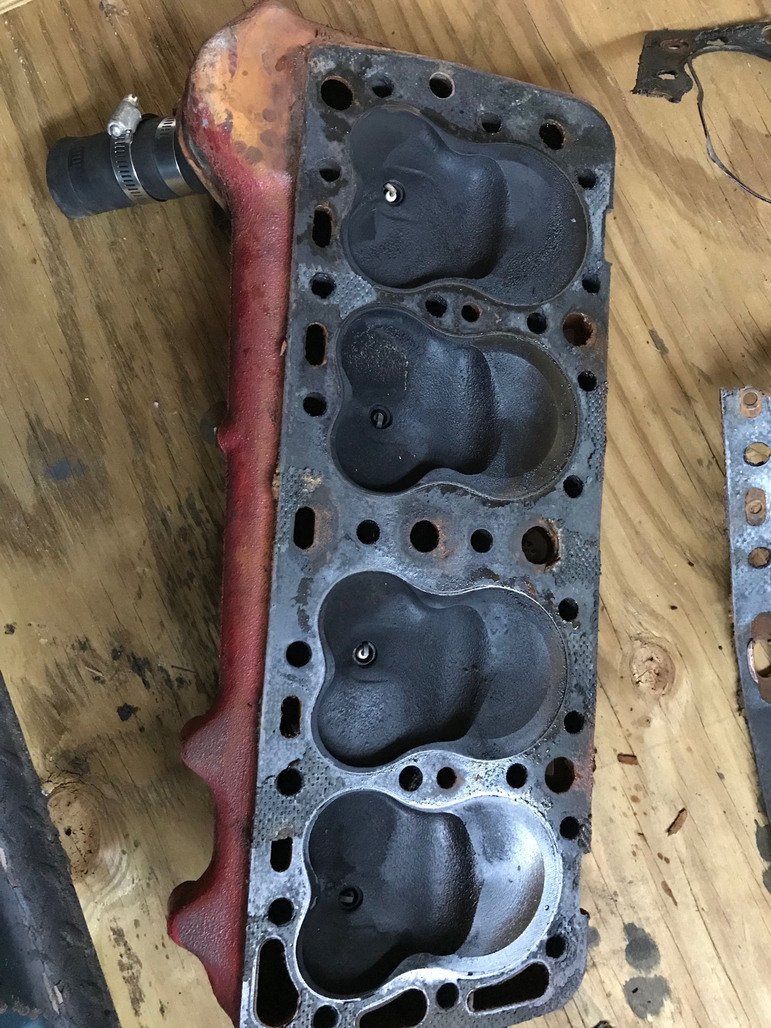

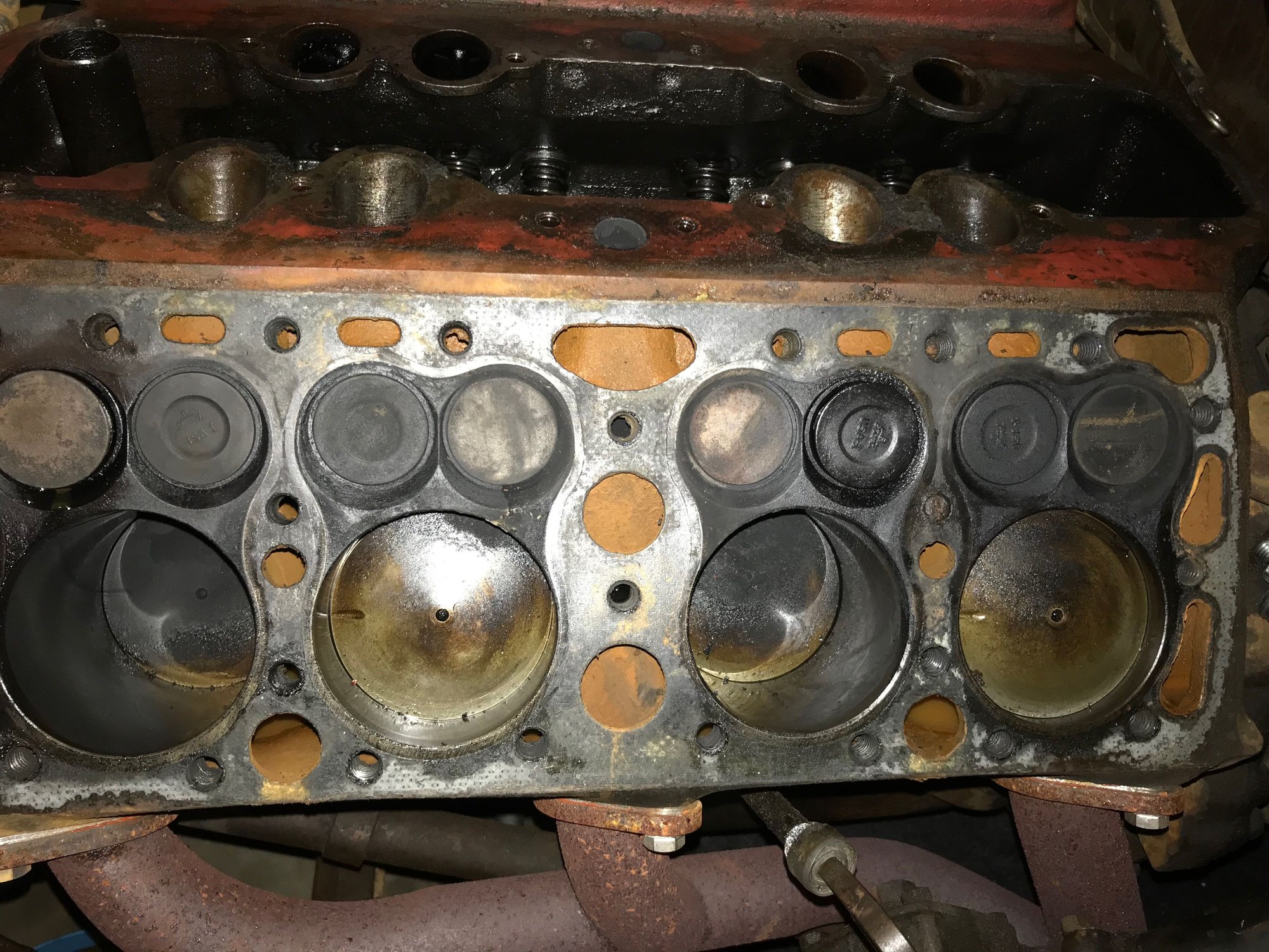

UPDATE: Put Marvel Mystery oil in the gas tank, and in the oil (full, not over full). Ran it like it belonged to my ex for about 30 miles. Smoked, and started to run rough, especially at idle. Manifold Vacuum still jumped erratic from 5-15. Drivers side seemed to run rougher, and it takes twice as long to heat up (180) as the passenger side. Pulled the intake, and driver side head. I bumped the starter with a remote and watched the valves open and close, seemed normal. This is a real mystery? One correction I have a MSD distributor (not Mallory as noted earlier).
Driver side head
Driver side block
EAB heads

Did you clean the head on the chamber for #8, or is that just a trick of the camera that it's shiny and clean? The exhaust valve for #8 is also dark, indicating it is not seeing high-temperature flow. A clean chamber frequently indicates a water leak into the cylinder, any sign of that?
Yes, you can leave the FP pushrod out, it won't hurt anything. It will rattle around and hit the underside of the intake if left in.

I did not clean the chamber for #8 when I took that picture, I have since cleaned it. There is no evidence of water, and the spark plug is carbon fouled. I would think in a water leak situation the spark plug would be clean also. The block looks good, and the gasket looks good.

Also I noticed that the pistons, after cleaning are .060

It's still possible that valve(s) or lifter(s) are sticking, maybe not every time they cycle, or are being held open with carbon that is popping off the surfaces. What are your valve clearances? Soak the lifters and guides with Kroil or something that will dissolve hardened varnish.

Not that it would give you the symptoms you've described, but it almost looks like there's a crack from the valve port to the cylinder on #6 exhaust. Did you notice anything there while cleaning? - Bob
