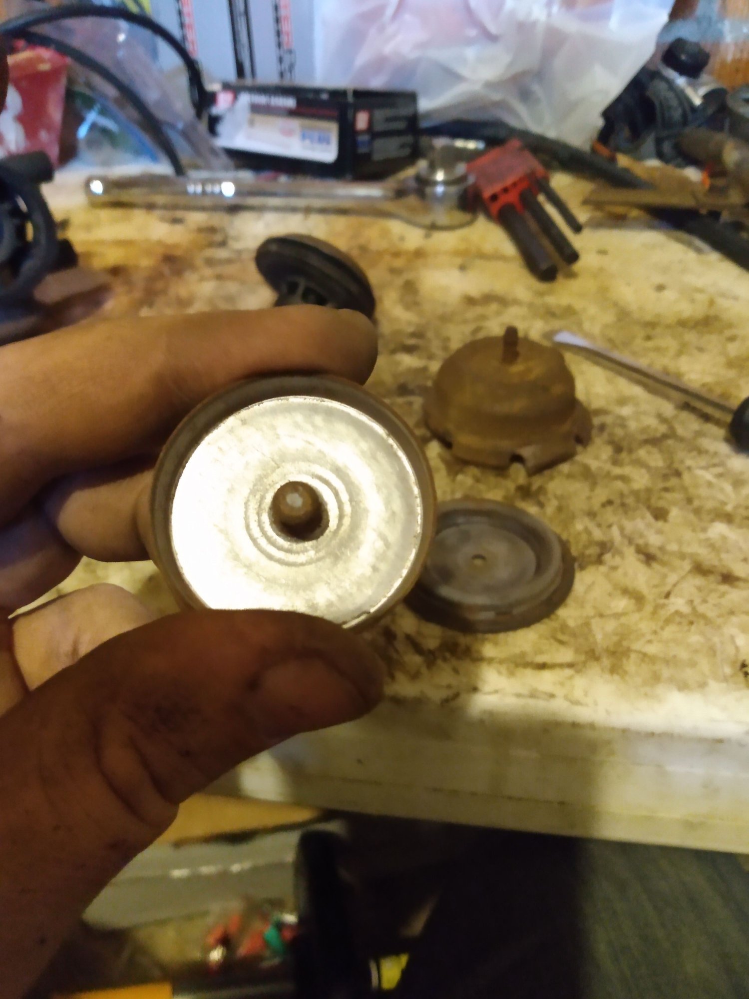

Internal components of secondary air injection diverter valve
Originally Posted by WolfMann
Hey everyone new member here, recently picked up a 1990 f150 with the 4.9L engine. Trying to clear up a code 44 and it looks like my combination bypass/diverter valve needs replacement. I'm having a hard time finding one and wondering what the story is on these? Are they not made anymore? Any chance of aftermarket parts? Been looking around online without much luck. Any help is appreciated, thank you in advance.
I believe it's a special type of compression spring but there are two of them in the valve of this kind.
Rubber gasket or seals may be replaceable if find the part or may be able to make your own.
Can open it up by pulling the tabs out enough without breaking to open it up.

were you able to repair your valve after taking it apart? ie: when vacuum is applied does the valve open and hold? mine on my 87 f150 with the 5.0 is not
holding vacuum either.

I don't think it ever worked, possible with a better repair? I ended up deleting it.
