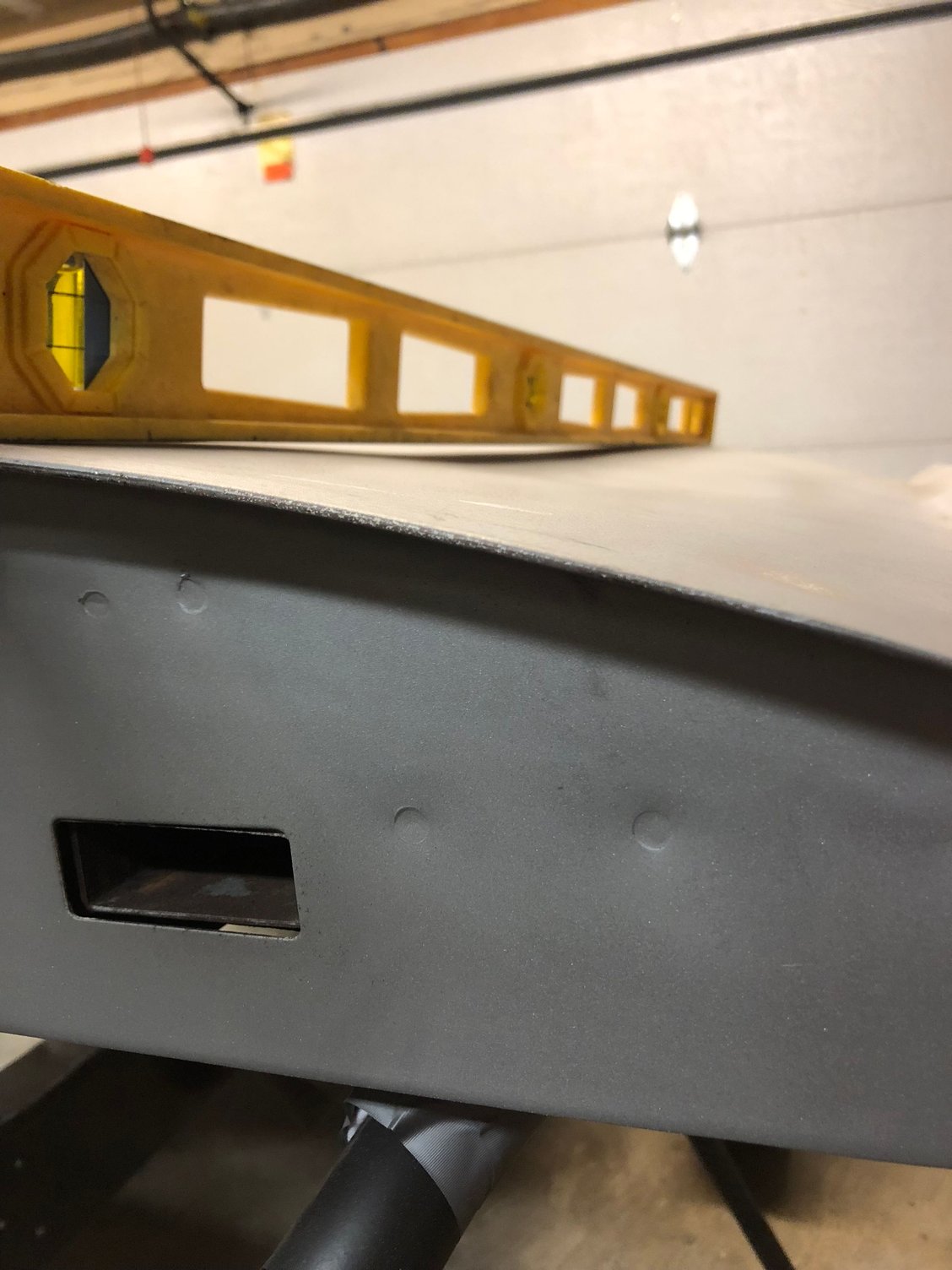

So I’m pretty new to the body work. I have done well getting out small dings and dents with a hammer and dolly. I have my door that has a large dent as if the whole panel was pushed in. How would I go about pushing it back out? Without the obvious answer of pushing it out. It just springs back to the dented position.

What is happening is called oil canning. Check out this video.

What happened to the door? Did something hit it, or did it "hook" on the fender??
Can't even begin to recommend a repair method without knowing more, so don't start shrinking anything just yet
