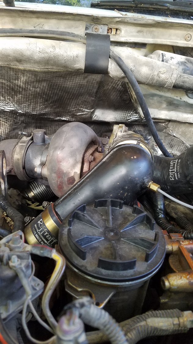

I was under the impression that the MAP line tap would flutter. Not sure the model spyder, the stock OBS spyder with RiffRaff boots. The plenums are stock. This is how it looks. Self tapped the PSI fitting into the spyder with teflon tape and silicon afterwards. I don't recall it fluttering after I first installed it, but I was only hitting 12PSI tops. Tightened exhaust manifold bolts and got up to 15PSI, and I started to notice flutter. Recently replaced passenger side exhaust man. gasket and up pipes, and hit 20PSI, with a little bit of flutter. I can't hit the highway til Wednesday. I will take a video. It seemed to behave today on the back roads, even up to 15psi.

your location for the fitting has so much turbulence it will flutter a lot and maybe even acting like a venturi giving you a wrong reading
