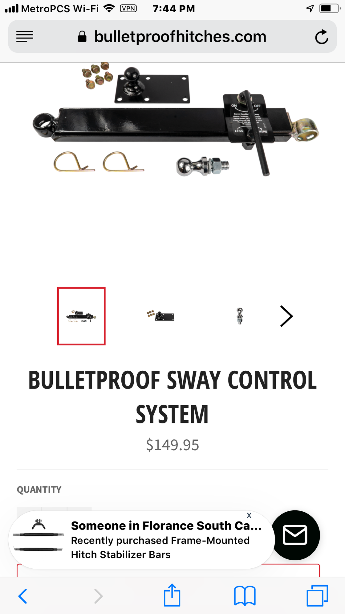

for trailer anti sway it’s a different product
