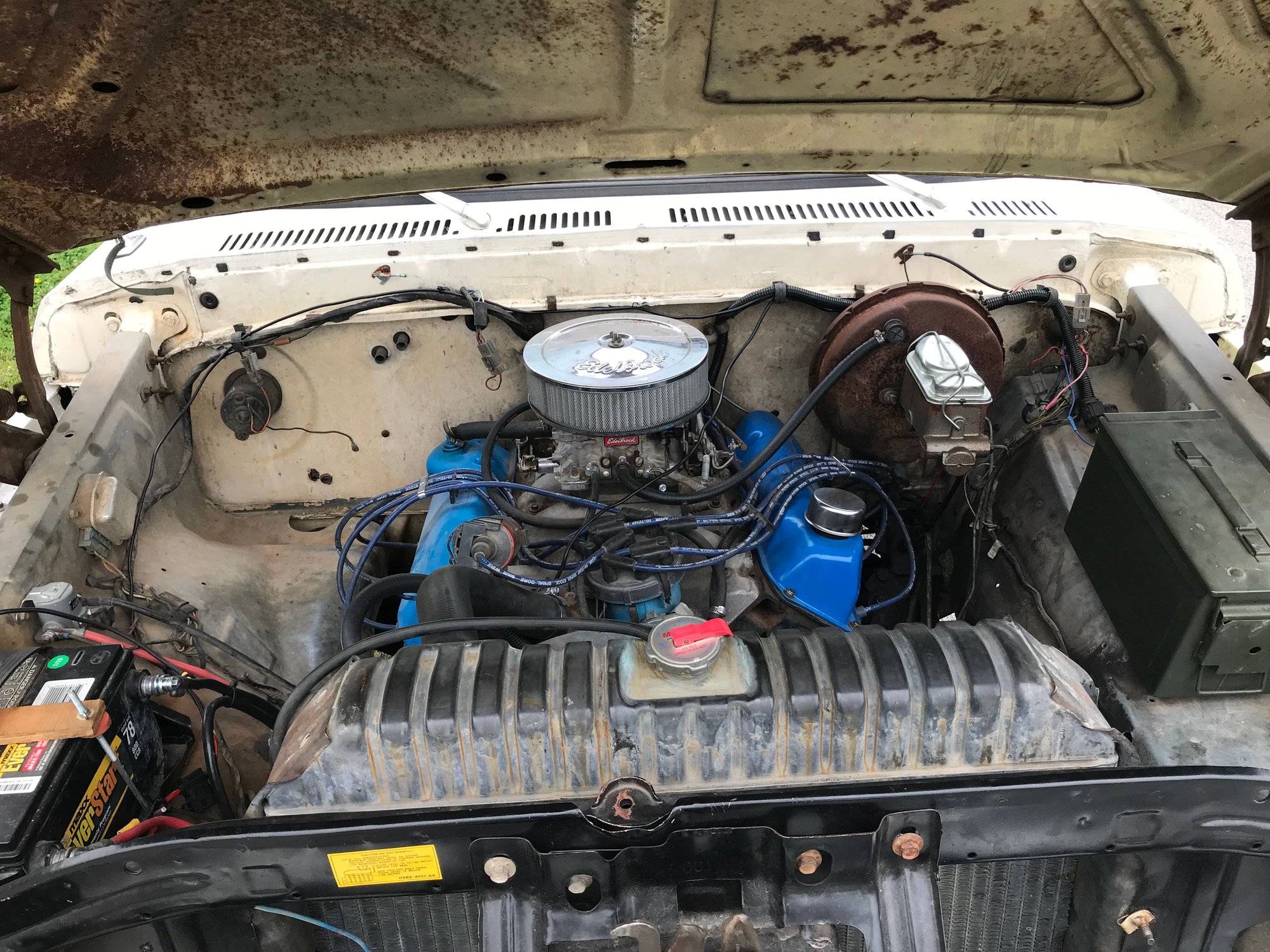

Started a thread for my crew awhile back. Can’t find it now. Have recently started driving it again and the engines been making a heavy ticking noise.
Noise doesn’t occur to bad when the oils thick but when the truck warms up it really starts. Can be heard at idle, gets louder up through 3000 rpm. Louder with the pedal down than it is while engine braking at the same rpm. But still audible while engine braking.
Finished a timing chain install before I started driving it. About a year and a half ago I did a cylinder leak down test. The drivers side bank all held 120+ pounds but the pasenger side were all 80-100.
What are you guys thoughts on it? I don’t really have any experience diagnosing engine sounds. I’d like to pull the pass valve cover off and see if anything in there needs adjusted or replaced. I’ve heard that valve guides could cause the leak down but they wouldn’t tick would they?

The tick I see can be 2 things, a lifter or 2 or an exh manifold leak.
What weight oil you running and what is the oil PSI cold & hot? You do have an aftermarket gauge and not the factory to tell right?
Check around the exh manifolds more so the under side for leaks. Maybe have someone start the motor and you look the motor over to see if you can se any smoke from them.
Did this start before or after the chain change out?

Im running 5w30 valvoline high mileage and a Mobil 1 gold filter. Aftermarket equis water, oil, and voltmeter. Truck runs at 80 pounds on startup, falls down to about 20 pounds 30 min later. 15 pounds shortly after that. 180 degree thermometer.
I think I’ve replaced the manifold gasket within the last two years. Ticking has kinda been there for the last 3-4 years I think. Truck had loud leaky exhaust, many holes in floor, destroyed transmission. I’ve fixed all the things now but the sound still persists. It used to not bother me but I think it might be louder since the timing chain.

Agreed, exhaust leak or lifter eating a cam lube. You can use a heater hose to your ear and probe around the exhaust like a stethoscope. On the lifter side you can pull the valve covers and check for loose pushrod or use a dial indicator to check lift at the rocker arms.

Do you add anything to the oil to bring up the ZDDP content? I believe you might be whiping out your cam if the oil you're using does not have very high ZDDP content as these old school truck's need zinc to protect the cam whereas modern oils have more detergents nowadays. I could be wrong though, so don't panic. It's just a question for now because I don't know anything about high mileage oils.
Also, I had what I thought was an exhaust tick when I rebuilt my motor, but it turned out to be that a push rod was too long (I had my block decked and heads shaved) which was causing the lifter to stay fully collapsed (lowest possible position) when running. If you have a bad lifter, or a rebuilt motor with too long of push rods, it could be the source of your ticking problem.
The 351M and 400 have non-adjustable rocker arms (unlike all the other motors of this era) so keep that in mind when you're looking over stuff.

so if it’s not an exhaust leak we are leaning towards a lifter? If it is a lifter how would I check it? I’m assuming not with just the valve cover off.

Lifter tick is very common on the 351M/400's. Usually the culprit is worn rockers/fulcrums/push rods. In most cases if the rockers are worn the cam and lifters are as well. The quickest thing to do is pull a valve cover and check the rocker on the fulcrum seat and see how much wear is on it. If it is grooved it time to replace the valve train (cam,lifters,push rods,rockers,) Oils back in the day were not great at shear protection and the 335 series were know for rapid valve train wear and will be the first bits that wear out on the engine. Roller rockers are one of the best upgrades (short of a double roller cam chain) you can do on 335 series engines even stock ones.
I strongly advise pulling a valve cover and a rocker and inspecting it. If you are unsure post a pic once you pull one and we can tell you if it is shot...
