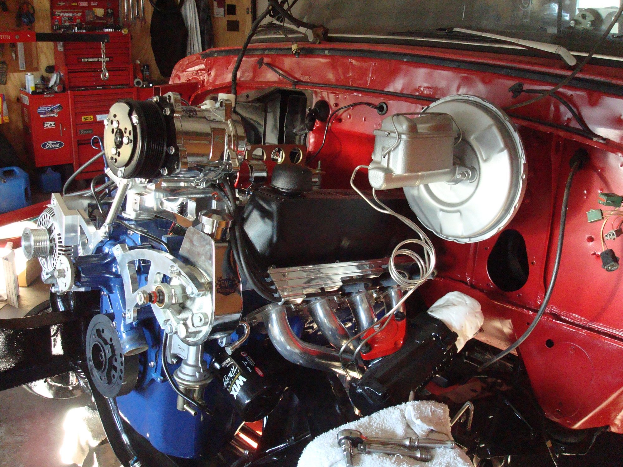

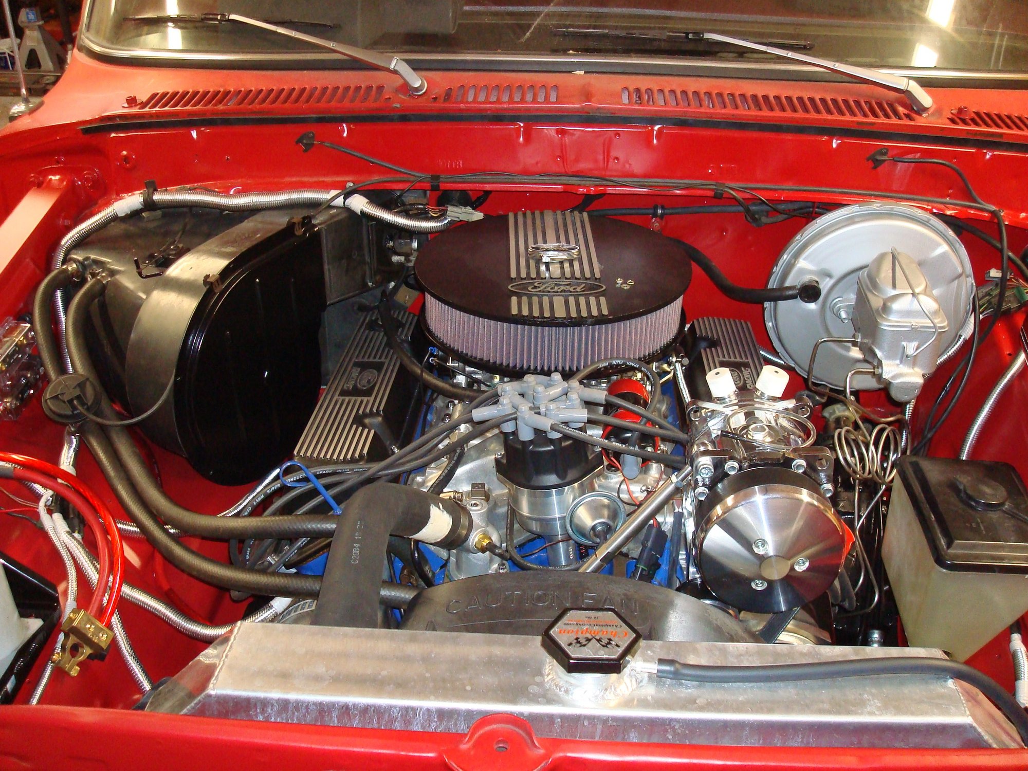

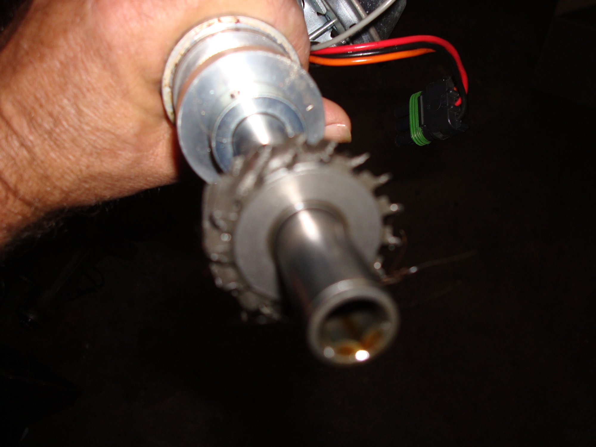

Can I remove the oil pan from a 2wd 79 F100 with out pulling the engine ? I had the engine built.They did not change the MSD distributor gear to match the comp roller cam, and within 3000 miles it disintegrated, lost oil pressure and diesel knocked a bit b4 shutting down. So much for $10,000. I want to check the bearings and clean the inside the best way possible. As you can see I really don't want to pull this 400 back out. It will be tough enough without scratching things some what.

Yea tried that, no good. The builder put blame back on MSD. it was NOT MSdD. The distributor has a pair of tags that has to be removed by the installer before it can be used that says MUST CHANGE GEAR FOR ROLLER CAM.Installer missed this, right. It's my problem now.

Ford390 I spoke with 3 different engine builders that gave me your same advise going forward.Thank you.MSD suggested a composite gear to match the Comp Cam. It's ordered. There are chunks of the five teeth that broke off laying on the distributor support. A magnet will get those. I did buy a new Melling pump to go back in. Pulling valve covers to inspect and clean the top. I use Wix filters because they are high micron. I have never tried to remove the pan in the truck. A/C box and trans bell doesn't give up very much clearance for raising the engine and the pan is very close to the saddle/cross member. So again I ask, has anyone pulled the pan out with out pulling their engine ?
