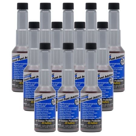

Blue label...

Blue is all season, so it includes anti-gel as part of the package. There is a red label for use at above 40 degrees. Along with the performance formula I also use their dedicated lubricity additive ( at a reduced rate ), a little insurance to help prevent a problem. So basically I am mixing my own premium fuel when I fill up by using these additives. You may not notice much, if any of a performance gain with higher cetane, but the engine should run a bit quieter and smoother because cetane rating affects the burn of the fuel. Higher cetane equates to a cleaner and more complete burn,which in turn deposits less soot into the EGR and DPF. Biodiesel fuel also adds cetane and lubricity. Just make sure you buy it from a reputable supplier. Ask them if their biodiesel meets ASTM specifications.

You can use the blue all year, however I prefer not to run anti-gel during warmer temps. So, when the weather starts to change for the better it's safe to switch to the warm weather formula. If in doubt, you can always use the blue label which is all season. Stanadyne manufactures diesel fuel systems, I feel safe running their products. Also, because Ford runs a dedicated water separator, ( primary fuel filter down near the fuel tank) the demulsifiers in the additive help separate water and help the filter do it's job. Enjoy your new truck, take good care of it and get to know your powerstroke tech at your dealer real good. Have conversations with him/her and don't be afraid to ask questions about the 6.7. And don't baby it, don't neglect it but remember the powertrain is designed to work. Let it stretch it's legs whenever possible ( as you try to avoid the law on long stretches of highway LOL). This piece of advice coming from every powerstroke tech I've met and talked to.
Sorry I rambled on, yes blue in winter, red in summer. Sheesh, sometimes I talk too much. Must be the Italian in me.

I buy the performance formula in the 16oz bottles, 12 bottles to a case. Normally around 90 dollars shipped (88.99 last order from Amazon)
8oz per 30 gallons (the 16oz bottle is marked at the 8oz level), so each bottle treats two fill-ups with the 34 gallon tank (which only takes 28 gallons at the pump), so that is 24 tanks of fuel, or $3.75 per tank.
