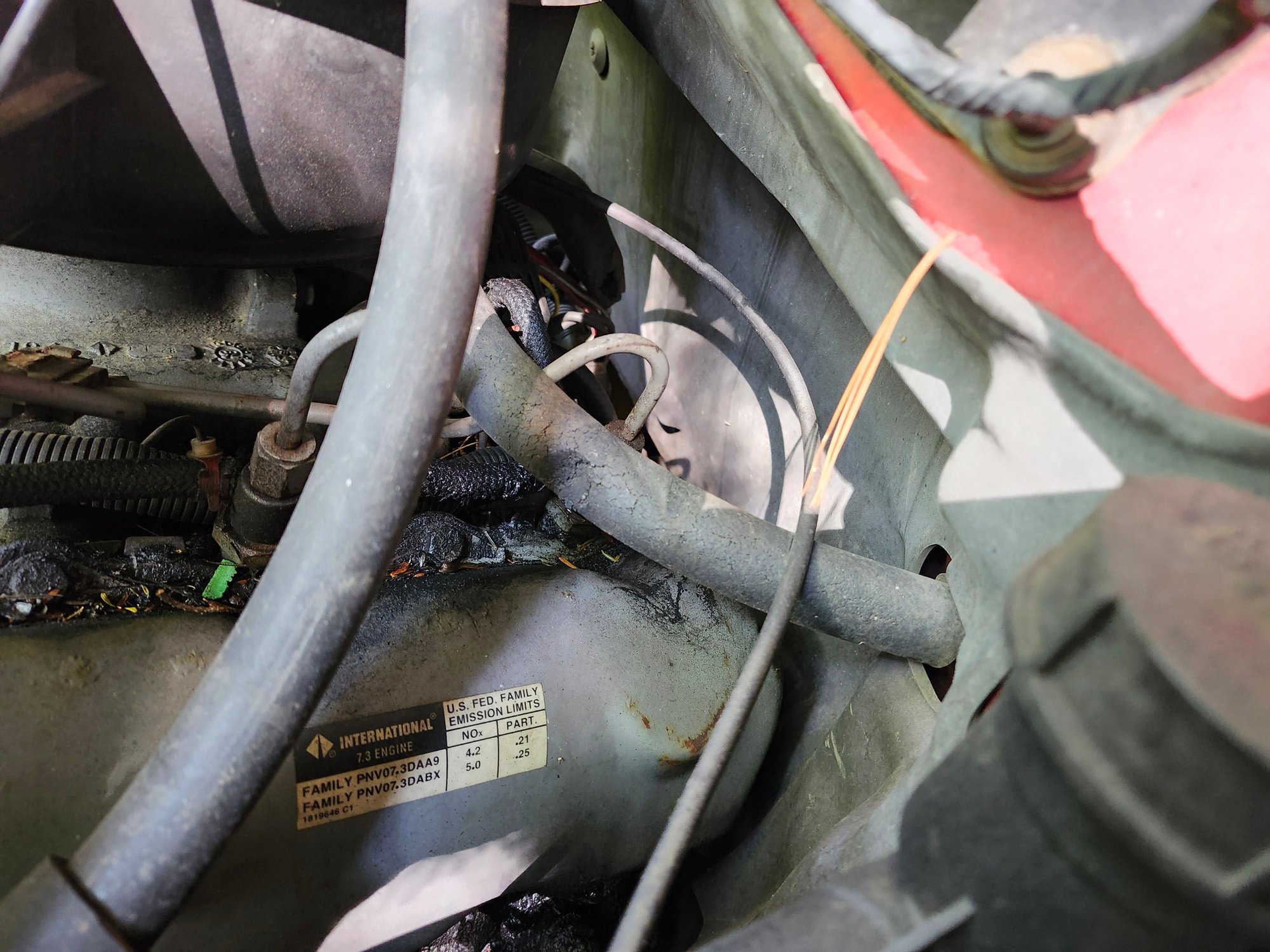

I think I found A problem or hopefully THE problem. On the first injector there is leakage, likely from a bad o-ring.
I need an injector return line kit. Does anyone know where I can get one?
