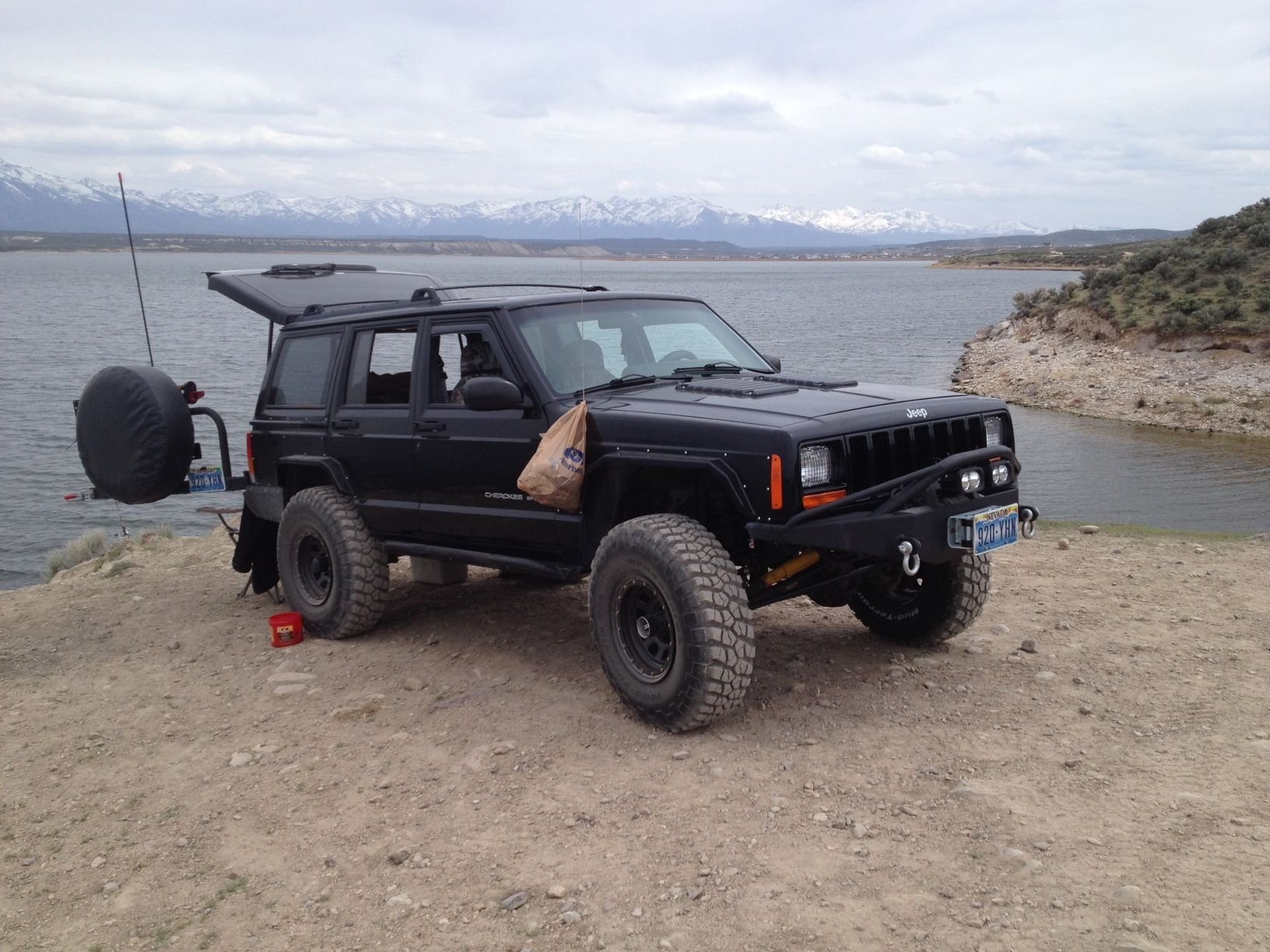

'99 XJ
No offroad pics. Everyone seems to be going your route.
4.0L I6 4-port Neon injectors Spectre cowl cold air intake New Battery New sealed TPS (throttle position sensor) Starts/runs/drives excellent. 4.56 Diffs Complete rock guards on both diffs, spring guards. These are the diffs pictured on the cover of Eric Zappe’s High-Performance Jeep Cherokee Builder's Guide 1984-2001 Yukon Axles Warn Hubs ARB Air Lockers front & rear ARB compressor (new) Professionally wired with common relay box mounted with compressor passenger side rear. Vision X offroad l

Bulletproof. I like it!
