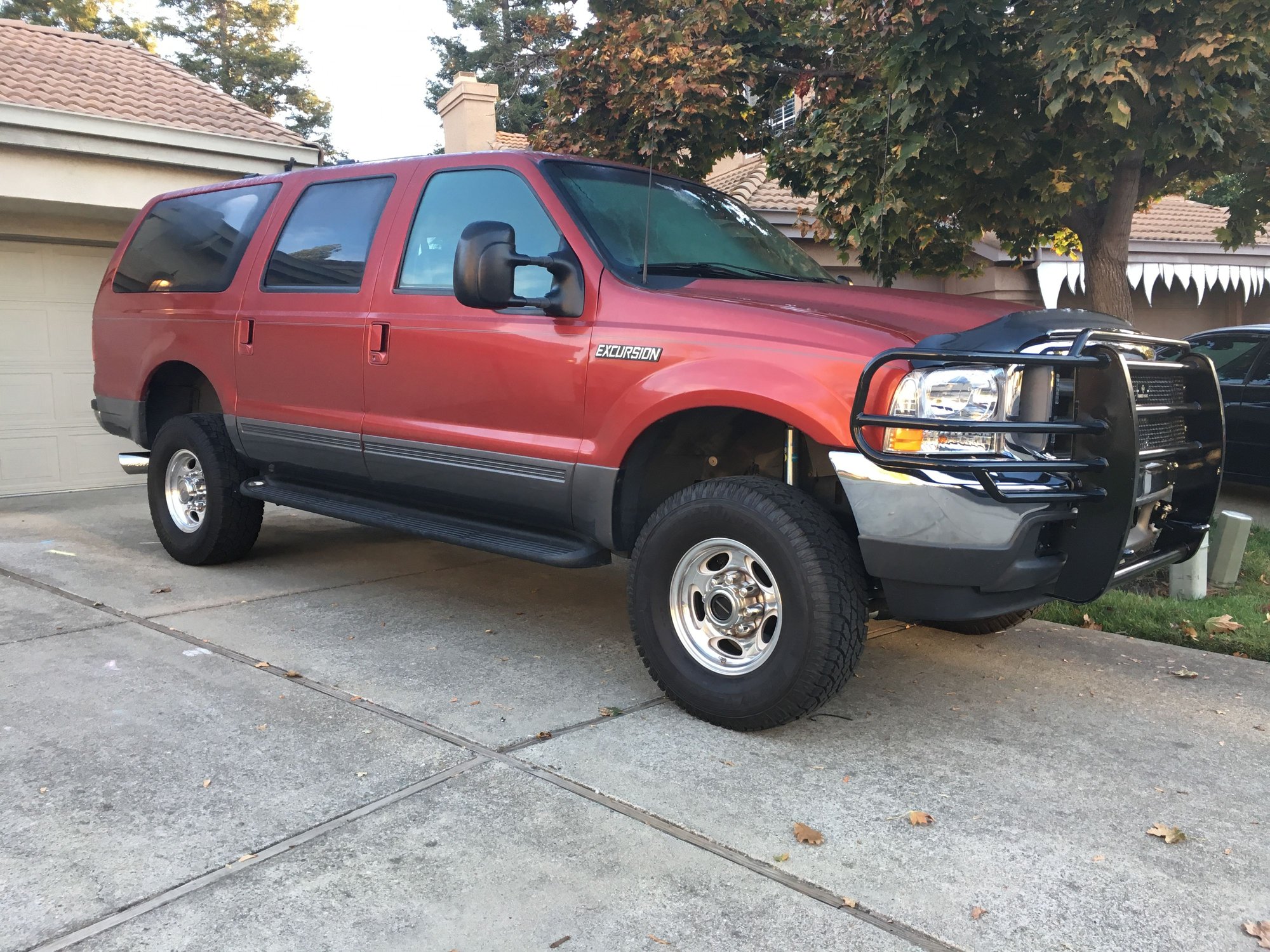

Procomp 22210/22415 will increase your ride height to 27”
one FTE member reports pulling 1 leaf from each pack and achieving 25 front 26 rear however I have not done a calculation
on the spring rates with a leaf removed, my gut says the front would be fine since the procomp is a tad stiffer (420 lbs in. ) then it needs to be, the rear however the procomp is right on the money and I think pulling a leaf would then require a airbag for any towing.
the X/Mod C setup as i have most frequently seen it puts you at 26-27 the problem with that is the front similar to the procomps is a tad to high spring rate but manageable, The rear however is ridiculous when you run it as a C or B without the mod part. Basically you are riding around on the overload spring with a spring rate of 1000 lbs in when you target spring rate should be about 380 lbs in ( Procomp 22415 is 380 lbs in. )
for the record stock your Ex had 380 lbs in. Front and 410 lbs in. Rear.
In summary, procomp 22210-22415 If you can’t live with 27” then pull a spring from the pack and add air bags to the rear.
Should be noted that by removing the block from the rear with the procomps at 27” not only does it change the ride height but the corner weights and balance of the vehicle, you don’t need sway bars or at least don’t need to add a rear one, removing g the block minimizes axle wrap so you do t need a traction bar and with the 4.5 to 5* of caster it handle much better then stock, especially towing. The ride quality , dependings on your choice of shocks of course but at least it sorts out corner weights, body roll and axle wrap.

I do not have the 22210 -22415 on my Ex currently as I have a 4 link front now so I do not have one handy that I can take measurements from at this moment. I am working with a local FTE member to measure some stuff on his so we can know exactly.
some folks have done this setup without a drop pitman and drop track bar bracket but before I recommend that I need to measure and verify the angles myself.
Also, once he gets his setup I can measure the front caster and rear pinion angles myself to verify a 2* shim in the back corrects the pinion angle to within 1/2* , again I have calculated it and people have reported it is correct but I need to verify myself before I say yes, 2* is correct.
So my answer is maybe
pretty certain you will need an adjustable track bar to center the axle.
2* shim in the rear should correct your pinion if you have a single joint on each end ( non CV ) drive shaft
2* shim should give you 5.5* of caster in the front. But it may give you as much as 6*, not the end of the world. ( once I can Measure one I am going to have WFO make the exact shim and they will carry it )
go ahead and do it without a drop pitman arm or drop track bar but be prepared to add this if needed.
check amazon for prices on the springs, usually available for under $150 each with free freight
