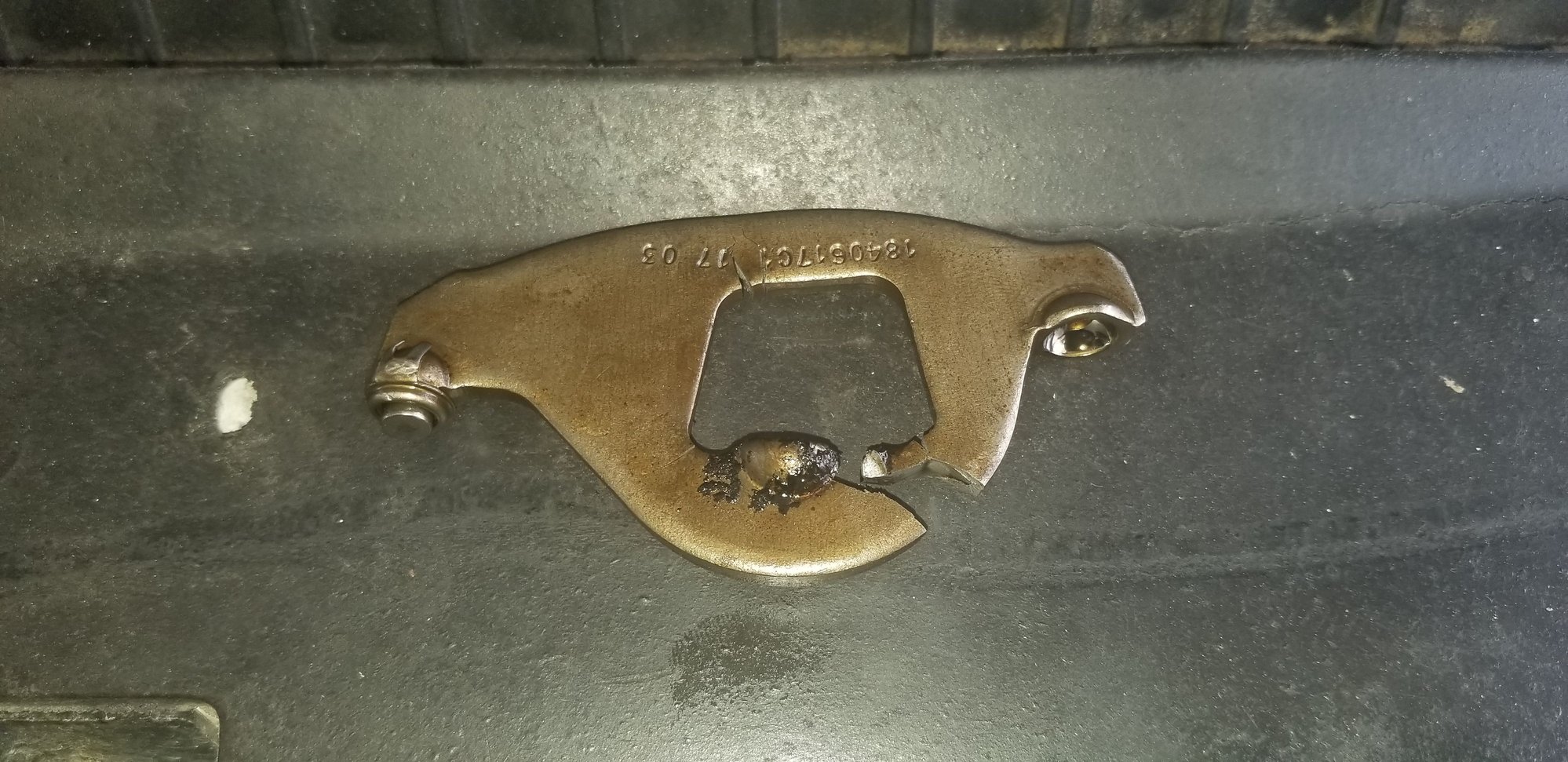

Was in changing some injectors in my 03 and found this next to injector 5. what can cause this to happen? can these just wear out or did something more serious cause this? I checked the push rod and its straight as an arrow.

Fatigue crack from inherent stress at the time of stamping.
Cylinder hydrolocked from over fueling and valve could not open.
Valve hitting piston from something inside the cylinder, or between the seat and valve not allowing the valve to fully close (see next one).
Lifter pump up beyond normal travel (that usually happens if the valve hangs up from carbon or stem rust) and valve hits the piston.
Someone will bring up too long pushrods, but we would have a high degree of failure or burnt valves in the community if that was true.

That's my list.
If you have stock pushrods and not HD ones, I would lean more to just a failed rocker arm. High loads should bend the pushrod. I read a few people putting in a new rocker and done with the problem.
The absolute safest thing is to pull the head and see what's up.
But if that was my truck, I'd buy an under $50 borescope small diameter camera that can be hooked to a smartphone, pull the injector for that cylinder and look at the top of the piston to see if there is any damage to the piston or an object in the cylinder. Had the intake off at all?
If still worried, I'd pull the intake and check the valve with the borescope. Or not.
If it looks good in the cylinder, install a rocker and hand crack the motor two revolutions. Still good, power crank the motor with the starter jumper. If still good start it up.
Others with more damage control on the 6.0 may have a better plan.

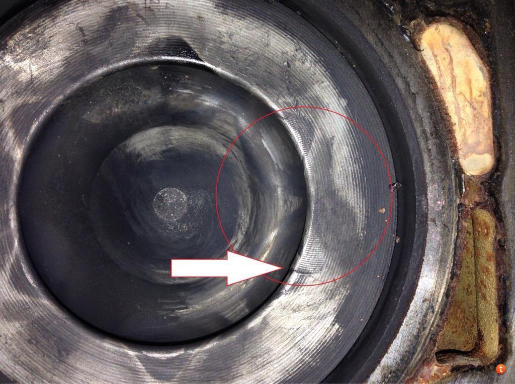

It depends on how hard they hit. And then it's a judgment call on where you feel comfortable. Piston to valve contact has the potential to bend the valve tulips. You would see that first as a lower compression on that cylinder. Sometimes as valves get hot they will straighten back out, but no usual in my experience. But if they do there is the risk later on that the tulip will separate from the stem. Stems are typically friction welded onto the tulip. That's catastrophic with no saving the block or head typically.
On the piston side, it can just leave marks, sometimes the edge of the piston deforms at the edges and the piston to wall clearance is gone, also sometimes with the top ring captured. Another situation is there can be a stress crack in the piston that will later cause it to fracture.
But some have light marks and never have issues. Its a tough call without see it.

UPDATE: I was got the old injector out of cylinder 5 and looked with my bore scope camera in the cylinder the piston was spotless not a mark on it and very clean no carbon. Almost makes me and my dad believe this motor may have been rebuilt at some point before I bought the truck it definitely doesn't look like the motor has 250,000 miles. So with that said I guess I'm good to just replace the rocker arm?
