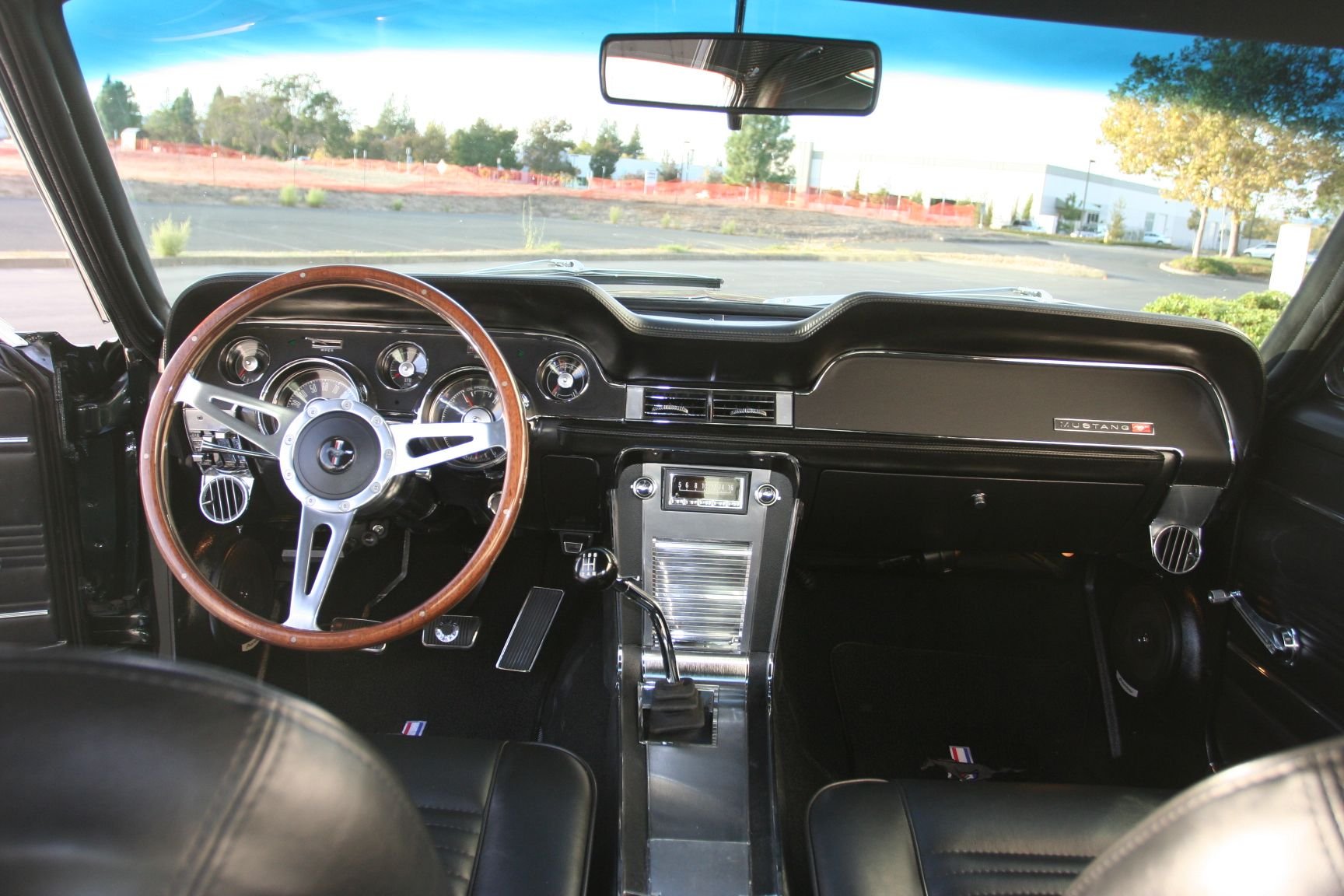

We put an Ignitor 3 is my son's 67 Mustang 289 and we installed a small tach made by Retro Gauge that fits in the clock hole and it works fine.
ok thank you. Sweet car
