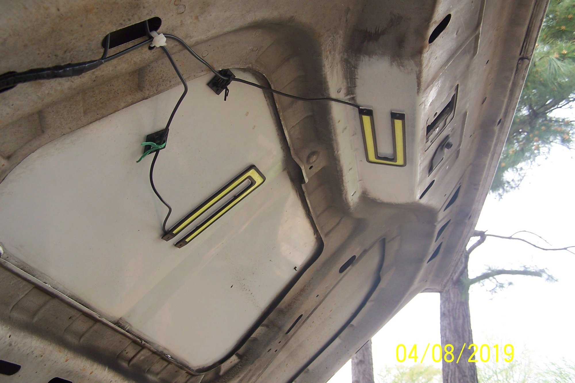

I just got some of those stick on daytime running lights (LED) and stuck them under the hood in two spots. They are water proof, have great 3m double sided tape and should outlast me. It is like daylight under the hood when they are plugged in. put a 12 volt power receptacle attached to the battery and on the light end a male 12 volt plug. 10 bux total.

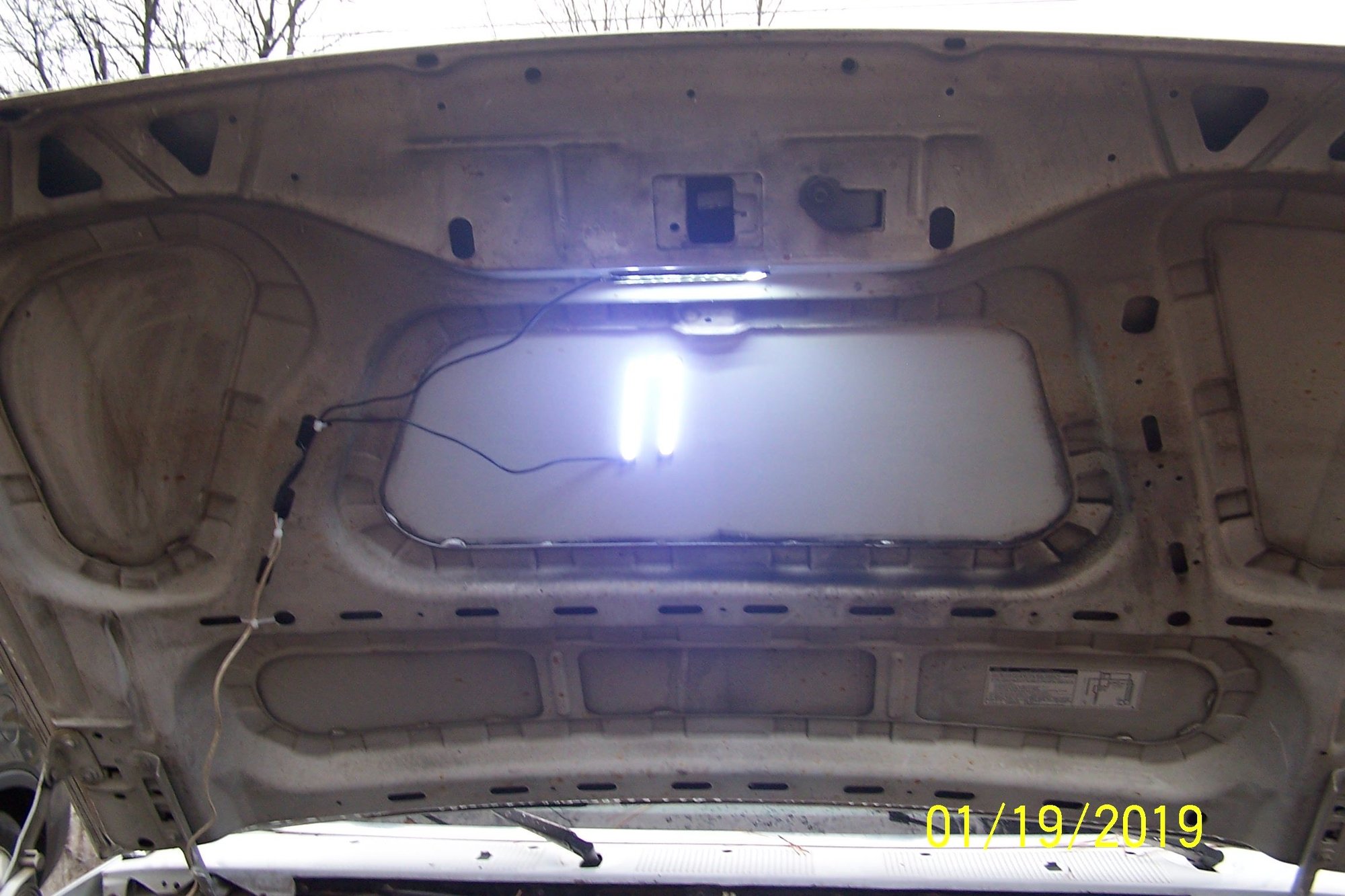

Nice install! I've got an LED panel with a clip on the back and a stretchy phone cord in place of the stock light on ours, but it doesn't reach the wheels. Still really nice to have. Looks like yours has a magnet on the back?
I did up my daily similar to Zombie's DRL setup, except I used self-stick LED strips. One strip across the underside of the hood and one on each fender wall, under the flange where the fenders bolt on. It really does make the truck nicer to work on.

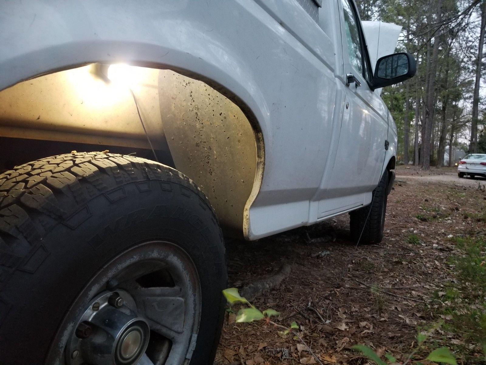

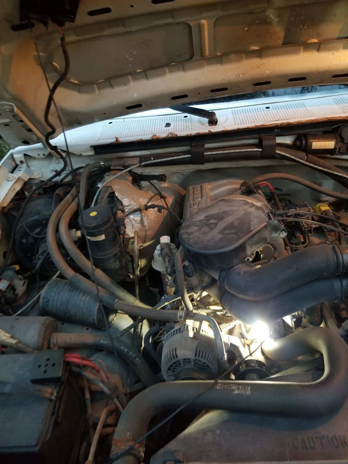

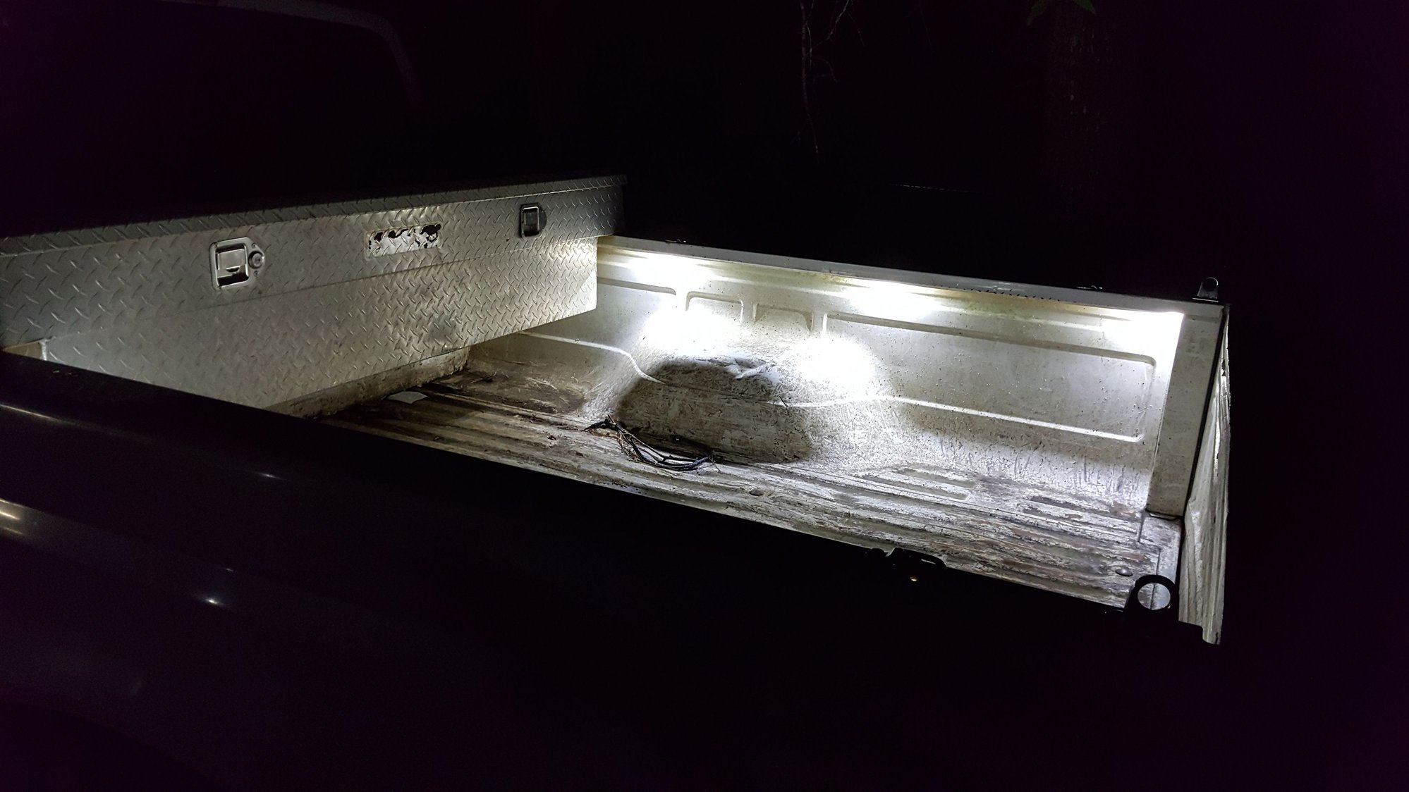

I had an LED leftover from my bed lights...
That I had wired to a magnetic switch, but I wasn't really happy with it (although it did work). The stock light (at least this one) uses a mercury switch... not terribly bright, but I figure I'll leave it since the new light has an on/off switch.
LED bed lights on
Factory and LED underhood lights.

Where you have your LED light is where I put one of my stick on DRL's the other is in the large section about middle of the hood then I ran the wiring to the left all the way back towards the hinge and hen along the fender towards the battery where it plugs in.
With the one LED facing the way yours is it aims the light towards the back of the engine bay and the other in the center of the hood facing the front of the truck the whole engine bay is flooded with super bright light.
