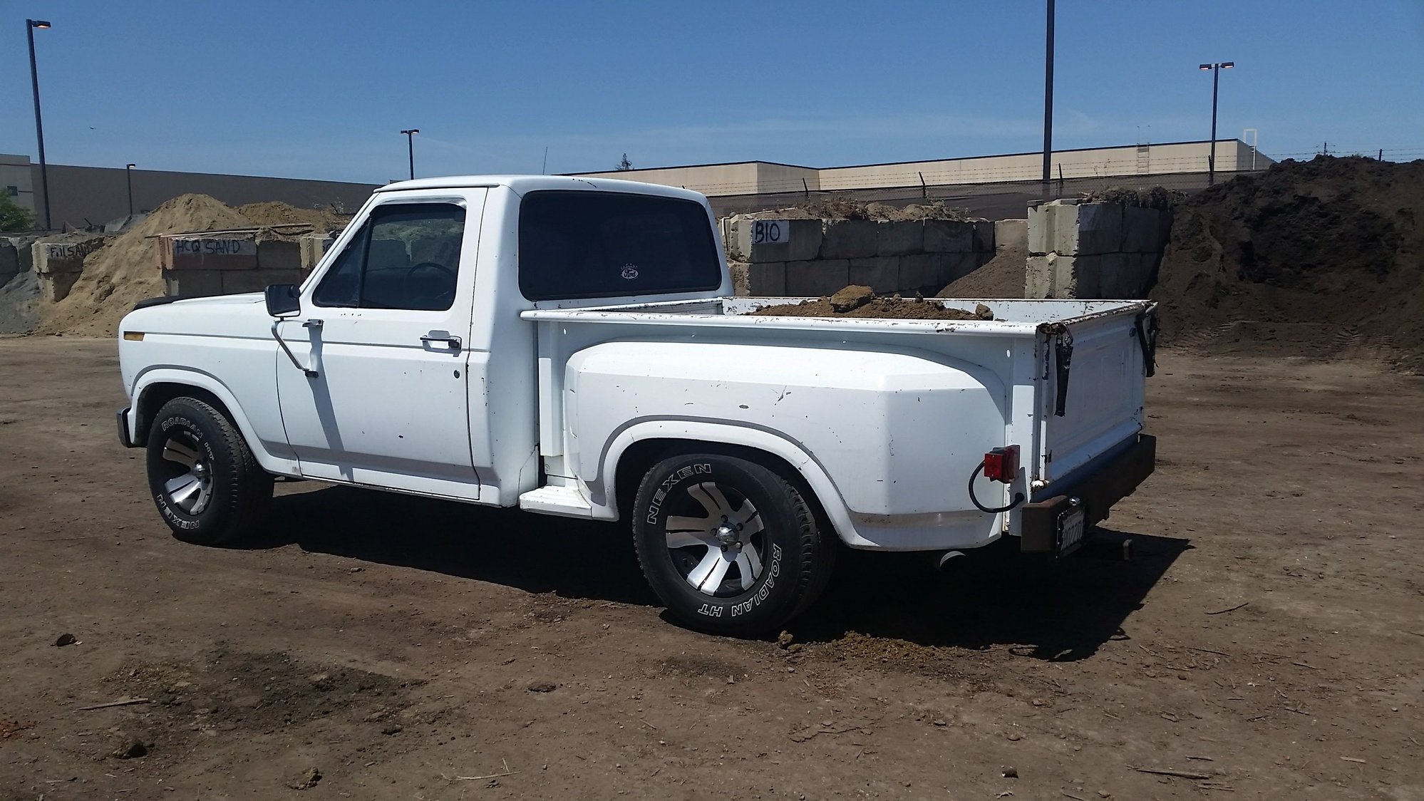

I'm in the process of replacing the bed slats on my 82 F100, Leroy. I decided that once the bed is done, he's never gonna have to "work" again.
Powertrain: l6/300 in front of a C6. I know he's got a 9" rear end but I need help ciphering the tag.
I'm running P265/70/R15's. He's always been a slow mover and maxes out at around 75mph. (Always auto-dropping back into 2nd at the slightest of freeway incline) I'm pretty sure that I'll be putting on a Clifford 6=8 2x2bbl kit this summer and want some kind of change in the differential for highway as well as backroad and mountain cruising. I seriously doubt that he's ever going to tow anything more than a motorcycle. In addition, I'm wondering about a disc brake conversion but would like to keep the 5x4.5 bolt pattern so I don't have to buy a new set of wheels. Reckon I'm looking at a full axle swap?
I'm asking for input on my axle tag, best all-around change in gear ratio, and a possible recommendation on a direct swap to include gearing/disc brakes.
I'll save the 4X4 conversion for another post.
Thanks in advance.

Need a better pic of the tag can not tell if it is 2.75 or 3.75. ratio I suspect it is 2.75

I couldn't find a picture of my tag. His looks about like mine. '82 F100 Flareside. When I looked up my axle code it came back as a 2.75 ratio. Got the same setup, 300 6 in front of a C6. I want to say the high gear ratios were in larger trucks/different applications that year. But been too long since I was looking all that up.

Thanks, guys. I'm gonna have to go back one more time and clean up that axle tag. In the meantime, say the 4X4 conversion is just a dream that will probably never come to fruition,
Is the another Ford anything with discs that will direct swap to my truck? I'm thinking 2.75 ratio is what I was told at some time in the past, so any input on a ratio that would me move along a bit
faster would be appreciated. Maybe the Clifford upgrade alone will solve my slow and steady issue?
I'll try and update the tag info tomorrow, truck is offsite at the ex gf's place.

WDM-CL = Ford 9" Rear Axle / 2.75-1 / No Limited Slip / Rear axle parts list #88 = EOTZ-4234-K (replaced EOTZ-4234-H) .. 31 Spline Axle Shafts.
2F29 = Assembled June (F) 29, 1982 (2).
No F100 4WD's after 1976.
