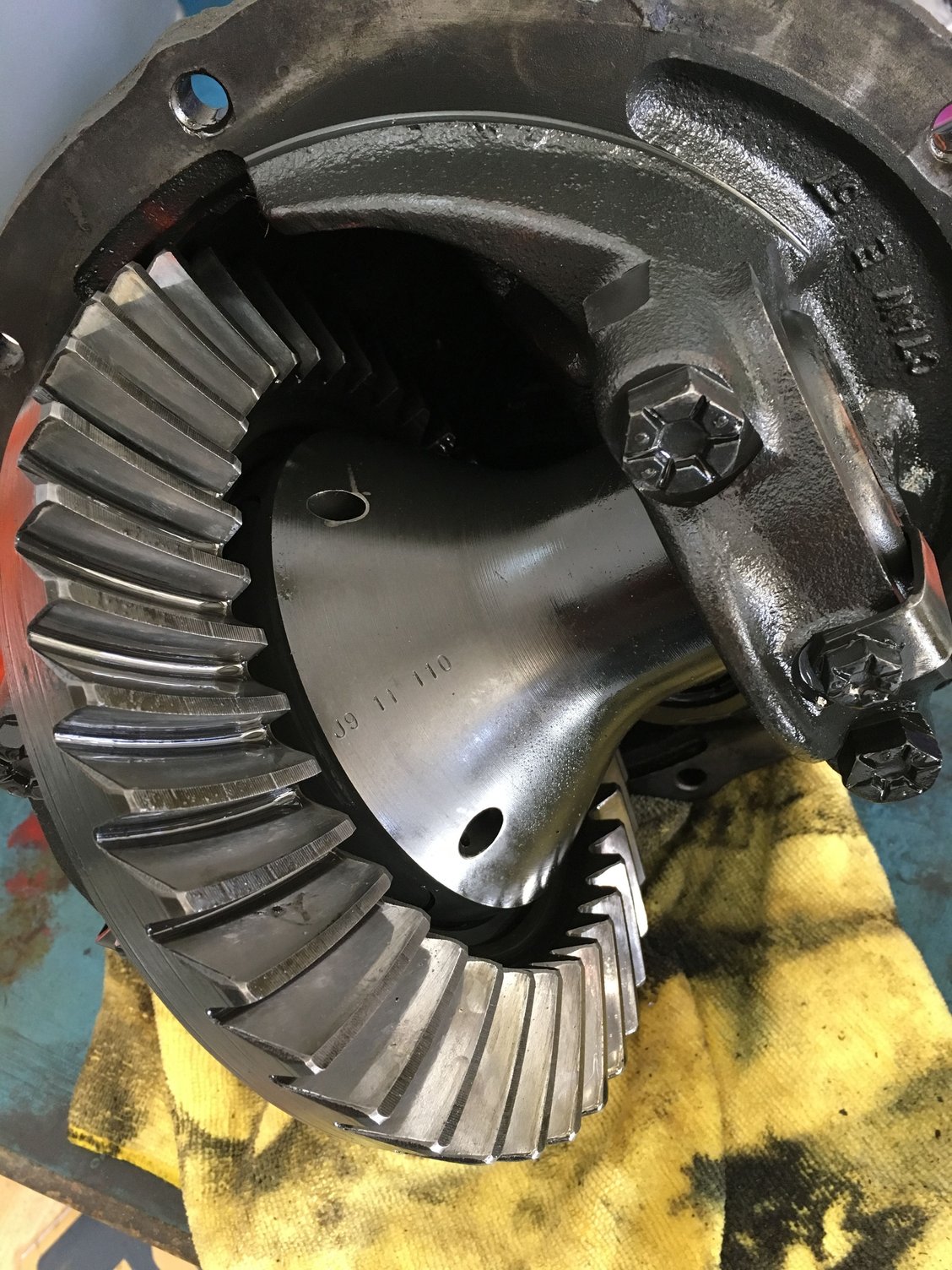

The brake backing plate is hung up on an 'O' ring on the axle seal. I disconnected the brake line, and was able to remove the pumpkin. The new differential is 3.70:1, with a True-trac posi. The old differential is a 3.25:1 with a posi, but it looks different than the True-trac. It has these numbers: J9 11 110. Does anyone have any idea about what kind of posi this is?

Are you sure the O ring was on the seal, and not on the bearing itself? I have seen this on some new bearings, which allows you to eliminate the old press-in style seals. Or you can use both to have additional sealing.
If your old differential was stock, then it probably had Ford's Traction-Lock (not Posi, which is a GM trade name) differential, which uses clutch plates with a preload spring.

This is the old unit. I think that it's a Trac-Loc type. It's not OEM. It was installed many years ago. I'll check to see if the 'O' ring is on the bearing.

The 'O' ring is on the bearing. I should have removed it before trying to pull the axle through the backing plate. The old unit is a Detroit Locker, and the new unit is a Tru-trac.
There were some copper washers behind the nuts that hold the carrier to the housing. Can I reuse those?
The old R&P seems to have less backlash, than the new R&P. I set the backlash on the new R&P with a dial indicator to the spec that I have. Maybe due to the new R&P being dry, while the old R&P has oil on it.

That didn't look like a Ford T-L to me.
You need to get new copper washers; the old ones deform to seal around the studs when you torque down the nuts. You could try high-temp Permatex sealant, but the recommendation is to use copper washers.
