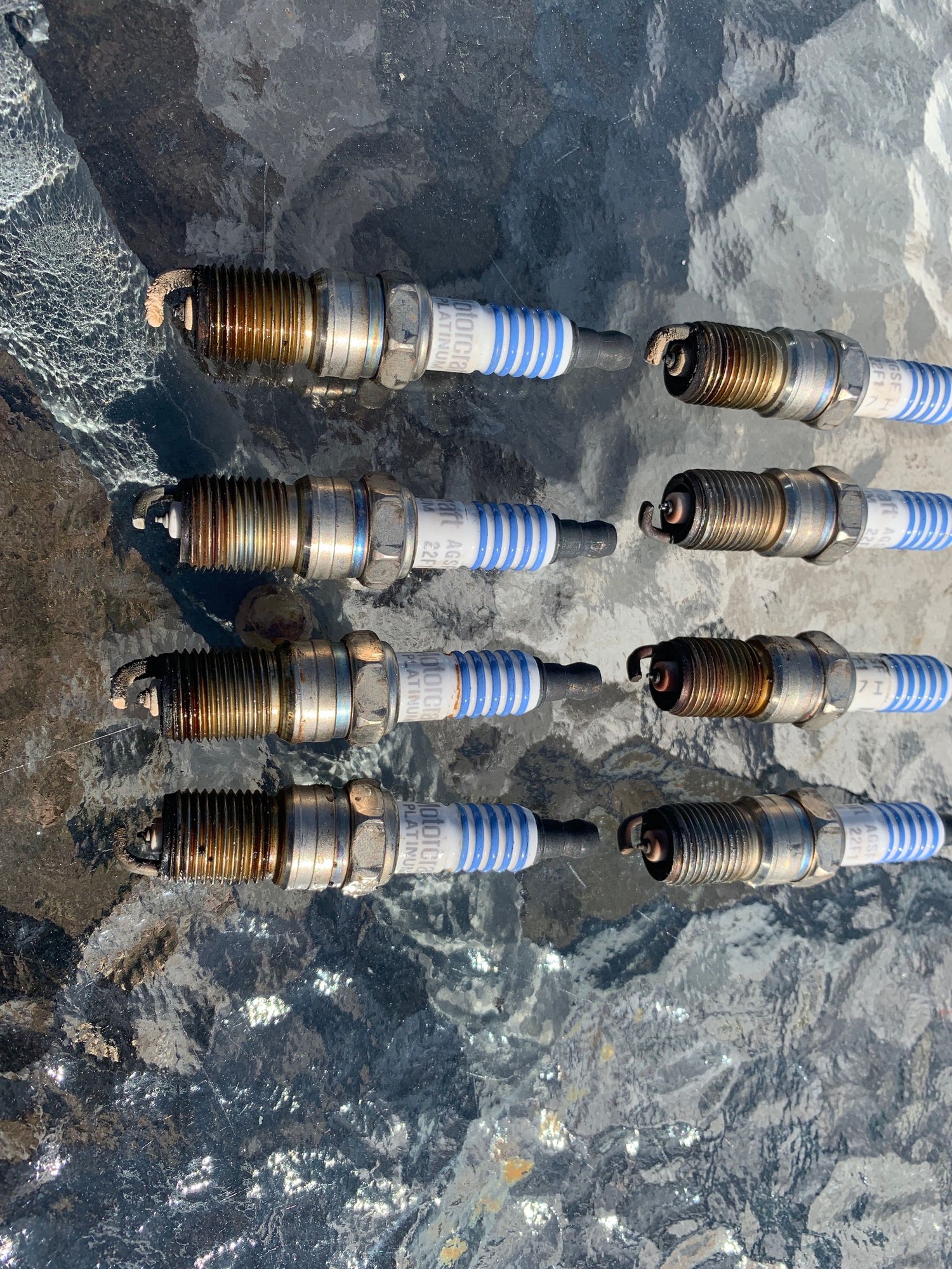

So I did go through and run a compression test on all eight cylinders today and was a bit surprised on what I found. I only completed a dry test.
#1 - 195 psi
#2 - 190 psi
#3 - 190 psi
#4 - 210 psi
#5 - 95 psi
#6 - 185 psi
#7 - 185 psi
#8 - 190 psi
The first thing that got me was the high compression numbers. The test sheet I have on the engine shows it left the facility with each cylinder averaging 175 psi before being installed. What would cause an increase in pressure such as this? Carbon build up? I did look into the cylinders that I could see and the piston was black as could be. Not something I would expect at 9k miles.
Obviously the low compression on #5 is a concern so I performed a leak down test on it. Sure enough it was at about 60%. After listening I found the air was leaking on the exhaust valve. Do I really have a burnt valve after 9k miles? Also I used a long screwdriver on #5 to find TDC and after pulling the screwdriver out I there was black sludge about 1/16" up the screwdriver tip.
And finally, I pulled all the plugs and they look like they was been run 100k mikes. A good amount of build up on several of them. I have attached a pic. Bottom left is #1 and bottom right is #5
Can anyone help me make sense of all this? Does the head really need to be pulled? What is causing the increase in cylinder pressure? Can carbon build up be causing the exhaust valve to not close all the way = low compression? Why so much build up on the plugs? Why so build up on the piston at only 9k miles?
Any help would be greatly appreciated!

Have you paid attention to fuel trims both long and short term? How many miles are on the injectors? Me personally I'm not prone to believe DC resistance on an electronic part is useful determining its performance in use. Is the carbon build up you observe perhaps oil sludge from a leaking ring? To my eye the plugs look to be oil fouled but I'm NOT an expert by any means, Here's something I found useful: Reading Spark PlugsI
I'd complete the wet test just for giggles and grins---most likely if any warranty is to apply they'll want those numbers too.

No I did not look at the trim numbers. Once I get everything back together I will take a look just to see what I see. But I did stick a scope down each of the cylinder and you are correct. That is oil sludge and a ton of it. It is in almost every cylinder. So without pulling the heads, which isn't easy in an E-250, I'm concluding the heads were not rebuilt properly and the valve guides or seals have been leaking. Whoever rebuilt the heads was fighting a bad hangover or something.
This was not a Motorcraft rebuild. I just could not see paying their $7500 plus install the dealership was wanting to swap in a new reman. So I picked up an S&J Engine with the extended warranty which was about half that and had it installed and an independent shop. I just didn't have time to do it myself. I talked to S&J yesterday and they are sending new heads to the shop that installed the engine. I'm going to have them pull the engine and swap the heads. I'm going to make sure I'm there when we pull these heads. S&J advised they will be covering all the labor. We shall see. I don't have much faith in many of these rebuilders.
