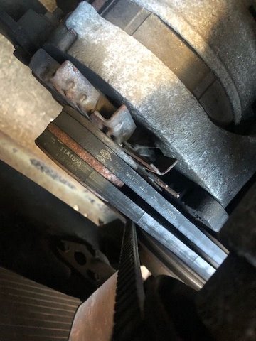

Shot from the drivers side
the truck doesn't have A/C...is this an A/C compressor?
shot from above from the passengers side
From the alternator, under the myster compressor
looking at the fan from the drivers side

likely emissions air injection pump

That's a smog pump.

That probably makes sense...it looks like an A/C compressor but this truck has NEVER had A/C, so it was a bit confusing.
