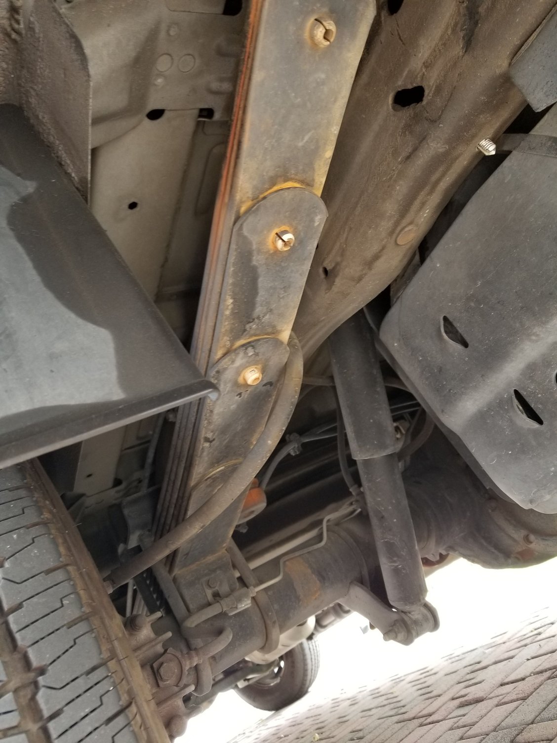

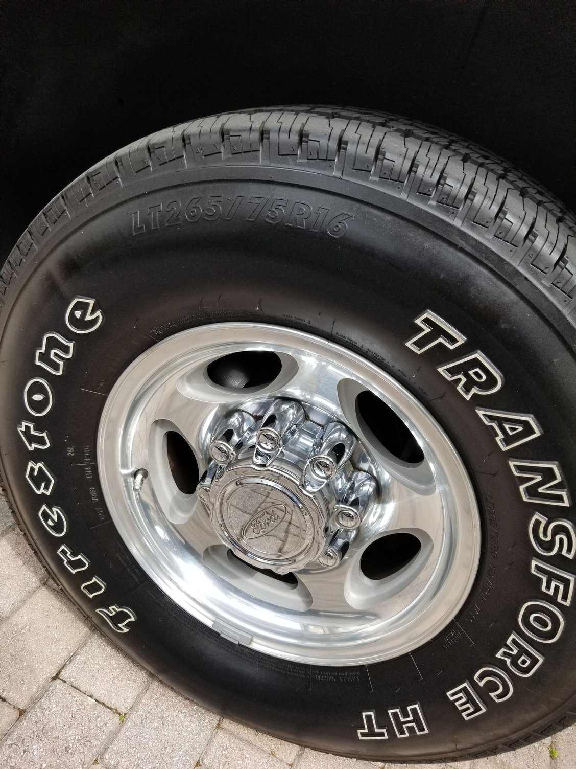

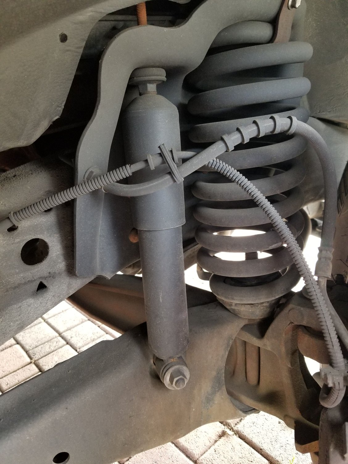

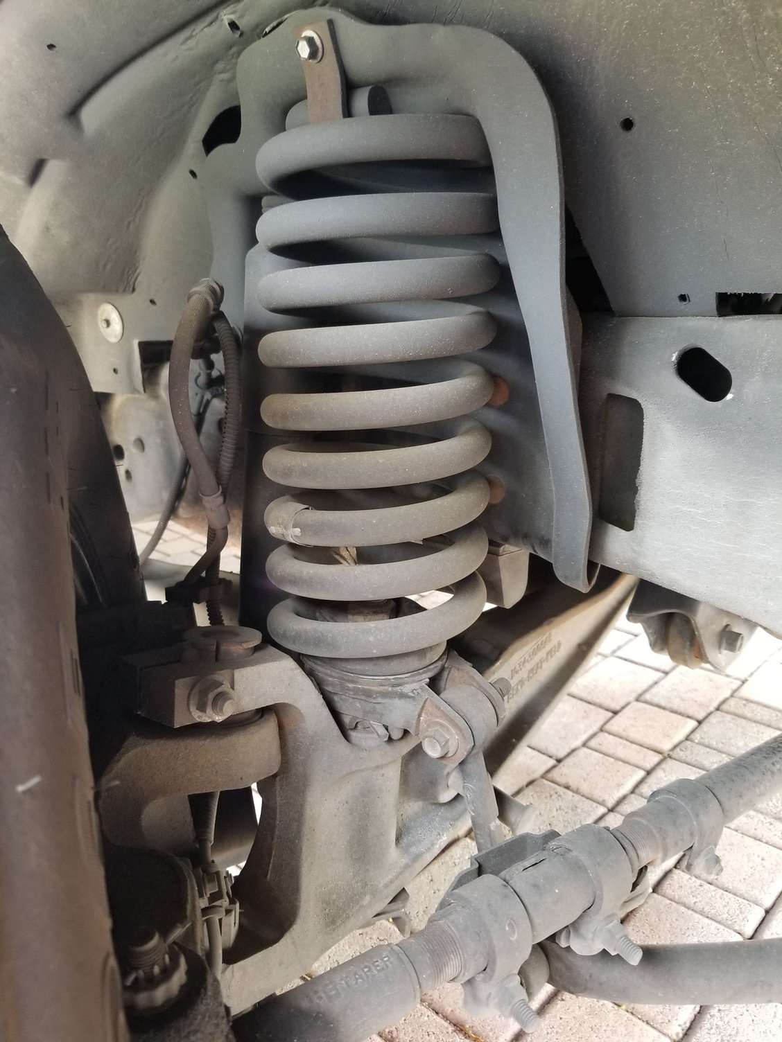

ok, so from center of hub to top of well is about 22" on all 4 tires. here are some pics of what was asked

^^^...Nice clean looking Excursion! How many miles on the clock? Those shocks look like the factory units and probably time to replace...

I would start with replacing the shocks then...

I use the yellow Monroes on my F350, but it's a front spring leaf 4x4...painted a different color of course. I utilize a silver Monroe Reflex variable rate shock on the wife's 2wd Excursion. I think the last set were Gabriel and I liked them because to me they had a firmer stance. The Monroe units have more bounce to them, but the wife likes that and she drives it most of the time. I think these would work well with the stock size 265/75/R16 load range E tires, but I went with a set of the 285/75/R16 load E range tires this last time to help the ride for her. The only reason I had to replace the Gabriel units was because the back passenger shock was ruined because the lower axle shock mount was compromised...why Ford mounted the rear shocks in this manner is beyond me.
